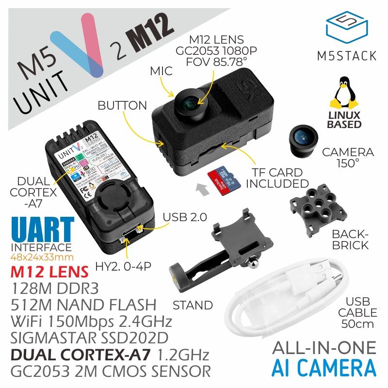

M5Stack UnitV2 M12 Version with Cameras
M5Stack has been on the market for a long time designing edge computing and IoT devices. The manufacturer is expanding a range of high-efficiency AI recognition modules to UnitV2. Recently, M5Stack has released the UnitV2 M12 version with a camera that features the Sigmastar SSD202D control core. Specially designed for AI recognition functions, industrial visual recognition classification, and machine vision learning, this hardware comes with a GC2145 1080P colored camera sensor.
At the heart of the module is the SSD202D SoC that features a dual-core cortex-A7 processor running at a clock frequency of 1.2 GHz. It comes with integrated 128MB-DDR3 memory and 512MB NAND flashes with microSD expansion. The key difference between all the existing UnitV2 modules and the M21 version lies in the lens equipment of normal focal length (FOV 85°) and wide-angle focal length (FOV: 150°).
Specifications of M5Stack UnitV2 M21 Version
  • SoC: Sigmastar SSD202D has a dual-core cortex A-7 processor
  • Memory: 128MB-DDR3
  • Storage: 512MB NAND flash
  • Wireless Connectivity: 150 Mbps 2.4GHz IEEE 802.11 b/g/n
  • Camera sensor: 150 Mbps 2.4GHz IEEE 802.11 b/g/n
  • Lens: regular focal length and wide-angle fisheye lens
  • Input power: 5V at 500 mA
  • Peripherals: USB Type-C, UART, TFCard, Button, Microphone, Built-in active cooling fan
