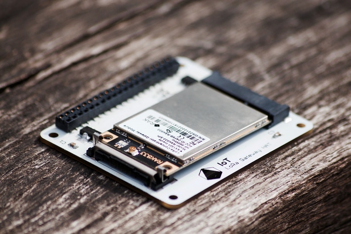

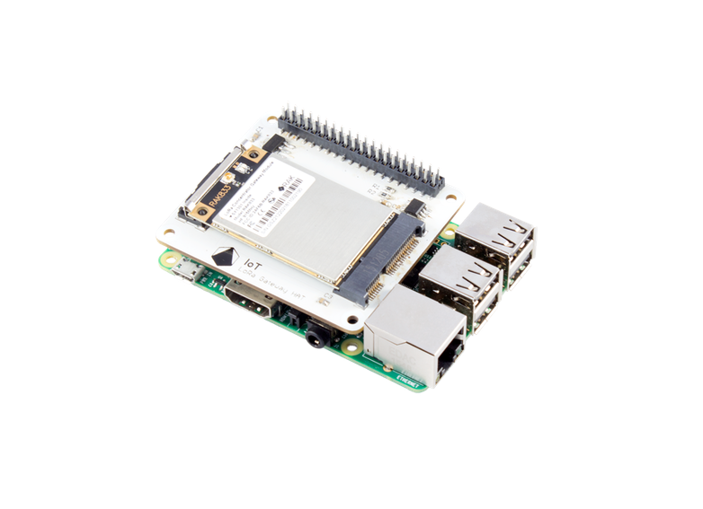

IoT LoRa Gateway HAT
The IoT LoRa Gateway HAT is modelled around the RAKWireless RAK833 mini-PCIe module. The LoRa gateway concentrator is controlled by a Semtech SX1301 LoRa baseband chip, which is also used on Arduino’s LoRa Gateway Kit shield. The RAK833 module allows the IoT LoRa Gateway HAT to listen on 8x channels simultaneously. The board offers relatively low power consumption, it will use about 500mA from the Raspberry Pi’s 5V Rail.
The board is also hailed for its fast setup, which does not need soldering or a software compile. The LoRa Node pHAT and micro:bit LoRa Node boards both run on the RAKWireless RAK811 LoRa radio module “with full LoRaWAN Stack embedded.” The LoRa Node pHAT, which takes on the Raspberry Pi Zero sized pHAT (partial HAT) form factor, communicates with the Raspberry Pi over UART using only 3x GPIO pins.
The Pi and Micro:bit compatible nodes deliver 8x pins that can be controlled via UART, including two for analogue sensors. A u.FL connector and onboard antenna are also available. Both node boards consume less than 50mA maximum during transmission and runs at 30mA at 3.3V peak during operation and less than 1mA during sleep.
