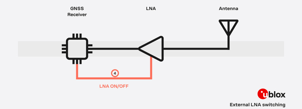

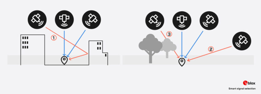

The most interesting feature of the devices is LEAP (Low Energy Accurate Positioning), introduced in the SPG 5.30 firmware, is a new power-saving mode for u-blox M10 modules. It prioritizes strong, direct line-of-sight satellite signals while ignoring weak or reflected ones, improving accuracy and cutting power use. LEAP also switches the external LNA on only when needed and preloads satellite data from the internet to avoid long GNSS downloads. Overall, it reduces energy consumption by up to 50% while maintaining high positioning accuracy, making it ideal for battery-powered wearables and trackers.
LEAP External LNA Switching. Image used courtesy of u-blox
LEAP Smart Signal Selection. Image used courtesy of u-blox

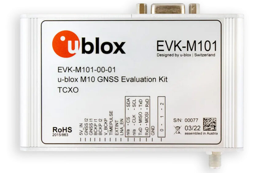

EVK-M10 evaluation kit. Image used courtesy of u-blox
u-blox also offers the EVK-M10 evaluation kit for quick testing of M10-series GNSS modules. It provides USB, UART, SPI, and I²C interfaces, supports USB or 5V external power, and includes an active GNSS antenna and USB-C cable. Developers can use it with the u-center 2 software for configuration, logging, and power analysis.
