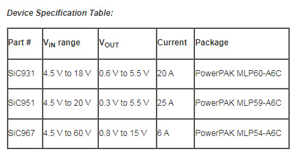

Features & Benefits:
- Versatile
- Operation from:
SiC931 – 4.5V to 18V input voltage
SiC951 – 4.5V to 20V input voltage
SiC967 – 4.5V to 60V input voltage - Adjustable output voltage:
SiC931 – down to 0.6V
SiC951 – Output current: 25A continuous with 30A peak
SiC967 – down to 0.8V - Operating temperature range: -40°C to +125°C
