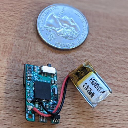

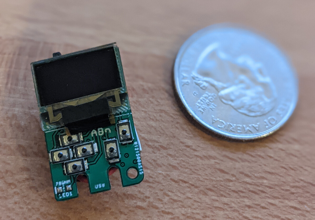

A far more compact version of the Arduboy console is Arduboy Nano which is smaller than an inch tall. It is 26mm tall and features a 0.49″ OLED display with 64×32 pixels. The console is built around the same microcontroller that the original Arduboy used which is ATmega23u4. It is a low-power 8-bit AVR microcontroller. It is also featured in Arduino Pro Micro. The OLED unlike the original Arduboy uses the i2c protocol and fewer pixels. The 0.49 inch OLED display consumes very little power as no backlight is required. As this OLED display makes its light on its own, it has high contrast and wide viewing angle despite consuming less amount of power. All of the pinouts remain the same as the original one and all of the existing games are code compatible. In a nutshell, it has all the features of the original Arduboy but it has just shrunk.
Source: https://community.arduboy.com/t/introducing-arduboy-nano/9575
It also has a small 15mm piezo speaker which is very quiet and all of this is powered by a 25mAh Li-Po battery. The game consumes somewhat less than 25mA and so the battery lasts around 1 hour.
The case consists of 3 pieces of sliding enclosure which are 3D printed. The buttons were also painstakingly printed at 2mm/s to retain their delicate shape while printing.
