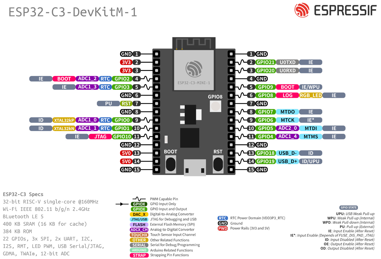

The board features an onboard addressable RGB LED (WS2812), driven by GPIO8 which can be configured to glow in different colors based on the RGB value of the color given. ESP-IDF being the native software development framework for ESP boards with all API, Toolchain scripts are preinstalled. In this article, we focus on the programming of ESP32-C3 using ESP-IDF.

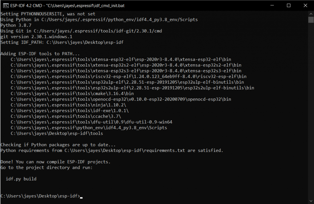

Step1: Launch your ESP-IDF CMD Application.
Launching ESP-IDF Application

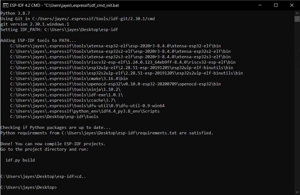

Step2: By default, you will be in the esp-idf home directory, change the directory by using cd.. command.
Changing the directory

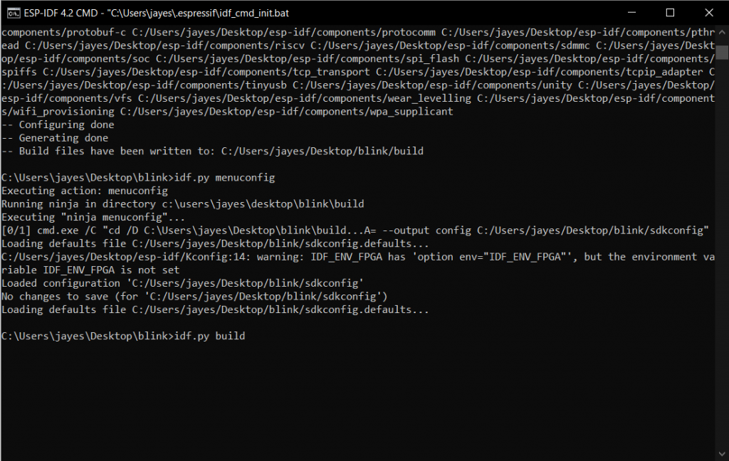

Step5: Execute idf.py set-target and idf.py menuconfig commands to make the program compatible with the board you have.
Building the program for ESP32-C3-DevKITM-1

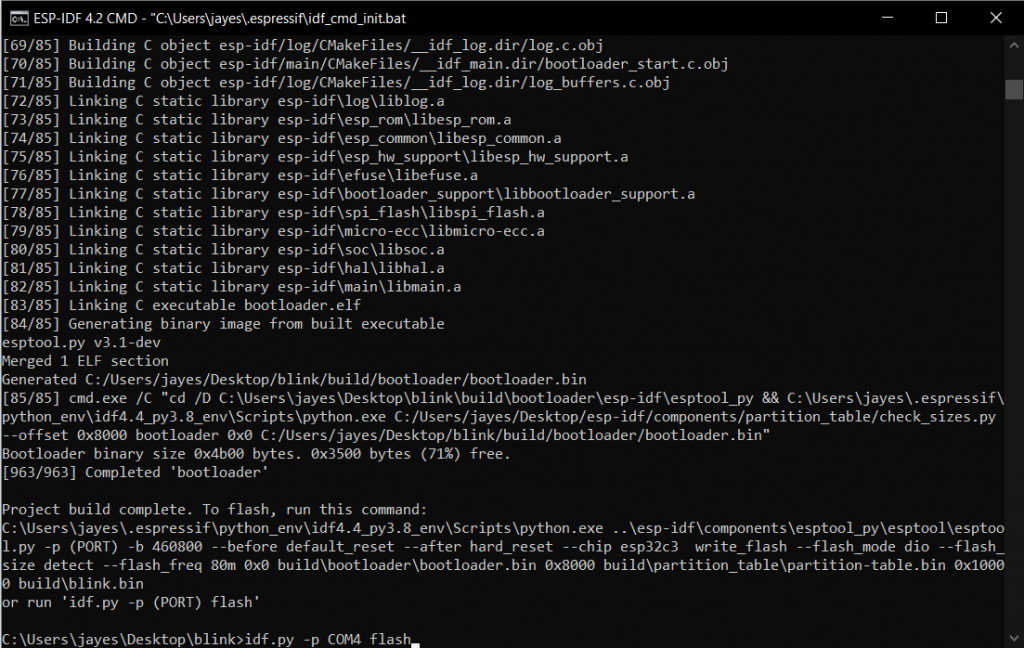

Step6: Now build the program using the idf.py build command.
Step7: Connect your esp board now and flash the program using idf.py -p (PORT) flash. Here (PORT) is the Port at which your board is connected. This can be found using the device manager on your PC.
Porting and Flashing the code
Once the flashing is complete, you’ll get a Done message as shown below.
Now, your Onboard LED of the ESP32 C3 board should start blinking white. The Idf.py monitor command gives the real-time status of the LED from the board.

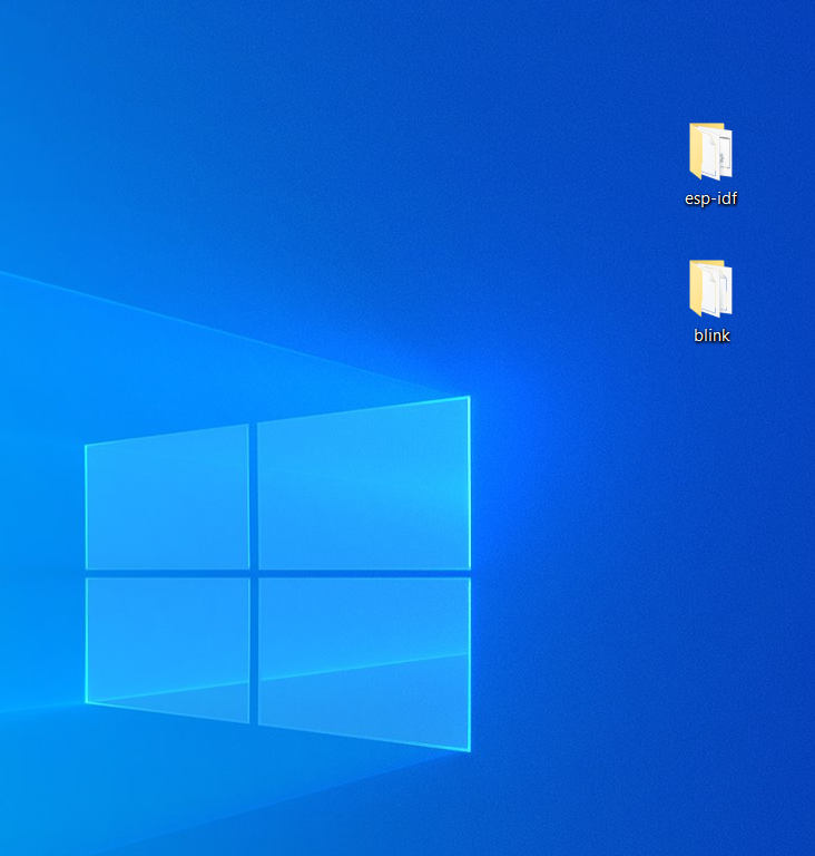

Step4: Now, navigate to the newly created blink folder in file explorer. Here, in our case, the new blink folder was made on the Desktop.
Desktop folders for LED Use Cases

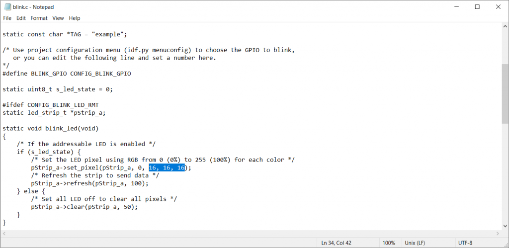

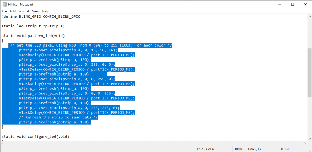

Step5: Open blink -> main -> blink.c file in any suitable application as per your preference. Here, we used the Notepad application to open and edit the blink.c file.
editing the blank c file
As instructed from the given comments, the highlighted values in the above figure are the RGB values of the glowing LED. Set these values as required, to obtain your desired color as the output. We set these values to 255, 0, 255 to obtain Magenta Colour. Save the file.
Step6: Come back now to your ESP-IDF CMD Application and execute step4 to step7 of the previous single blink example. Now, your Onboard LED of the ESP32 C3 board should start blinking magenta and can be monitored by the Idf.py monitor command.
The same logic was followed in order to write a program to make the onboard LED glow in a color pattern.
Code LED pattern

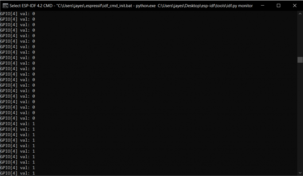

Status Values of Switch
As and when the input on pin 4 of the ESP32-C3-DevKitM-1 board becomes high (1), the LED color pattern example is executed, and else i.e. on low input (0), the Single blink example is executed.
