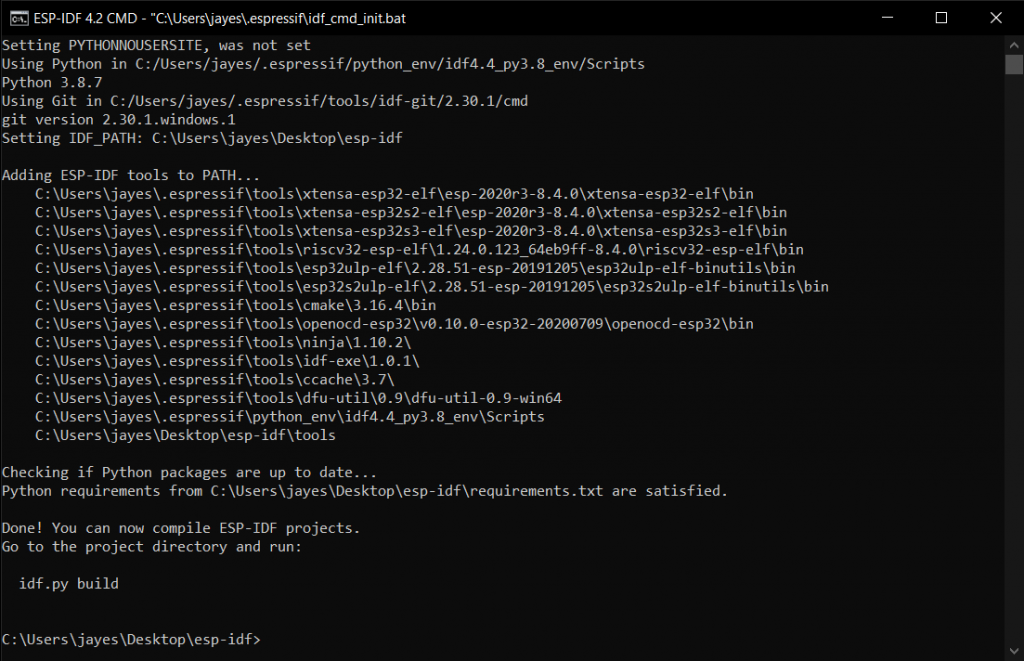

Step1: Launch your ESP-IDF CMD Environment.
Launch ESP-IDF Environment

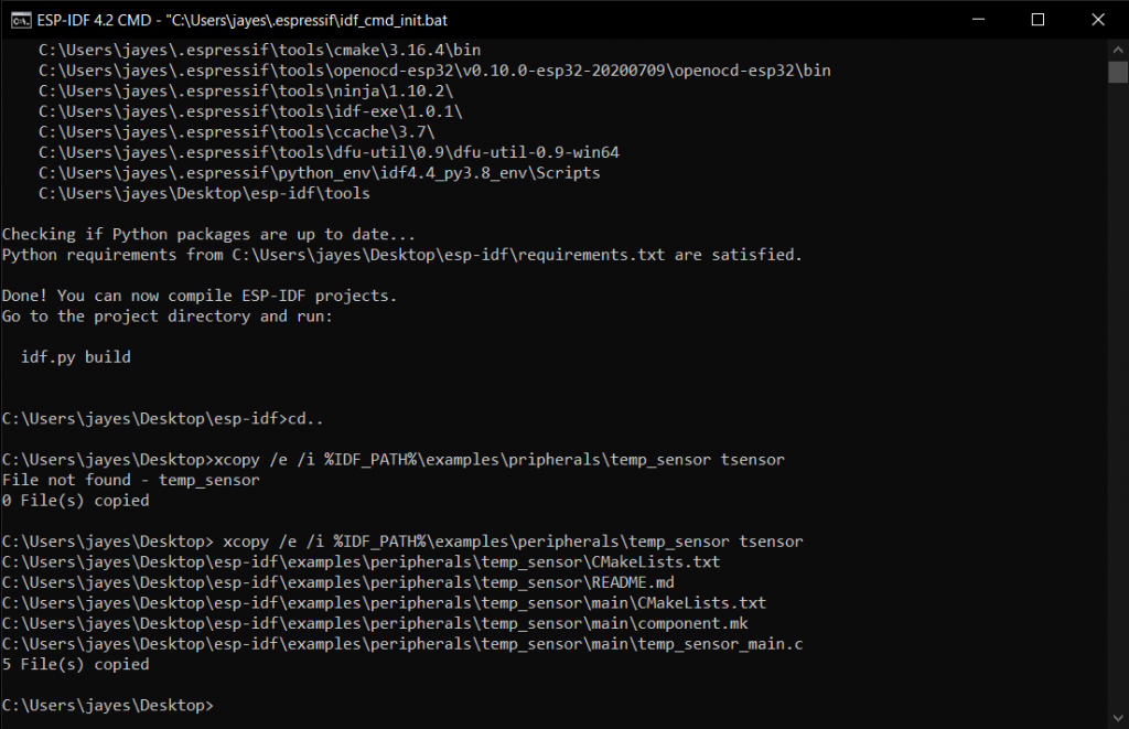

Step2: By default, you will be in the esp-idf home directory, change the directory by using the cd.. command.
Step3: Make a copy of the temp_sensor folder situated in the examples folder of esp-idf home directory in the current location using
xcopy /e /i %IDF_PATH%\examples\peripherals\temp_sensor tsensor command.
Copy Temperature Sensor Folder

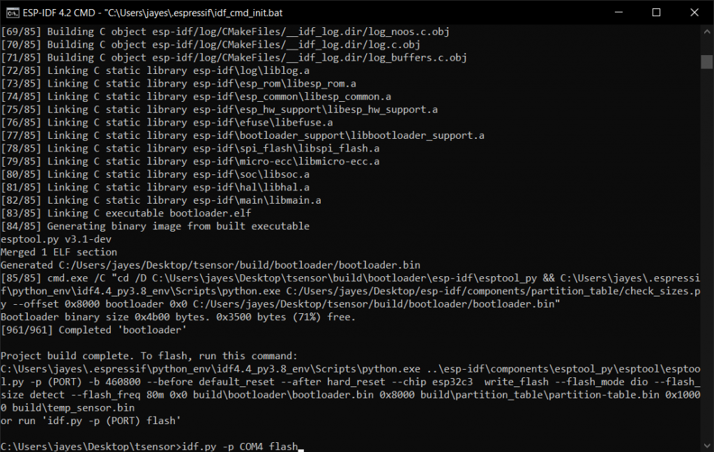

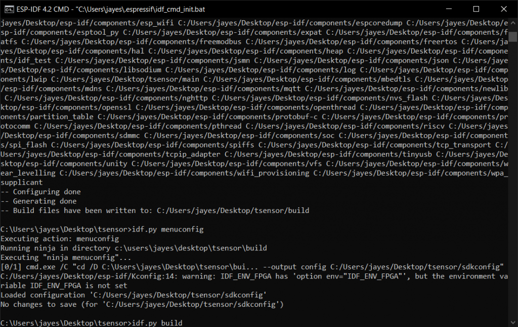

Step5: Build the program compatible with the board you have using idf.py set-target and idf.py menuconfig commands and then execute the idf.py build command.
Setting Target and Building
Step6: Connect the board and flash the program using idf.py -p (PORT) flash. Enter the Port connection of your board. You can find this using the device manager on your PC.
Flashing Port of ESP32-C3-DevKITM-1

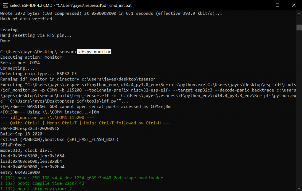

A Done message will appear indicating completion of flashing operation. The Idf.py monitor command gives the real-time status of temperature from the board.
Real Time Temperature Status from ESP32-C3-DevKITM-1
The following is the output result from the sensor on the IDF Monitor.
Output Temperatures on CMD
