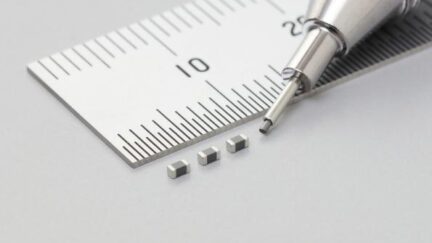

FDK developed ultra small size all-solid-state battery with capability of high voltage output using high electrochemical potential cathode material “lithium cobalt pyrophosphate (Li2CoP2O7)” and begins sample shipment from 20 December, 2018.
This battery is SMD (Surface Mount Device) type, so they can be mounted as one of the electronic parts, contributing to miniaturization of equipment and reduction of surface mounting cost.
  • Small size SMD type – Dimension of Sample (L) 4.0mm x (W) 2.0mm x (T) 2.0mm
  • High voltage, High capacity – High voltage 3.0V, high capacity 140μAh
  • High energy density – Energy density 26mWh/cm3
  • Wide operating temperature range – Operating temperature range -20 – +105℃
  • High safety and environmental adaptability – Use inflammable materials
  • Use stable oxide sintered ceramics (sulfide free)
