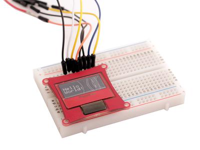

Providing such revolutionary displays to your applications will be a professional approach. For this, a new crowdfunding campaign is providing Paperino, an easy-to-use, micro ePaper shield for the Particle & Arduino community. Paperino simplifies driving ePaper displays with clean, simple, and short script examples.
Thanks to the plug-and-play shield for particle family, Paperino can be used with the following boards: Photon, Electron, or Bluz without manual wiring. It can also be wired easily to be connected with Arduino and other compatible boards.

The Paperino breakout board can be used for manually wiring your favourite, Arduino-compatible microcontroller with 3.3 V and >4kb of free RAM.
  • Resolution: 148 x 70 px
  • Pixel density: 150 ppi
  • Grey levels: 4
  • Weight: 1.2 g
  • Thickness: 500 µm
  • Power consumption: 4.5 mA (mean current for typical image update)
  • Operating conditions: 0°C .. 40°C
  • Storage conditions: -25°C .. 50°C
