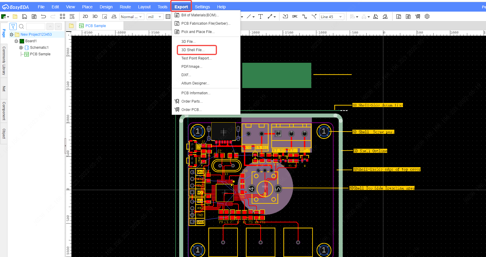

To design a 3D housing, the edges of the 3D housing need to be drawn first.
Entry: Menu – Place – 3D Shell – Outline.

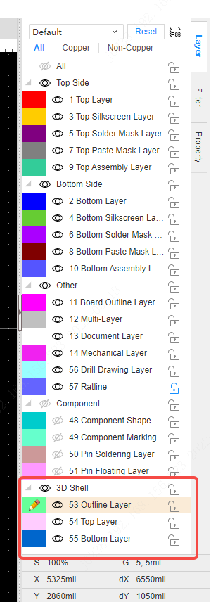

Step 2
The drawn element is automatically switched to the 3D shell outline layer.
Step 3

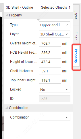

By clicking on the “3D Shell – outline” element you can set its properties in the properties panel on the right.
Step4

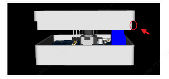

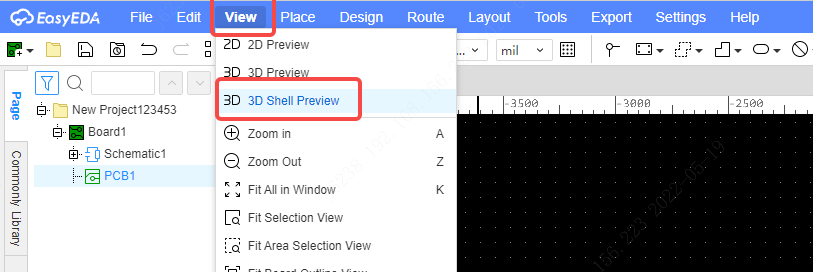

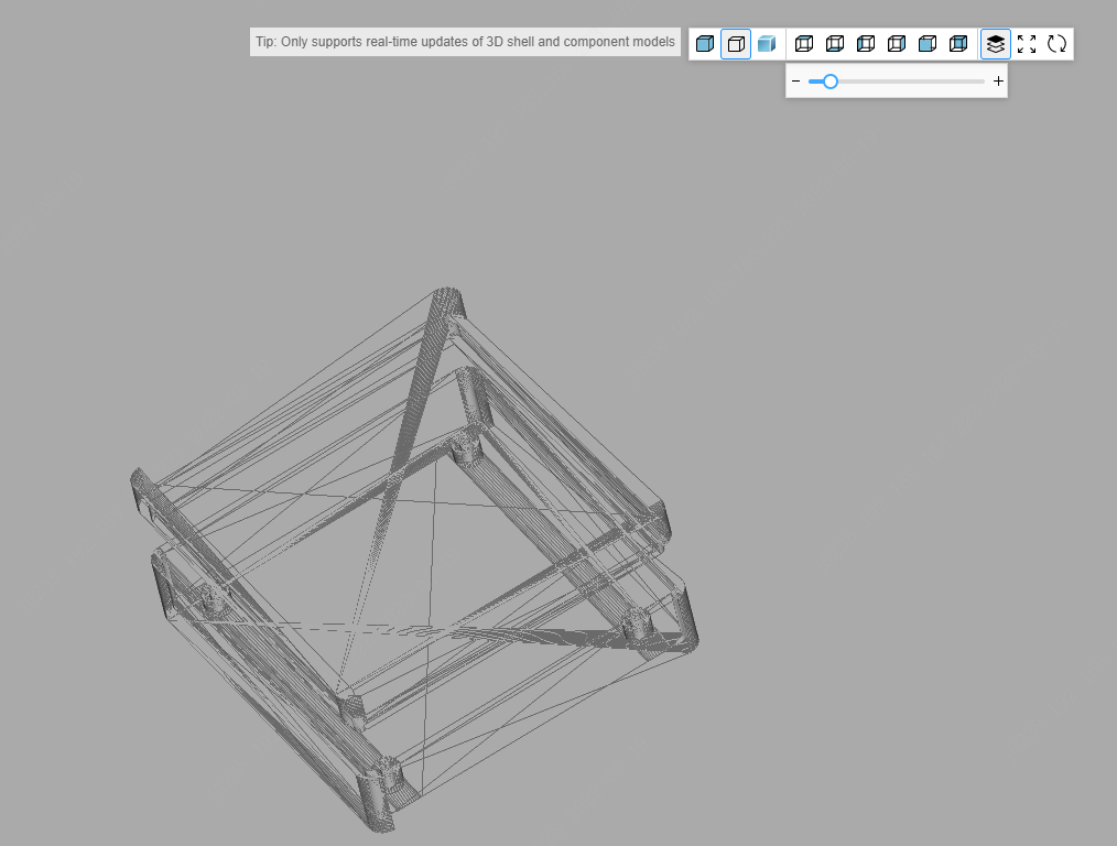

After drawing, a simultaneous preview is available in the Top menu – View – 3D shell preview, where the parameters related to the 3D shell modified by the PCB are synchronized and updated inside the 3D preview. 3D shell preview opens in a new separate window.
Step5
Description of properties.
Type: top and bottom shell, push cover. EasyEDA Pro offers two shell types, for the time being, only the rectangular shell supports push covers.
Properties
  • Layers: as with other lines, you can switch to other layers, and the type changes accordingly when the layer is switched.
  • Overall height of shell: Overall height of the shell, e.g. when the upper and lower shells are combined
  • Height of the lower shell: the height of the lower shell. The height of the upper shell is automatically calculated from the overall height.
  • Shell Thickness: The thickness of the shell. It is recommended that it is greater than or equal to 1.5 mm, otherwise, it will break easily when manufactured in different materials and sizes.
  • Top Inner Height: The height of the alignment recess in the inner wall of the upper shell

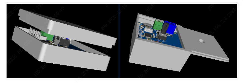

So, let’s see how it works!
Step 6

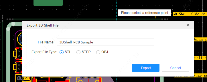

If it already meets your need, you can just output it into an STL file (there are 3 types of files you can output, stl, step, or obj)for manufacturing

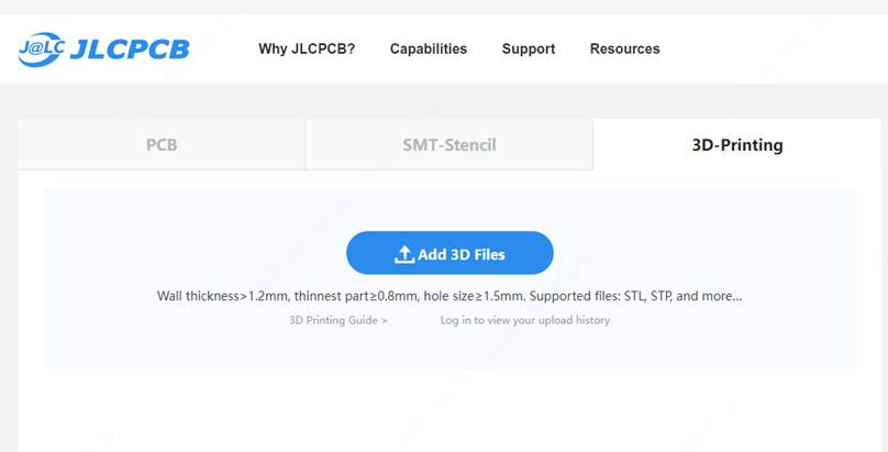

Step 7
Manufacturing: Upload your STL file directly on the JLCPCB 3D Pringting service page, you will get an instant quote for it and it will be finished and delivered in around 2 days. Also, they have $54 Coupons for newly registered users now.
