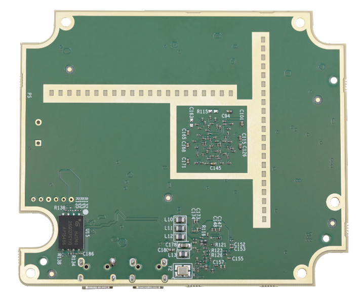

Vayyar's 4D Imaging Chip
4D Imaging using radar technology provides good resolution and field of view for scanning applications. Vayyar’s single-chip platform is a good example, as it integrates multiple antennas using RoC for improved 4D Imaging.
The multifunctional single-sensor platform fulfills the Euro NCAP safety requirements using its 4D Imaging feature. The chip comes with 48 transceiving antennas on a single package, hence reducing the complexity and cost of the device. The 4D Imaging chip is compatible with various software for creating in-cabin safety applications. This includes child presence detection, seat belt reminders, and gesture detection.
Backside of 4D Imaging chip
The gesture detection by using the 4D Imaging chip follows the conventional method of radar imaging, with some additional techniques. The radiowaves cover a certain volume of space by transmission through multiple antennas for calculating direction and distances. The usage of multiple antennas can create a 3D structure. Additionally, the chip also enables analysis of the neighboring pixels by receiving the data on all receiving antennas. This creates real-time imaging of continuous 3D frames, hence allowing 4D Imaging.
Talking more about gesture detection, the real-time 3D frames are in motion if the person moves from the original position to a different position. The 4D Imaging chip is capable of scanning the data using 5 cm large pixels in the space. The system then matches the pattern of these pixels with the general gesture patterns. As, the device supports real-time imaging, so it can detect the change in gestures on a real-time basis as well. This is how gesture detection happens using the 4D Imaging technique.

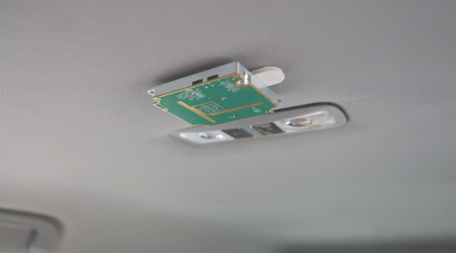

Deployed 4D Imaging Single-Chip Platform
Deployed single chip platform
