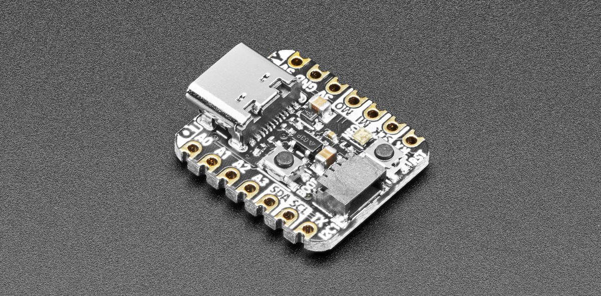

Adafruit QT Py RP2040 is a compact board with dimensions of 21.8mmx 17.8mm and a weight of 2.2 grams. Hence, this makes it ideal for wearable applications like fitness trackers and watches. The board comes with a USB interface, which is compatible with all operating systems. Power, data, and programming are all accessible through the USB Type-C connector. This connector helps in incorporating it into small projects like wearables as a reversible connector. Hence, making it easier to access and user-friendly. Many USB HID devices, such as mouse/keyboard shortcuts, and MIDI, are powered by the board.

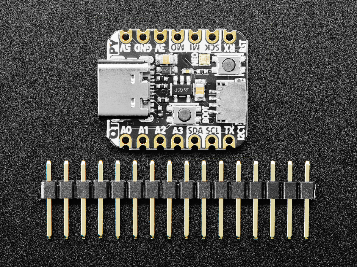

Top View Adafruit QT Py RP2040
Speaking more about the hardware design, the Adafruit QT Py RP2040 has two push buttons on the topside: boot and reset, for quick restarts. The addition of these buttons avoids unplugging and replugging to reload the code. It also features a built-in NeoPixel RGB LED on the top of the board, which serves as a status indicator and notifies us when our code has issues.

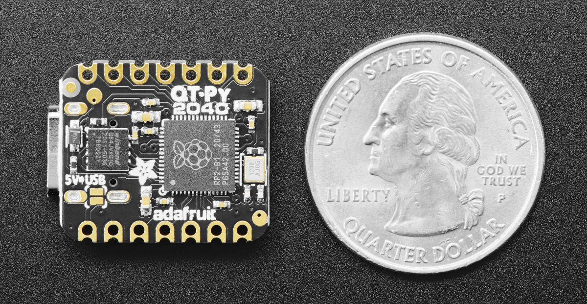

Turning the board over, besides the 264KB of storage offered by the RP2040, the board also has an 8MB SPI flash memory to store project files and CircuitPython/Micropython codes. While using C/C++, you receive the whole flash memory. While using Python, you get the remaining 7MB for storing code, files, images, fonts, etc.
However, unlike SAMD21-based QT Py, this QT Py offers 13 GPIO pins, including four 12-bit ADCs, two I2C channels, and two SPI and UART peripherals. Additionally, it has PWM output on every IO pin for servos, LED’s, etc, and 6 GPIO in consecutive order for PIO compatibility. It has also got a 3.3V pin, a powerful voltage regulator capable of providing 600mA of power to the onboard electronics.
The highlight of QT Py RP2040 is the Stemma QT connector located opposite the USB C port.
“STEMMA is a plug-and-play board and sensor system that lets you quickly plug together various devices and accessories. Including OLEDs and inertial measurement units, without any soldering! Use any SparkFun Qwiic boards! Seeed Grove I2C boards will also work with this adapter cable.”

Bottom View Adafruit QT Py RP2040
