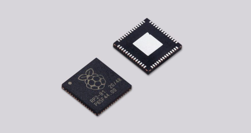

Coming at a time when the global chip shortage is crippling productions across the world, Raspberry Pi Foundation CEO Eben Upton, today shared the news, which will no doubt gladden the heart of many, that the chip at the heart of the Raspberry Pi Pico development board; the RP2040, is now available for sale as a standalone chip at a price of just $1. Designed and developed in-house by the team at the Raspberry Pi, the RP2040 has enjoyed great reviews since its debut on the Raspberry Pi Pico development board, with features like its large on-chip memory, speed, and a wide range of I/O endearing it to a lot of makers and hobbyists.
Designed and developed in-house by the team at the Raspberry Pi, the RP2040 has enjoyed great reviews since its debut on the Raspberry Pi Pico development board, with features like its large on-chip memory, speed, and a wide range of I/O endearing it to a lot of makers and hobbyists. It has featured on boards like the Adafruit QT Py RP2040, and the Arduino Nano RP2040 Connect which was released just a few weeks back, but it is being made available to regular buyers for the first time since launch.
The availability of the RP2040 in the open market means designers can now use the Raspberry Pi Pico in the design phase and shift to the RP2040 in production, giving ultimate flexibility and opportunity for design engineers, all the combined price of $5.
Packed into a QFN56 7x7mm package, the RP2040 features dual Cortex M0+ cores with up to 133 MHz, backed up by 6 banks of 264KB embedded SRAM, with 30 multi-purpose GPIOs which can be controlled via firmware developed using Micropython, C/C++, FreeRTOS, and Rust, and “Arduino C” thanks to the recent Arduino IDE support for the RP2040, which is expected to make the chip even more popular due to the ease and popularity of the Arduino platform.
