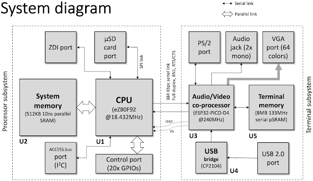

  • The CPU of the module are ZILOG’s eZ80F92 which runs at 18.432 Mhz clock speed. The unit has 128KB on-chip flash program memory and an extra 256-byte configuration flash memory.
  • The system memory is 512KB of SRAM. 8MB of PSRAM is dedicated to audio/video memory.
  • Also, the CPU is packed with 8KB SRAM and has 24-Bit GPIO. 2 universal asynchronous receiver-transmitter(UART) are also available on the CPU.
  • Agon light uses the Espressif ESP32-PICO-D4 module as a VDP (video display processor) which operates at 240MHz. The ESP32-PICO-D4 also handles audio output.
  • The module contains a PS/2 keyboard port and a MicroSD card slot for storage.
Connectivity Features of the Module
Agon light has a VGA port for video output with 640×480 resolution and 64 simultaneous colors. The power is delivered by a USB-C connector which is a good choice as all new phones, tablets, and other devices use USB-C for charging and data transfer. The board is built for maximum flexibility, which means there are lots of options to do a single task. Instead of having to program kernel code in assembly to write to EPROM, its entire firmware can be programmed in C language. It can be done with freely-available tools such as Arduino IDE and Zilog’s ZDS-II IDE.
