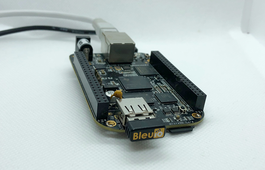

1. Introduction This is a simple example showcasing how to control a BleuIO dongle connected to Beaglebone Black using a python script.
1. Introduction
When running the script, it will first ask for the com port where the dongle is connected (usually ‘/dev/ttyACM0’). After that, BleuIO will start advertising. Every 8th second it will turn on one of the onboard Beaglebone Black LEDs whilst changing the BLE advertising name to indicate which LED is on.

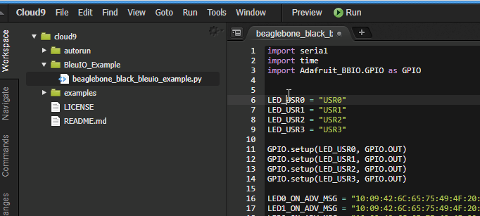

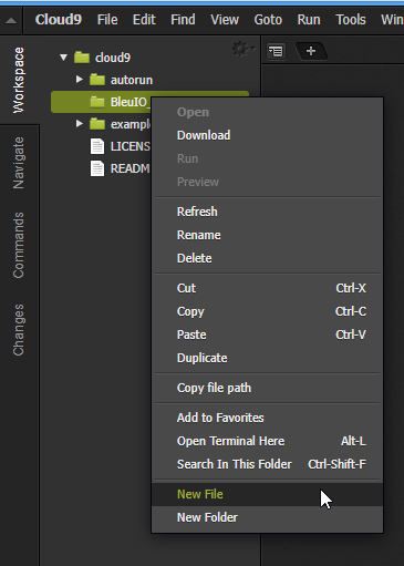

Either clone the project or download it as a zip file and unzip it, into a folder on your BeagleBone.
You can also create a new python file using the Cloud9 IDE from the BeagleBone (run by going to http://192.168.7.2:3000/)
Copy the code and paste it into the newly created file.

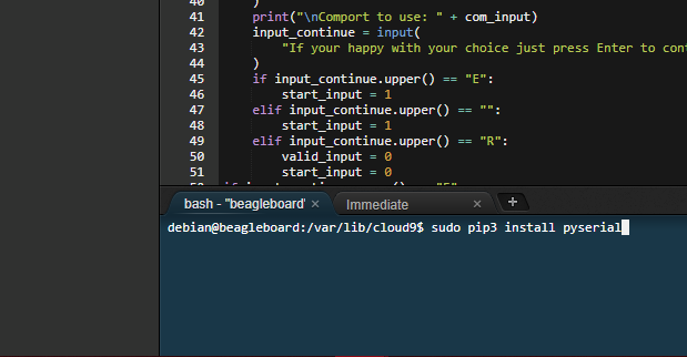

4.2 Installing pyserial
To run the script you will need to install the python library pyserial.
The easiest way of doing this is just connecting to the BeagleBone via shh (the default password is temppwd):
or using the bash tab in the Cloud9 IDE and type:
sudo pip3 install pyserial
