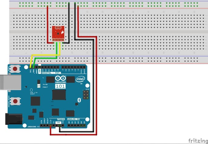

Konstantin Dimitrov has shared a new tutorial on Arduino Project Hub on how to make an Arduino/Genuino 101 Bluetooth Low Energy (BLE) thermometer with TMP102 and Blynk. Blynk is a platform with iOS and Android apps to control Arduino, Raspberry Pi and the likes over the Internet.
Konstantin Dimitrov has shared a new tutorial on Arduino Project Hub on how to make an Arduino/Genuino 101 Bluetooth Low Energy (BLE) thermometer with TMP102 and Blynk. Blynk is a platform with iOS and Android apps to control Arduino, Raspberry Pi and the likes over the Internet. You can easily build graphical interfaces for all your projects by simply dragging and dropping widgets.
You will need:
In order to program this project, you should first include Blynk library by going to:
Sketch => Include Library => Manage Libraries. Click on “Manage Libraries”, then type Blynk in the search bar and you will get the library.  You should scan this QR code once you install the Blynk app on your smartphone to complete the settings.
“Now you need to get the “Auth Token”. Tap on the “Nut” icon then tap on the device and again on it, now you should see your “Auth Token”. E-mail or rewrite it, cause you will need it in the next step !”
In order to connect the Blynk app, tap on the Bluetooth app, tap on “Connect BLE Device” and choose your 101 board. You are now connected!
Finally upload this sketch on you Arduino:
