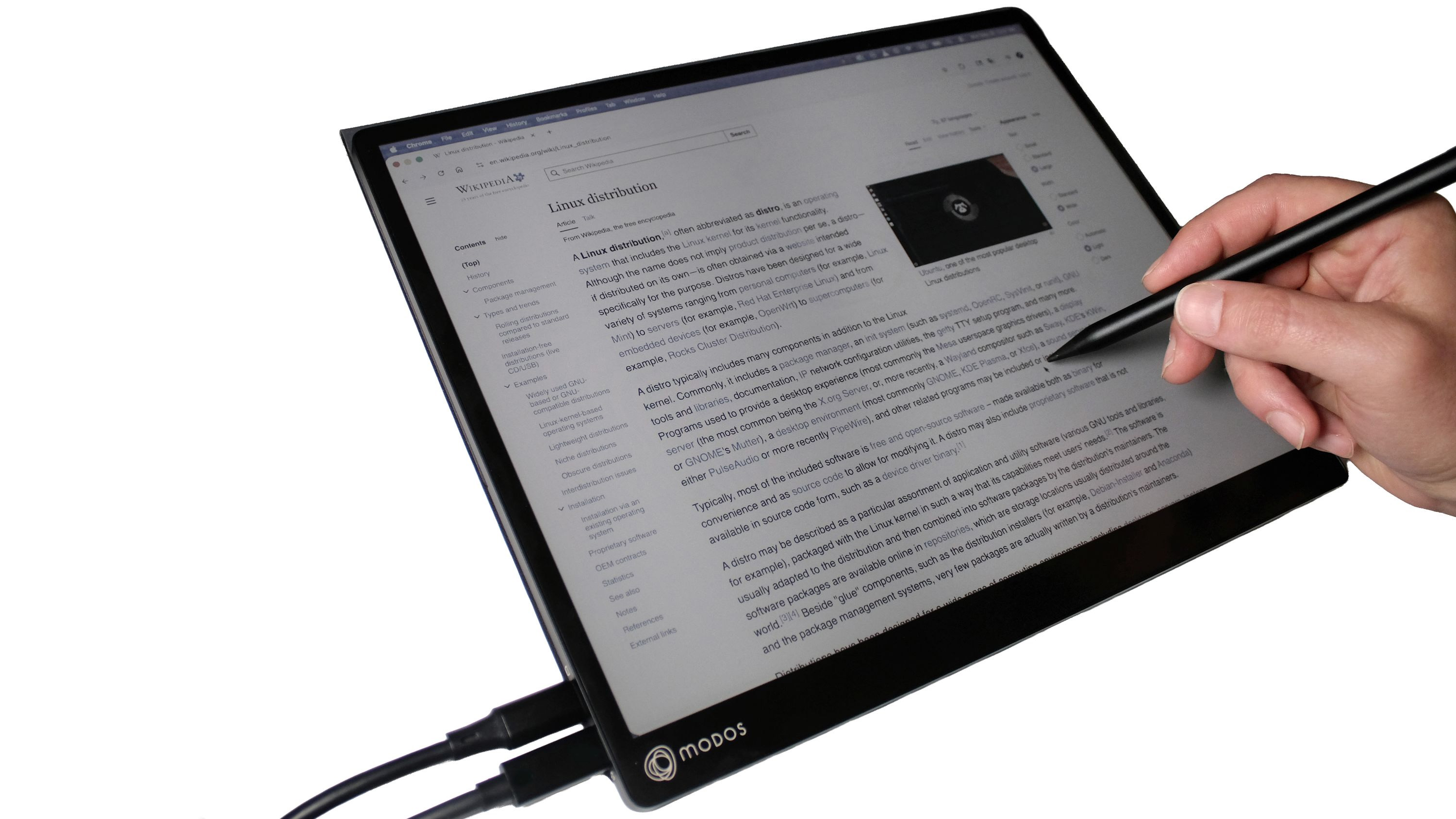

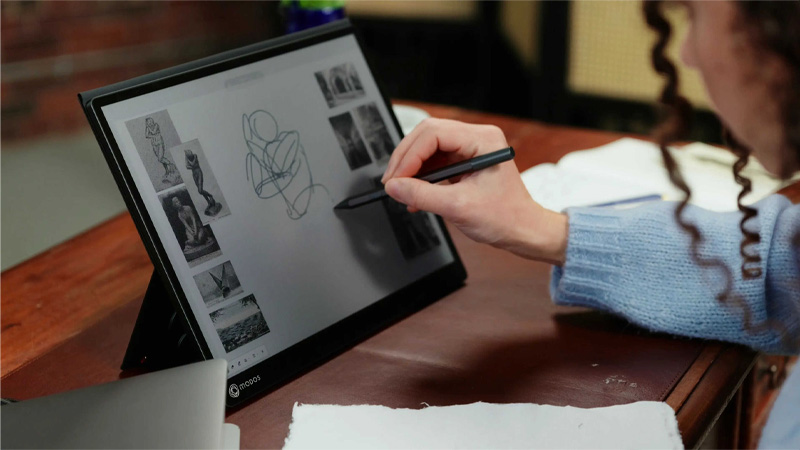

Using the Modos Flow color E Ink monitor with an active stylus for drawing and handwriting

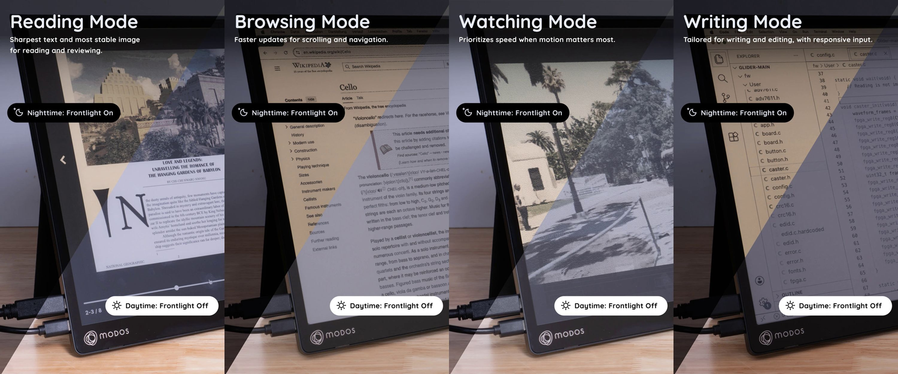

Modos Flow offers four display modes optimized for reading, browsing, video playback, and writing
The monitor is compatible with Linux, macOS, and Windows systems, and connects via USB Type-C with DisplayPort Alt Mode. It can operate using a single USB Type-C cable at up to 40 Hz, or up to 60 Hz when an external power source is connected. Users can switch between Reading, Browsing, Watching, and Writing display modes using the onboard buttons or software shortcuts through the Modos Flow API. Each mode adjusts the display’s refresh behavior to balance update speed, image quality, and ghosting.

Modos Flow color e-paper monitor with stylus support, displaying a Wikipedia page
