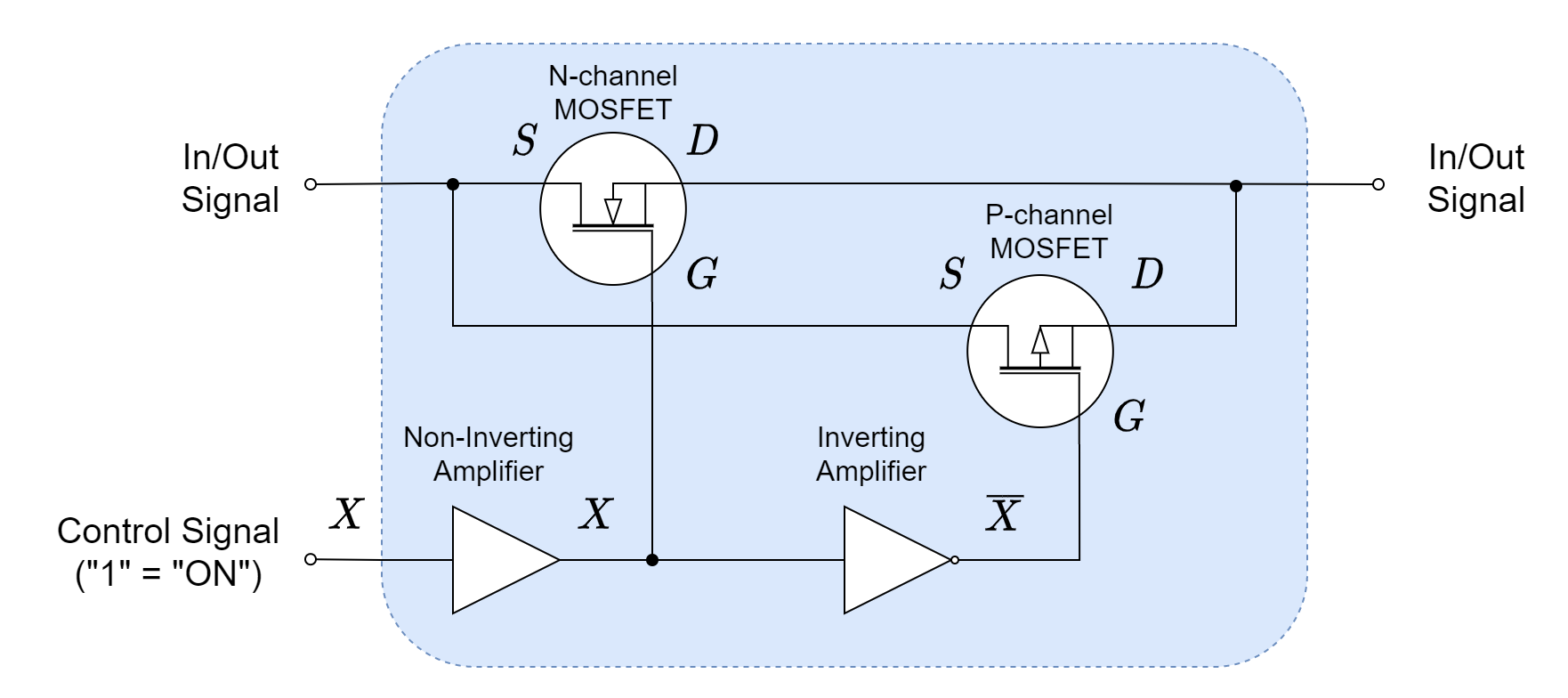

The analog bilateral switches are those which suppress (block) switching of data and signal currents when in the “OFF” state and allow the same when in the “ON” state only. The triggering of the switch state is carried out by a digital signal applied at the control gate of the switch. The switching, between “OFF” and “ON” and vice versa, is rapid. The switch offers a negligible resistance (ideally zero) in the “ON” state and very high resistance (ideally infinite) when it is “OFF”. In the following figure, a typical bidirectional solid-state switch consisting of N & P-channel MOSFETs is shown.
Bidirectional MOSFET switch
Figure 4: The typical diagram of bidirectional MOSFET-based switch.
The direction of signal or data can switch from left to right or from right to left depending on the states of MOSFETs and the voltage level of both sides. The states of MOSFETs are triggered by the “Control” signal. When the “Control” signal is “1” then N-channel MOSFET is “OFF” and P-channel MOSFET is “ON”. The states of MOSFETs are reversed when the “Control” signal is “0”.
