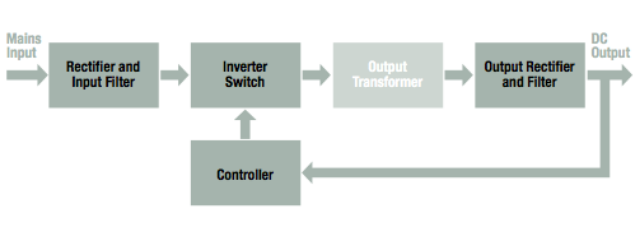

Switched Mode Power Supply Topology
As Switch Mode Power Supply contains a large number of components, thus it needs different stages. Every stage takes care of all the factors necessary for optimal performance. Example: If the input supply is AC, then the input stage has a provision of rectifier and low-pass filter for AC to DC conversion. There is also an inverter stage available for DC to AC conversion by simultaneous switching DC voltage on and off. The rate of switching decides the frequency of the AC output.

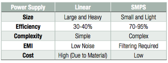

Comparison between Linear Mode and SMPS
Comparision between SMPS and Linear Mode
From the above image, it is quite clear that SMPS is preferred over linear mode power supply when design criteria are taken into consideration. Also, the compact size and efficiency also act in favour of SMPS as discussed in the previous sections. Although SMPS outweighs linear mode, the selection of different topologies of SMPS is also a difficult choice. There are various SMPS topologies:

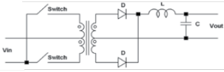

Push-Pull
As seen from the circuit, push-pull topology comes with dual primary windings of the forward topology circuits to build a two-drive winding. Hence, it increases the efficiency as the utilization of the transformer core is optimal than any flyback or a forward converter. Push-pull converters also have a provision of scaling up during high-power requirements.
Push-Pull Switched Mode Power Supply Topology
As the use of copper is 50% at an instance, thus it leads to an increase in the copper loss values. For alike power levels, the push-pull circuits feature compact filters with respect to the forward converter. Additionally, the switching functionality is crucial because if both the switches turn on simultaneously. Then it will cause an equal and opposite flux in the transformer, thus reducing the impedance of the circuit. This sudden drop in the impedance value rises the current value exponentially. Hence, there is a potential chance for the damaging of the circuit.
