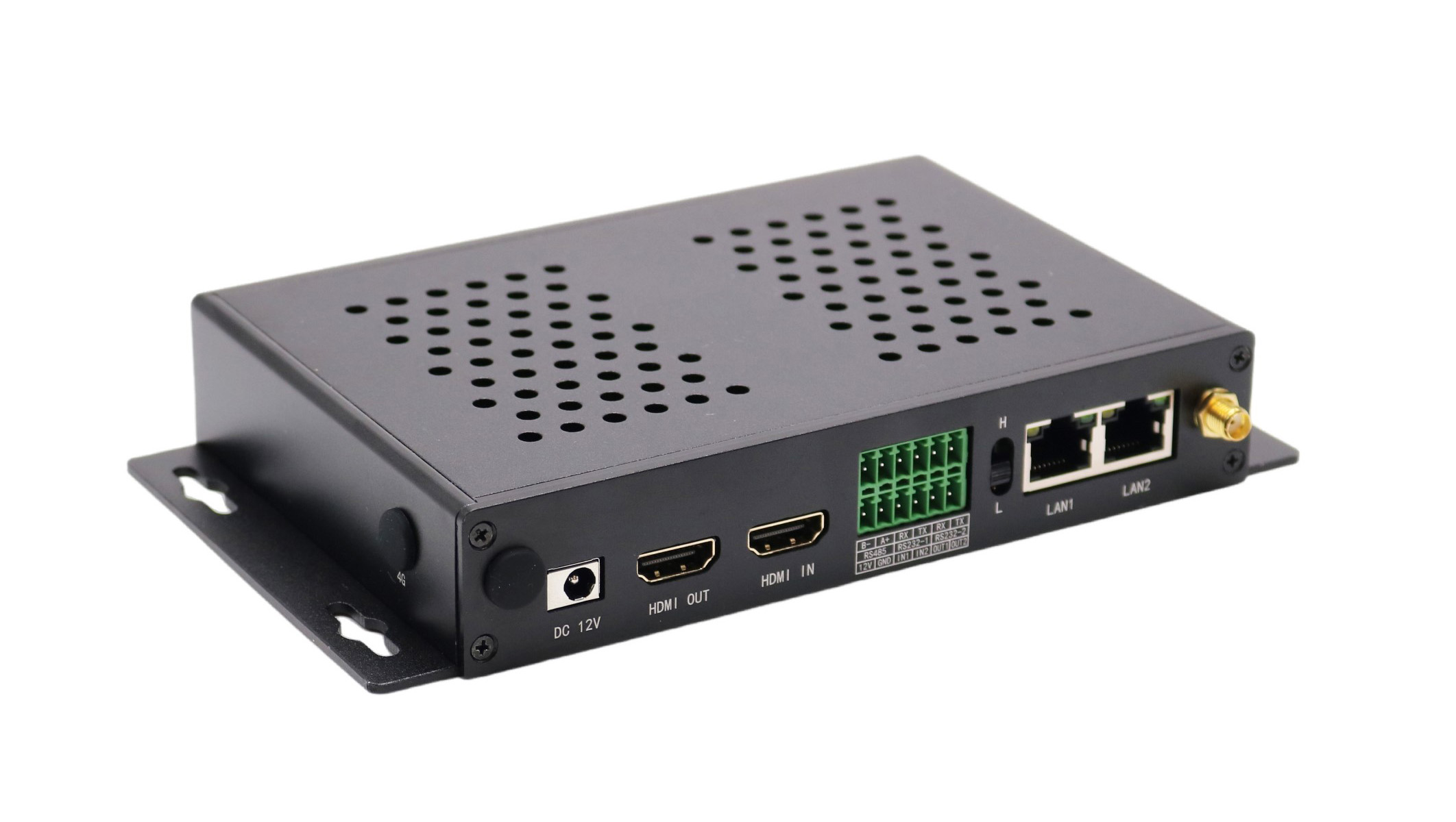

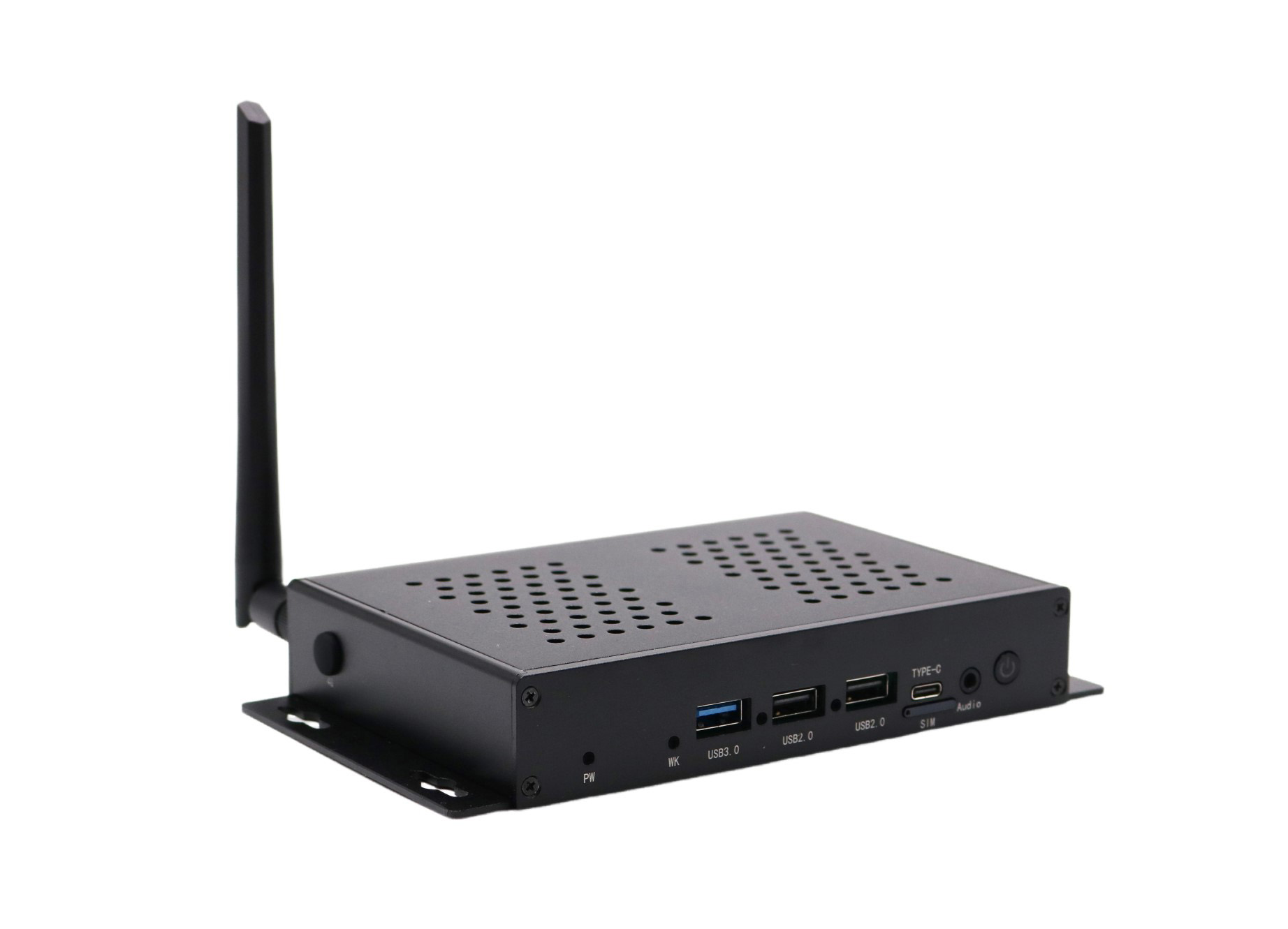

Mekotronics R57 is a fanless AI mini-PC powered by a Rockchip RK3576 octa-core Cortex-A72/A53 SoC SoC. Other than that it has dual GbE Ethernet, 6 TOPS NPU RS232, RS485, and digital inputs and outputs, and in terms of RAM and Storage it includes up to 4GB LPDDR5, a 32GB eMMC flash.
While looking at the specifications of this PC it looked very similar to the Mekotronics R58X but upon looking it’s clear that it has some differences, like it has now got a HDMI IN port and a HDMI Out port and it also got h RS232, RS485, ports.
Decoder: H.264/AVC 4K@60fps; H.264/HEVC, VP9, AVS2, AV1 4K@120fps or 8K@30fps
Encoder: H.265, H.264 up to 4K@60fps; supports multi-stream encoding
OS Support:
Android 14, Buildroot, Debian, Armbian
Video Output:
HDMI output 4K@120fps or 8K@30fps
Type-C (DP1.4 protocol)
HDR Support:
HDR10 / HDR HLG/HDR ViVid
Video Input:
HDMI input 4k@60fps
Camera:
MIPI CSI
Display:
MIPI DSI
Ethernet:
Dual G-LAN network 1000Mbps x2
Wireless:
AP6256, 2.4G/5G WiFi and Bluetooth V5.1 EDR and BLE
Clock:
Support RTC clock
USB:
USB3.0, USB2.0, Type-C
PCIE:
PCIE 3.0 M.2 M-key), support NVMe SSD size 2280
Mini PCIe:
Mini PCIe for 4G LTE/GPS module
SIM Card Slot:
Support Nano SIM card for 4G
Audio:
Support MIC and audio jack
Industrial Ports:
RS232, RS485
GPIO with High/Low switch
DC Power:
12V 2Ah (DC port 5.5×2.1)
Dimension:
186 x 106 x 33mm
Weight:
362g
Mekotronics ensures comprehensive support for multiple operating systems including Android 14, Ubuntu, Debian, and Buildroot. Additionally, the system seamlessly integrates with AI frameworks such as TensorFlow, MXNet, PyTorch, and Caffe through the RKNPU2 toolkit, a feature consistent with other recent Rockchip SoCs.
Mekotronics R57 fanless AI mini PC is available for $140 on the company’s website with the default configuration of 4GB RAM and 32GB of Storage. More details and purchasing options can be found on the products page.

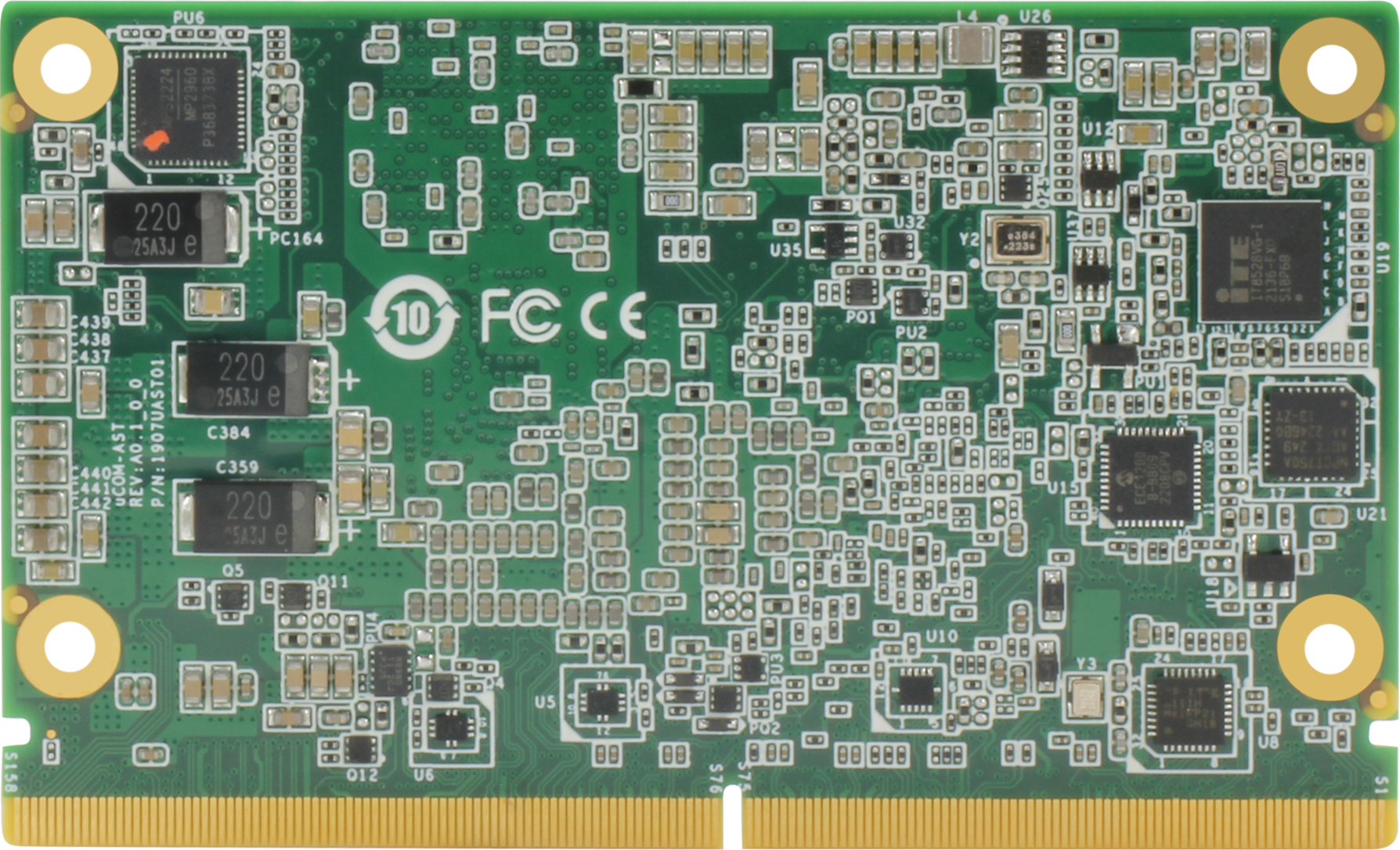

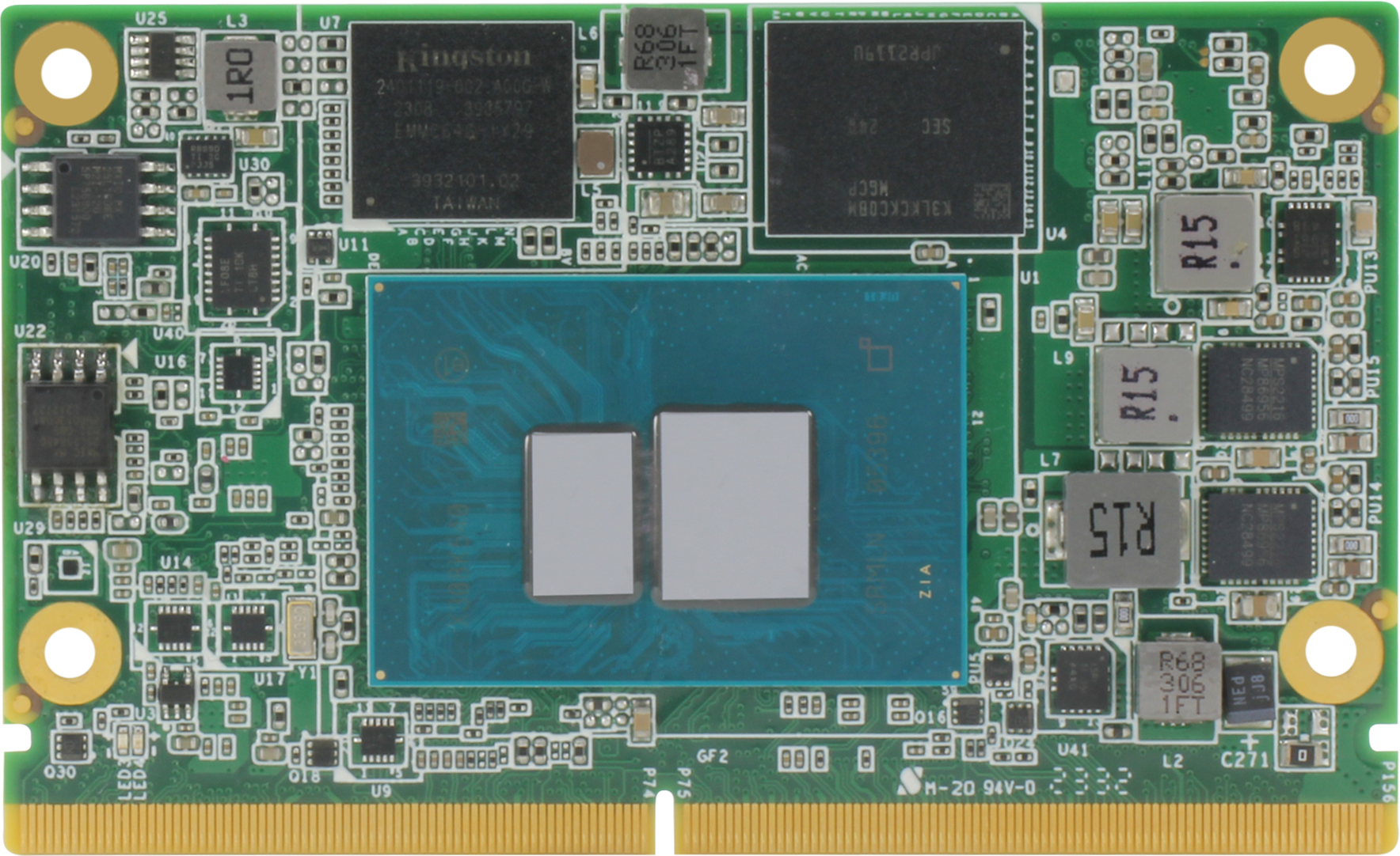

Incredibly robust and with extensive connectivity, the uCOM-ADN offers a compact, efficient, and versatile tool for building industrial IoT applications.
AAEON, a leader in industrial IoT and AI Edge solutions has released the uCOM-ADN, a SMARC module powered by Intel® Atom® x7425E, Intel® Processor N97, and Intel® Core™ i3-N305 processors.
The uCOM-ADN represents the revival of AAEON’s involvement in the SMARC module sphere, where it is clear that the company’s extensive experience in creating reliable and high-performance Computer-on-Modules has proven invaluable. A standout feature of its newest offering is the uCOM-ADN’s support for the 8-core, 8-thread Intel® Core™ i3-N305 Processor, which merges high performance with efficient operation. The product also supports Intel Atom® x7425E and Intel® Processor N97 from the broader Intel® platform, giving users more flexibility.
Featuring up to 8GB of onboard LPDDR5x memory and 64GB of eMMC storage, the uCOM-ADN can achieve excellent data processing speed while providing ample storage capacity. Integrated Intel® UHD Graphics also lend it to applications requiring quality visual output, emphasized by two DP++ and one eDP interface at resolutions up to 3840 x 2160. This selection makes the uCOM-ADN well-suited to digital signage and smart kiosk solutions.
Key Specifications
Processor: Alder Lake N (Core i3-N305, Intel Atom x7425E, or Intel Processor N97)
Interfaces & Expansion: MIPI CSI x 2, PCIe Gen 3 x 3, GPIO, SMBus, UART
Dimensions: 3.23″ x 1.97″ (82mm x 50mm)
Operating Systems: Windows 10/Windows 11 Enterprise, Linux Ubuntu 22.04.2/Kernel 5.19
For visual data acquisition, users have a broad range of interfaces to choose from, including two MIPI CSI, multiple USB, and dual LAN connectors supporting Intel® Ethernet Controllers I226-V or I226-IT, both running at 2.5GbE. For industrial communication, the module offers several UART interfaces, alongside a customizable 7-bit GPIO and SMBus. Expansion can be found in the form of three PCIe Gen 3 slots, while AAEON notes that a fourth PCIe Gen 3 interface is available upon request.
Of particular note is the module’s rugged design, which has a default operating temperature range of -20°C ~ 70°C, with an extended temperature SKU also available boasting a -40°C to 85°C temperature tolerance. This will be good news for those seeking a solution able to withstand challenging industrial environments while maintaining optimal performance.
The inclusion of TPM 2.0 also ensures robust security for critical applications, further lending credence to the uCOM-ADN’s industrial suitability. Support for both Windows® 10, Windows® 11 Enterprise, and Linux Ubuntu 22.04.2/Kernel 5.19 grants the uCOM-ADN broad OS compatibility, making it easy to integrate into existing systems.
For detailed specifications and additional information about the uCOM-ADN, please visit the product page on the AAEON website, or contact an AAEON representative directly.

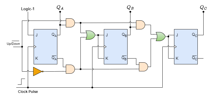

4-bit Count Down Counter
Fig-1: 4-bit Bidirectional Down Counter
As shown in the figure, instead of being activated by the Q output as in the up-counter configuration, the 4-bit counter uses the Q̅ output of the preceding flip-flop to trigger the state change of each flip-flop on the falling edge (1-to-0 transition) of the CLK input. Consequently, rather than moving from 1 to 0, each flip-flop will change states when the one before it goes from 0 to 1 at its output.
Bidirectional Counter
While both synchronous and asynchronous counters can count “Up” or “Down,” bidirectional counters are a more “universal” kind of counter that can count in both ways, Up or Down, depending on the condition of its input control pin. Bidirectional counters, also referred to as Up/Down counters, may count in either way throughout any given count sequence. As seen below, they can be reversed at any time by applying an extra control input.
Synchronous 3-bit Up/Down Counter
Fig-2: 3-bit Bidirectional Counter
The circuit shown above is a typical three-bit synchronous counter that counts from zero (000) to seven (111) and back to zero using JK flip-flops that are set to function as toggle or T-type flip-flops. The 3-bit counter then proceeds in one of two ways: either upward (0,1,2,3,4,5,6,7) or downward (7,6,5,4,3,2,1,0).
Most bidirectional counters are often configured to flip their count direction up or down at any time throughout their counting cycle. This is accomplished by employing a second input pin that controls the count direction (up or down). The timing diagram illustrates how the counter functions when the state of this Up/Down input changes.

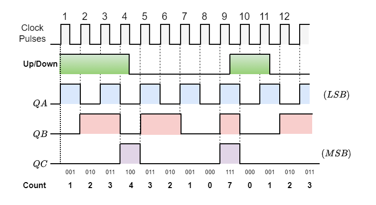

Fig-3: Timing Diagram of Bidirectional Counter

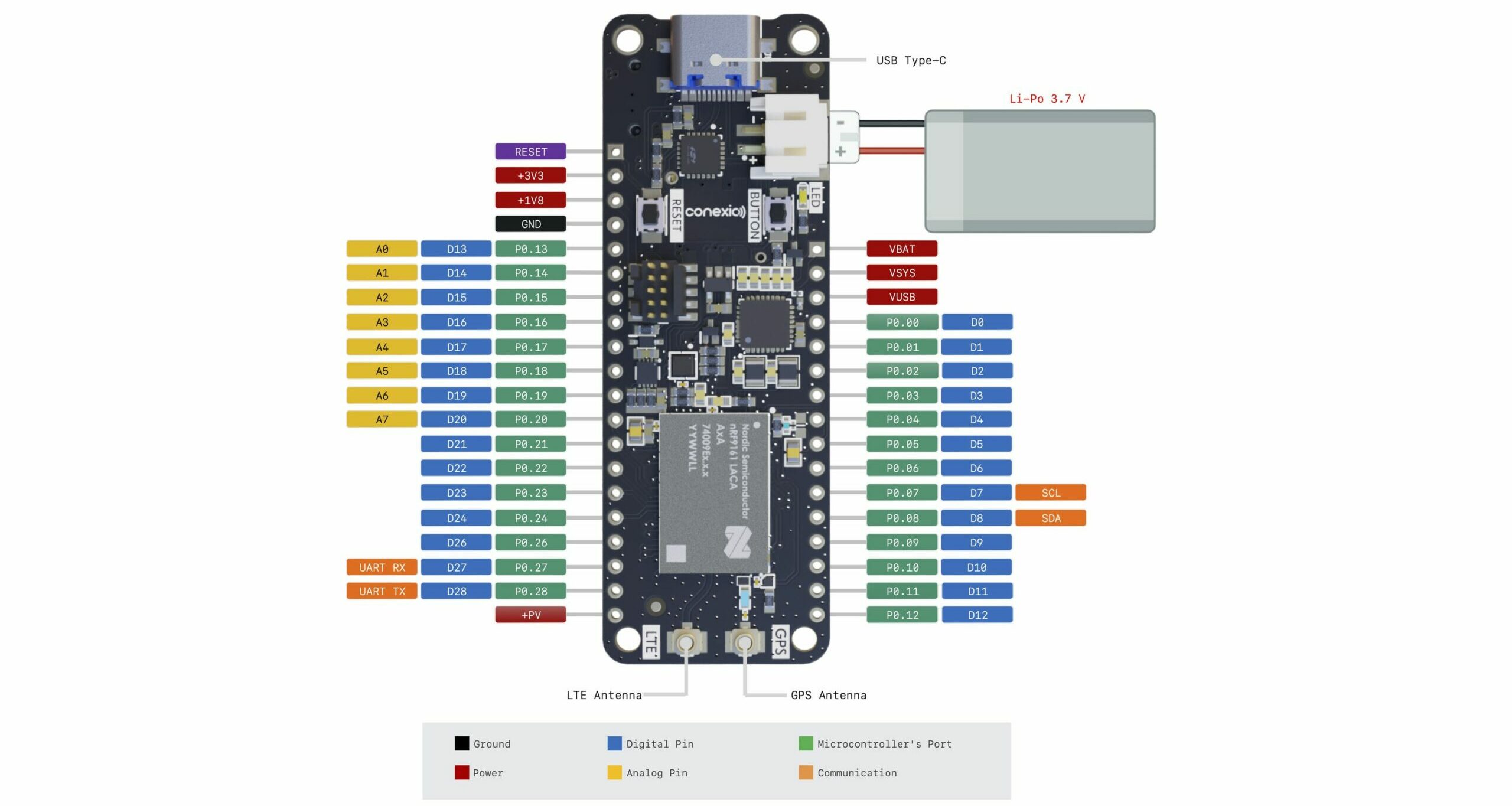

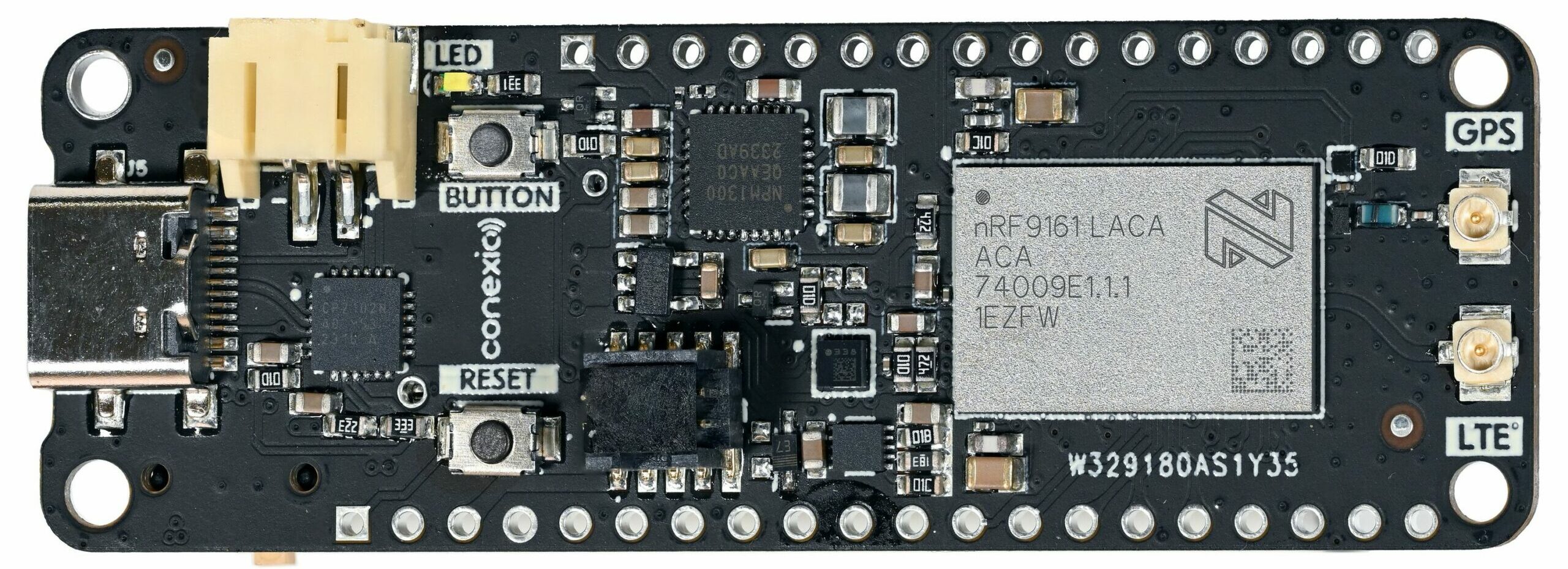

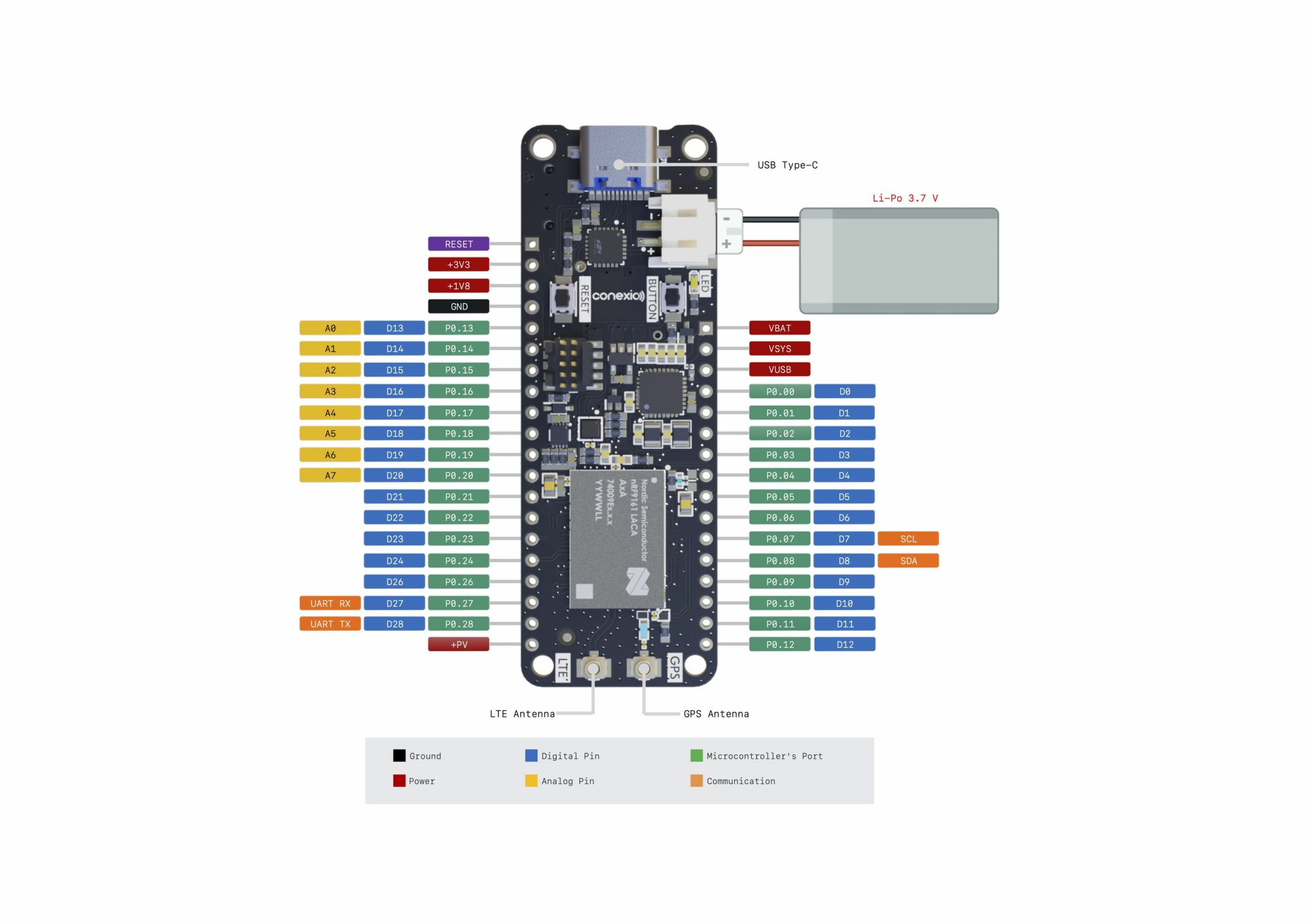

Conexio Technologies, Inc. has recently introduced Conexio Stratus Pro, a battery-powered development board built around Nordic Semiconductor’s nRF9161 cellular modem. The unique aspect of this board is that it has support for LTE-M, NB-IoT, and GPS connectivity and to make things even more interesting it has also support for DECT NR+, and GNSS making it suitable for environmental monitors, smart meters, and industrial automation devices.
Other features of this board include support for solar energy harvesting and an onboard Qwiic connector which gives access to various modules. The form factor of this board also resembles Adafruit Feather so many HATS and adapter modules are compatible with this board.
The company designed the board to be easy to use and compatible with various software platforms. Not only that the board comes preloaded with 10 years of mobile data and SMS, as a value-added feature. Developers can leverage the preprogrammed MCUBoot bootloader, a Visual Studio Code plugin, and integrations with cloud platforms like Edge Impulse, Golioth, and Memfault for machine learning, OTA updates, and remote device management. Additionally, it connects to Datacake for easy data visualization. Documentation and resources are available on the company’s website and GitHub.
Onboard 10-pin 0.05 ” (1.27 mm) mini SWD/JTAG pin connector
Dimensions: 66.04 mm x 25.40 mm

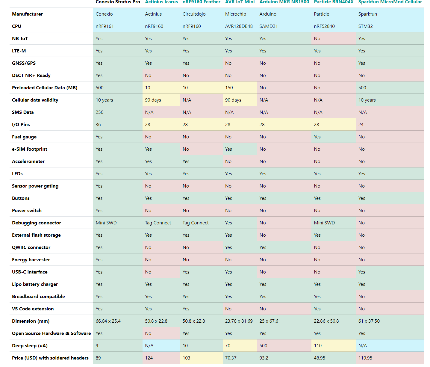

The company also provides a helpful table where the Conexio Stratus Pro is compared with devices like the Actinius Icarus, nRF9160 Feather, and Arduino MKR NB1500, which gives you a clear idea about the board’s capabilities in a very interesting way.
For those who are interested in the Conexio Stratus Pro dev board, the dev kit is available on Crowd Supply. The early bird price is $83, and the regular price is $89, with shipping starting in September 2024.
