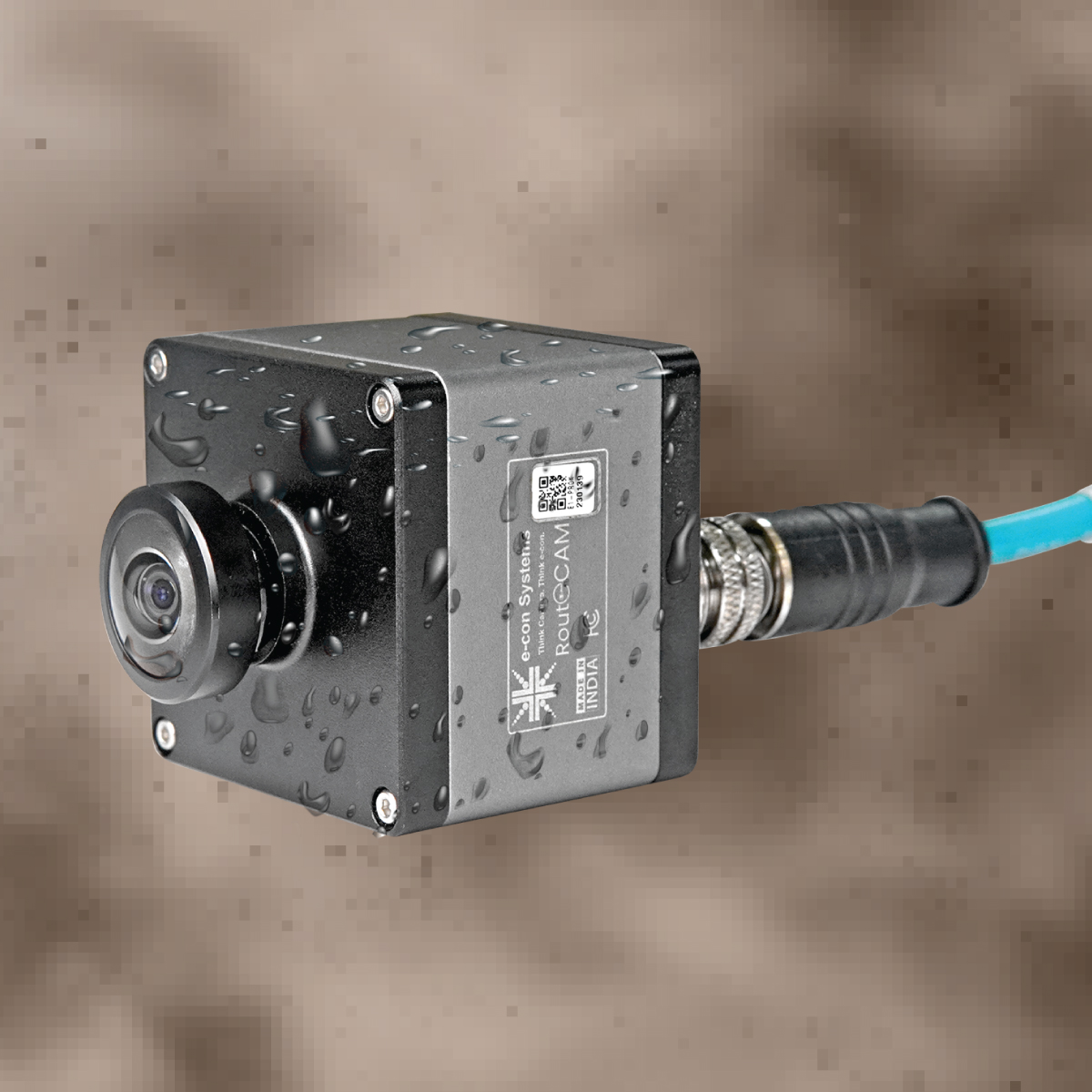

e-con Systems Unveils new Robust All-Weather Global Shutter Ethernet Camera for Outdoor Applications
e-con Systems™, a global leader in embedded vision solutions, introduces a new Outdoor-Ready Global Shutter GigE camera — RouteCAM_CU25, the powerful addition to its high performance Ethernet camera series, RouteCAM. This Full HD Power over Ethernet (PoE) camera excels in delivering accurate and fast capture of moving scenes at high frame rate, making it ideal for applications like smart traffic, road safety and law enforcement, and forklift safety.
With PTP Synchronization, RouteCAM_CU25 camera achieves sub-microsecond levels of time synchronization for precision-critical applications and ensures that frames captured by multiple Ethernet cameras are precisely synchronized.
RouteCAM_CU25 camera seamlessly integrates with our cutting-edge cloud-based device management platform, CloVis Central™, providing comprehensive remote management of all on-field device operations. This integration facilitates quicker time to market, cost reductions, and improved application success rates. Additionally, the camera meets industrial-grade standards such as ISO 16750 and ISO 20653:2013, ensuring it can endure extreme temperatures and guaranteeing durability and resilience for outdoor use in any environment with an IP67 rating.
This GigE camera boasts the ability to stream high-quality, compressed Full HD data in a range of industry-standard formats including MJPEG, H.264, and H.265.
“Building on the success of our RouteCAM lineup, RouteCAM_CU25 combines Global Shutter and PoE technologies to deliver advanced capabilities for a wide range of industrial applications. The camera offers a significant competitive advantage with its direct cloud connectivity through our device management platform, CloVis Central™, streamlining maintenance and accelerating time to market while also providing PTP synchronization capabilities. With its high performance, rugged design, and flexible features, RouteCAM_CU25_IP67 is well-suited for applications such as Intelligent Transport Systems (ITS) for road safety, law enforcement, and smart parking, as well as industrial safety measures including perimeter safety for forklifts,” said Suresh Madhu, Head of Industrial Business Unit at e-con Systems.

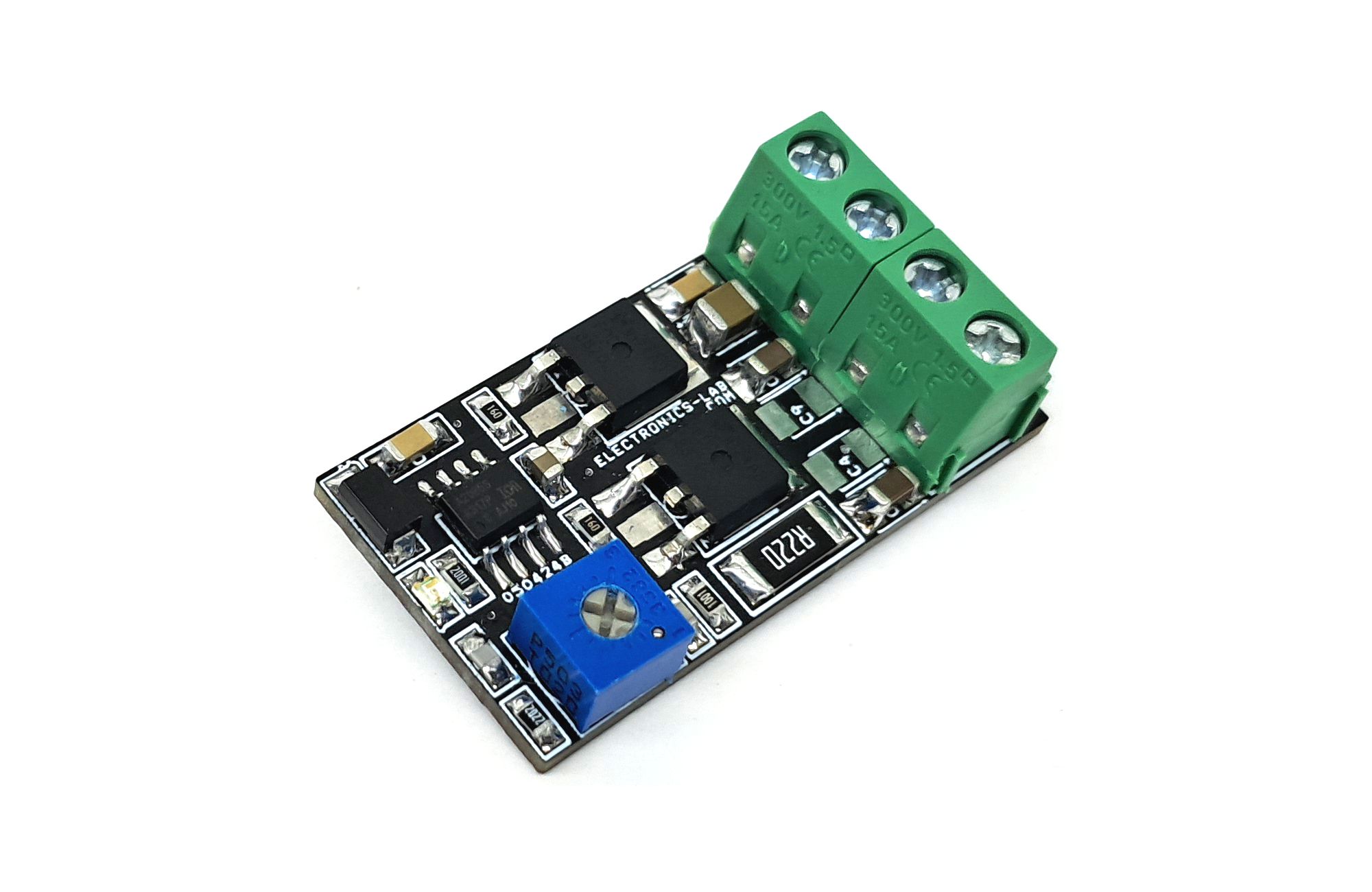

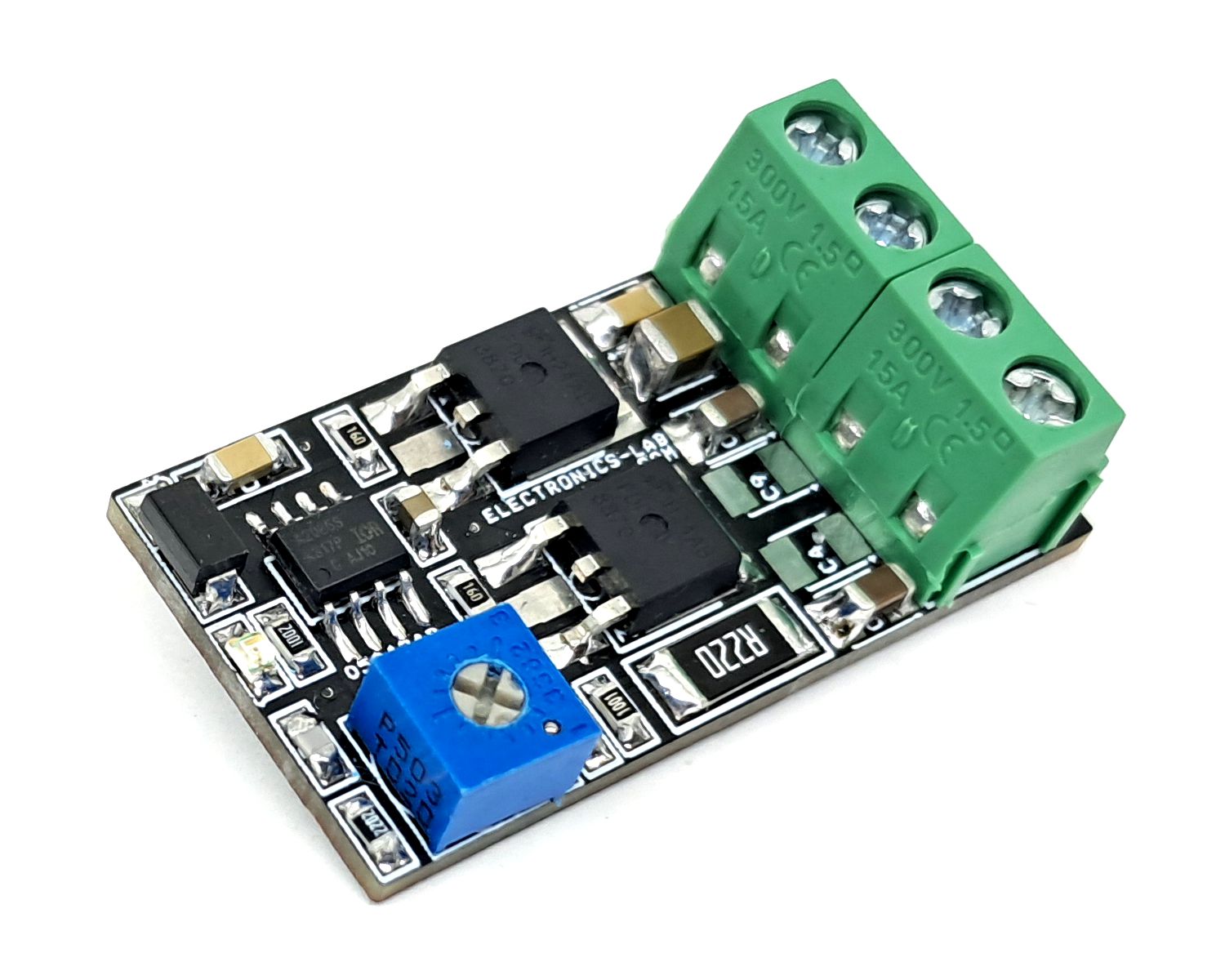

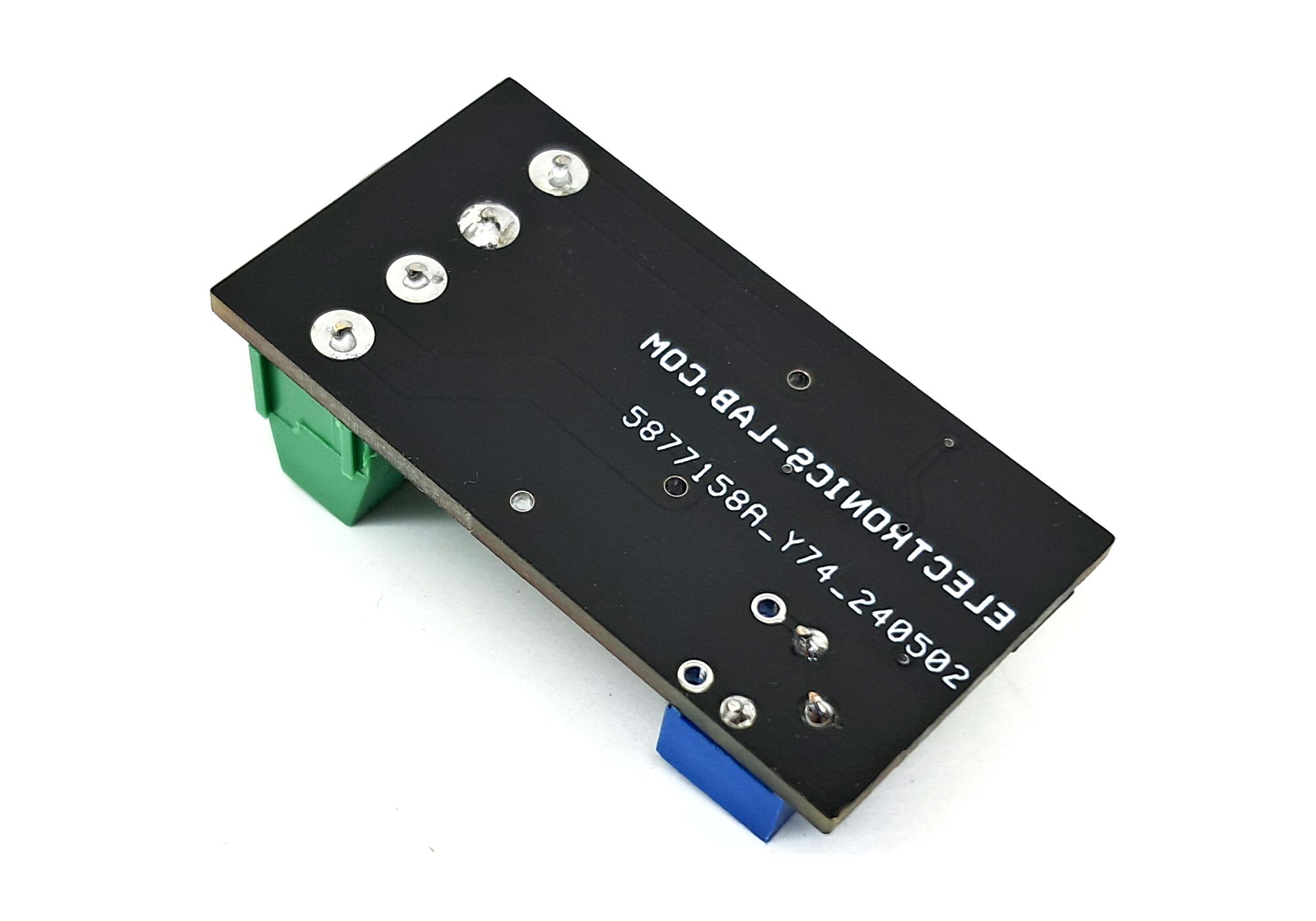

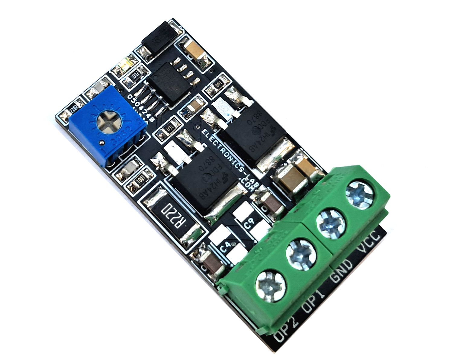

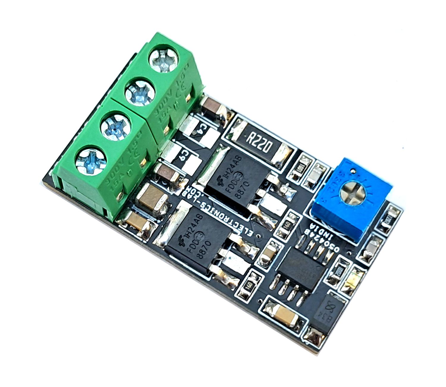

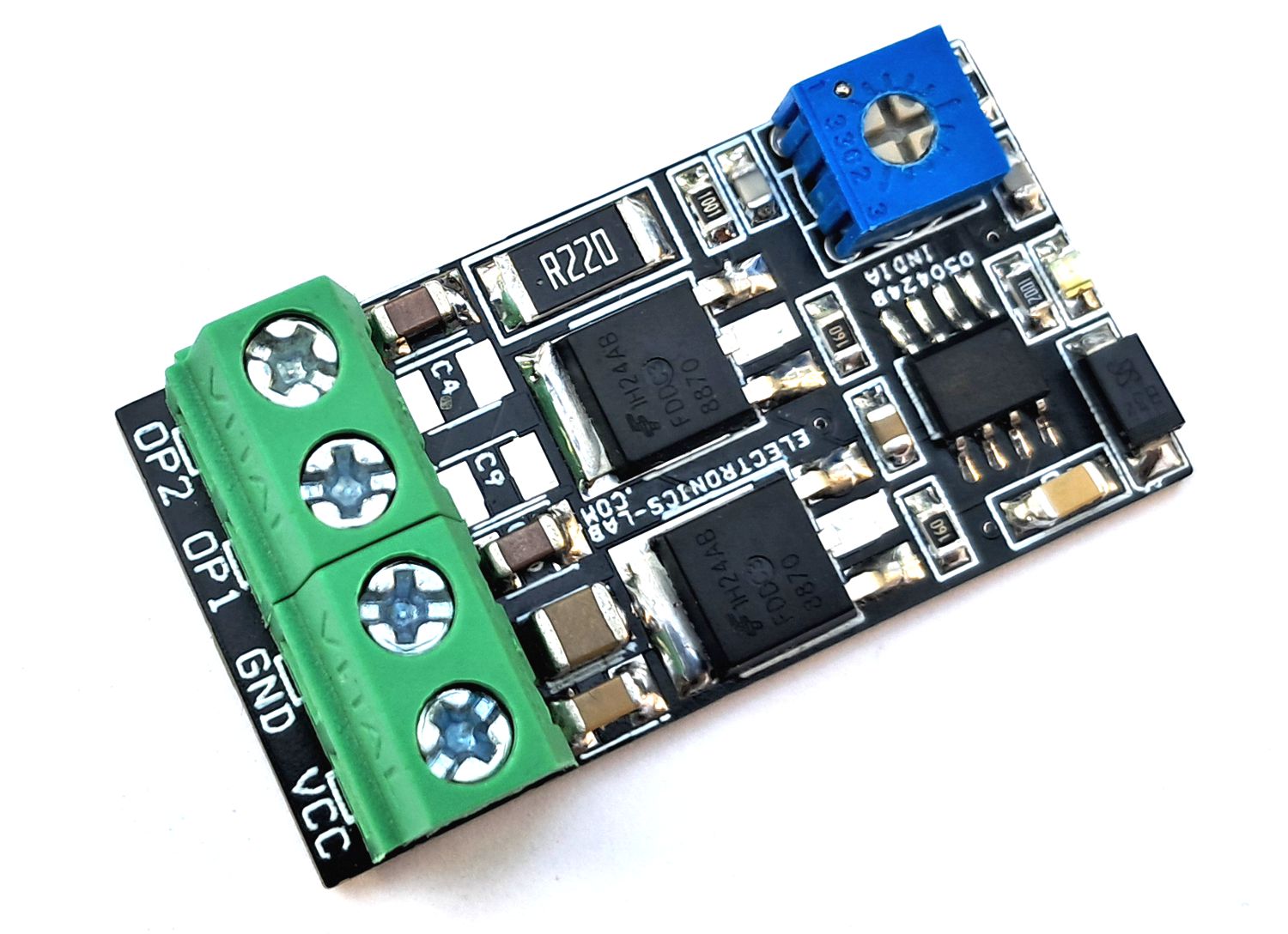

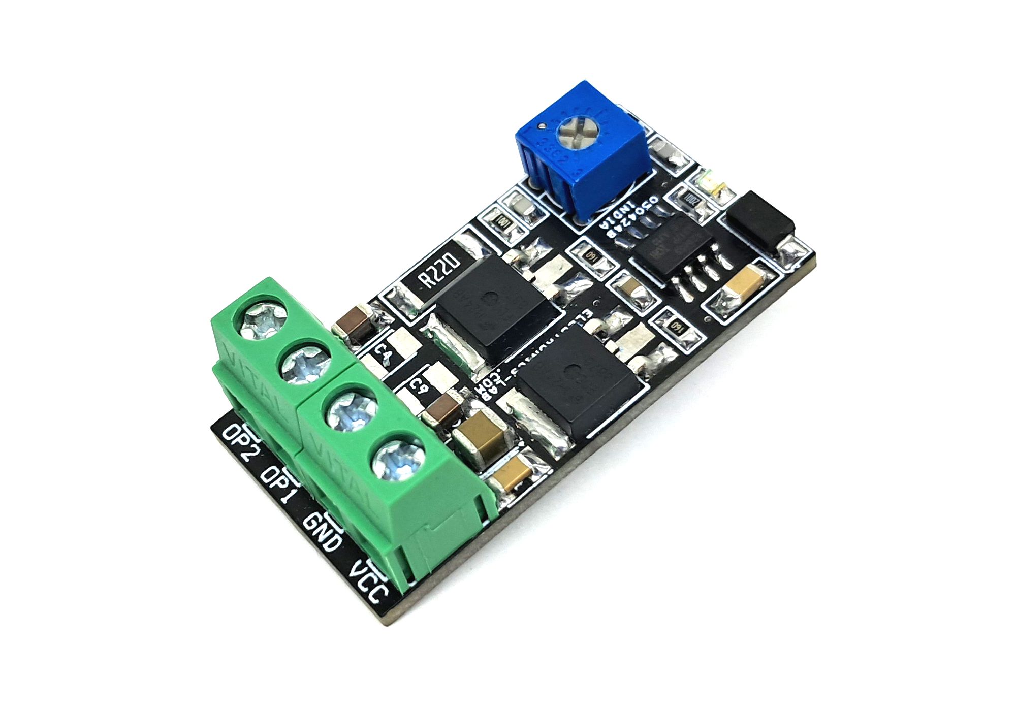

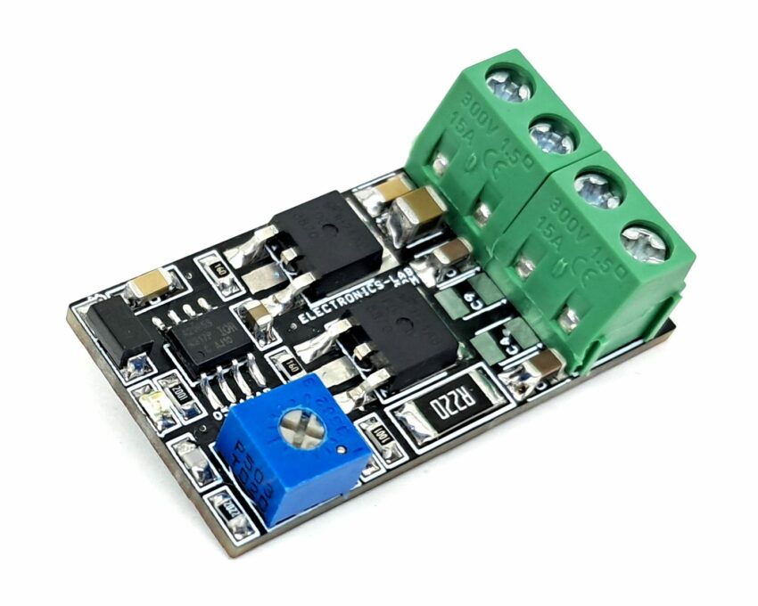

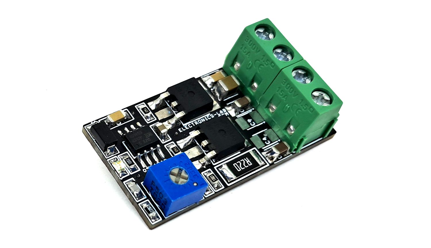

Self-Oscillating Half Bridge Module
This is an automotive-grade self-oscillation 50% duty cycle half-bridge module built using the AUIR2085S chip from Infineon. The project consists of 2 x N-channel MOSFETs, and the module provides a primary side control solution to enable Half-Bridge DC-bus converters. The module is a self-oscillating half-bridge driver with 50% duty cycle ideally suited for 10V – 15V half-bridge DC-bus converters.   The board is also suitable for push-pull converters. Each channel frequency is equal to fOSC, which can be set by selecting RT (R2+PR1) & CT-(C7), Dead-time can be controlled through proper selection of CT range from 50ns to 200ns. Internal soft-start increases the pulse width during power-up and maintains pulse width matching for the high and low outputs throughout the start-up cycle. Typically, the soft-start duty cycle varies beginning from 5-10% ramping up to about 50% over 1000 cycles.  The AUIR2085S initiates a soft start at power up and after every overcurrent condition. Undervoltage lockout prevents operation if VCC is less than 7.5V.
  • Power Supply 10V to 14V DC
  • Integrated 50% duty cycle oscillator and half-bridge driver
  • Adjustable switching frequency 84Khz to 260Khz
  • Undervoltage lockout prevents operation if VCC is less than 7.5V.
  • +/- 1A drive current capability optimized for low-charge MOSFETs
  • Adjustable dead-time 50ns – 200ns (Read Data Sheet for More Info)
  • High and low side pulse width matching to +/- 25ns
  • Adjustable overcurrent protection (Shunt Resistor Value)
  • Over Current Shut Down Threshold 300mV
  • Over Current Shutdown Delay 200nS
  • Turn-on Rise Time 40nS
  • Turn-off Fall Time 20nS
  • Undervoltage lockout and internal soft start
  • PCB Dimensions 40.16 x 21.27 mm

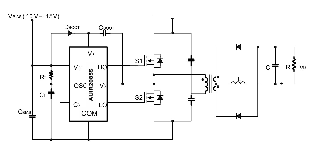

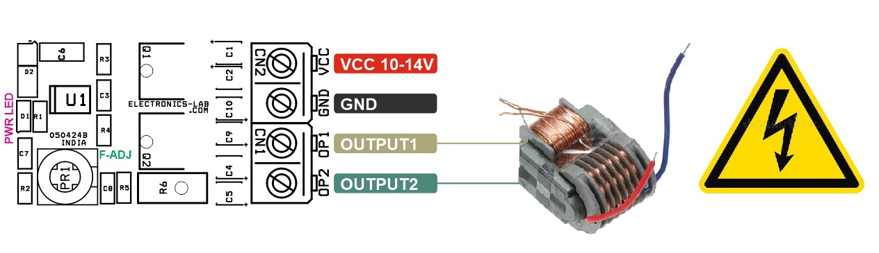

Push-Pull Converter Application
The components like transistors Q1, Q2, the external transformer, and the capacitors C4, C5, C9, and C10 make up a so-called single-ended, push-pull converter. This converter operates the potential-isolating transformer with an alternating voltage in which both half-oscillations are used for energy transmission.

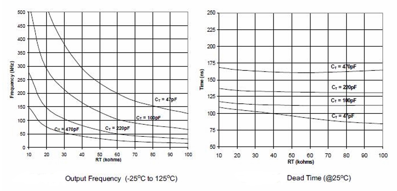

Frequency Adjust
A Trimmer potentiometer is provided to adjust the frequency from 84Khz to 200Khz. The module supports higher frequencies up to 500Khz, read the datasheet of the AUIR2185S chip to learn more about frequency and dead time adjustment. For 500Khz Output CT should be 100pF and RT 10kΩ.
Applications
  • DC-DC Converters, Push-Pull Drivers
  • High Voltage Converters
  • HEV Auxiliary Converter
  • Battery Management Converters
The recommended range of timing resistors RT is between 10kΩ and 100kΩ and the range of timing capacitor CT is between 47pF and 470pF. Timing resistor values less than 10kΩ should be avoided. The value of the timing capacitor determines the amount of dead time between the two output drivers: the lower the CT, the shorter the dead time, and vice versa. It is not recommended to use a timing capacitor below 47pF, for best performance keep the timing components physically as close as possible to the AUIR2085S. Separated ground and VCC traces to the timing components are encouraged.
Connections
  • CN1: Pin 1 Output 2, Pin 2 Output 1 (for Push-Pull)
  • CN2: Pin 1 VCC, Pin 2 GND
  • PR1: Oscillator Adjust
  • D1: Power LED

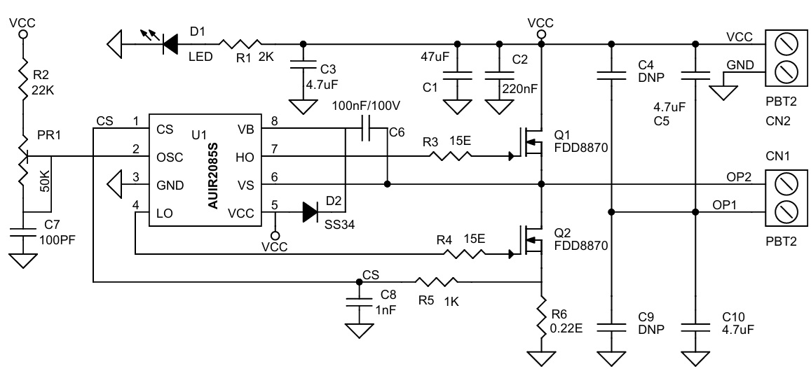

Schematic
Parts List
NOQNTY.REF.DESC.MANUFACTURERSUPPLIER SUPPLIER PART NO
12CN1,CN22 PIN SCREW TERMINAL PITCH 5.08MMPHOENIXDIGIKEY277-1247-ND
21C147uF/25V CERAMIC SMD SIZE 1210MURATA/YAGEODIGIKEY
31C2220nF/25V CERAMIC SMD SIZE 1210 OR 1206MURATA/YAGEODIGIKEY
42C5,C104.7uF/25V CERAMIC SMD SIZE 1210 OR 1206MURATA/YAGEODIGIKEY
52C4,C9DNP
61C6100nF/100V CERAMIC SMD SIZE 1206MURATA/YAGEODIGIKEY
71C7100PF/50V CERAMIC SMD SIZE 0805MURATA/YAGEODIGIKEY
81C81nF/50V CERAMIC SMD SIZE 0805MURATA/YAGEODIGIKEY
91D1LED SMD SIZE 0805OSRAMDIGIKEY475-1278-1-ND
101D2SS34 OR SS14ONSEMIDIGIKEYSS34FSCT-ND
111PR150K TRIMMER POTBOURNSDIGIKEY3362P-503LF-ND
122Q1,Q2FDD8870 DPAKONSEMIDIGIKEYFDD8870FSCT-ND
131R12K 5% SMD SIZE 0805MURATA/YAGEODIGIKEY
141R222K 5% SMD SIZE 0805MURATA/YAGEODIGIKEY
152R3,R415E 5% SMD SIZE 0805MURATA/YAGEODIGIKEY
161R51K 5% SMD SIZE 0805MURATA/YAGEODIGIKEY
171R60.22E/2W 1% SMD SIZE 2512MURATA/YAGEODIGIKEY
181U1AUIR2085S SOIC8INFINEONDIGIKEYAUIR2085S-ND
191C34.7uF/25V CERAMIC SMD SIZE 0805MURATA/YAGEODIGIKEY

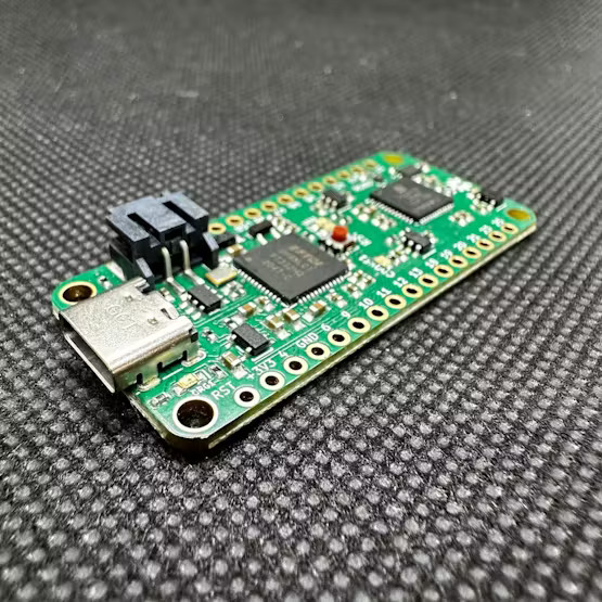

Camera Development board by LilyGo: T Camera+ S3
The addition of a camera module or developer board improves the device’s ability to record and interpret visual data, allowing for more advanced and diverse applications. With the rise in visual recognition techniques, the selection of camera modules becomes a crucial part also considering its compatibility with MCUs. Fulfilling these advanced requirements, the upcoming LILYGO has come up with a solution. The LILYGOs T-Camera-Plus-S3 ESP32-S3 Camera Development Board features a camera supporting resolution of up to 2 Million Pixels (IR-Cut Night Vision), a 1.3-inch capacitive touch display, a speaker [FUET2122], power supply cable and a Bluetooth/WI-FI antenna [3rd Generation].
Specifications of LILYGOs T-Camera-Plus-S3 ESP32-S3 Camera Development Board
It supports ESP32-S3R8 with a radio frequency of 2.4 GHz and becomes a versatile option for any IoT-based MCU. Dual-core Xtensa LX7 is the CPU of the ESP32-S3 chip. Xtensa is a line of CPUs designed by Intel specifically for low-power applications. LX7 refers to the specific CPU architecture within the Xtensa family.

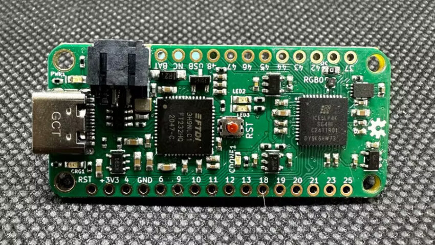

IcyBlue Feather FPGA Board Gets a Modern Makeover with USB Type-C Connector
Oak Development Technologies introduces the upgraded IcyBlue Feather FPGA Board, Version 2, featuring hardware enhancements and the modern USB Type-C connector. Powered by the Lattice Semi iCE5LP4K FPGA, this open-hardware board provides a versatile platform for FPGA development, now with improved connectivity and compatibility.
“IcyBlue combines the capabilities of the iCE40 FPGA with the popular Adafruit Feather form factor, expanding the possibilities for FPGA design,” says Seth Kerr, spokesperson for Oak Development Technologies. “With support for a wide range of sensors and add-ons, including Adafruit Feather wings, IcyBlue simplifies the FPGA learning curve, offering a seamless experience for both beginners and experienced developers.”
The original IcyBlue Feather debuted in February last year, offering a distinct FPGA feather tailored for the Lattice Semi iCE5LP4K. While maintaining the same FPGA core, the new iteration introduces significant enhancements. Key among these is adopting the modern USB Type-C connector for streamlined data and power connectivity, alongside various undisclosed “hardware bug fixes.”
usb type c connectivity
Notably, the redesign retains all the features of its predecessor: two hardware I2C and SPI blocks that do not consume FPGA resources, two user-addressable single-color LEDs, an RGB LED, and 22 general-purpose input/output (GPIO) pins accessible via Feather-format breadboard-friendly headers.
The new board is available to order on the Oak Development Technologies Tindie store at $74.95; design files and documentation are available on GitHub under a combined hardware/software MIT license.
