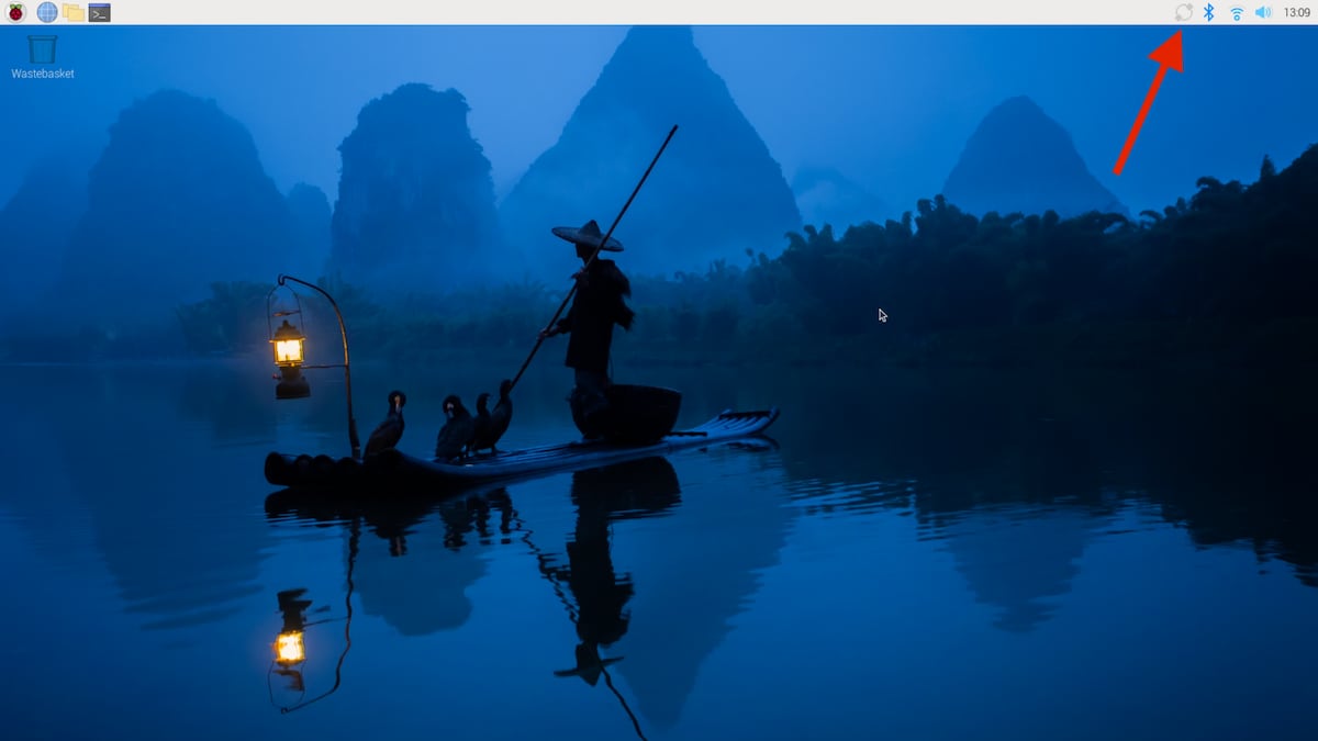

You need the 64-bit distribution of  Raspberry Pi OS Bookworm (with Wayland Window Server) to benefit from the tool. You can download this with the Raspberry Pi Imager and install it on your RPI 400, 4, or 5. If you already use the OS, you can update to the new tool. To do this, open the terminal and enter the commands “sudo apt update,” “sudo apt upgrade,” and “sudo apt install rpi-connect” in sequence. After a restart, a new taskbar icon should appear in the top right-hand corner of the screen. To get started, click on it and select “Login.”
Access Raspberry Pi Connect at the top right of the taskbar.
