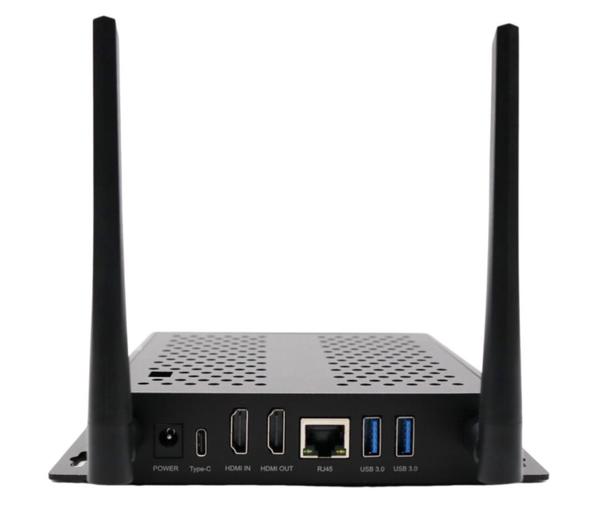

Mekotronics has launched a new hardware platform, LS1200 live streaming box, built around MTK Genio 1200 (MT8395) processor. By harnessing the computing power capabilities of the Genio chipset, the LS1200 is well-suited for live streaming applications.
LS1200 Live Streaming box
The MTK Genio 1200 targets AI workloads and feature a high-performance octa-core processor that can be clocked up to a frequency of 2.2GHz. The CPU combines 4x Arm Cortex-A78 and 4x Arm Cortex-A55 processors with a dominant frequency that provides powerful general-purpose computing capability.
The onboard graphics processor is an Arm Mali-G57 graphics engine with five cores that can handle advanced 3D graphics. All of these pair with an integrated neural processing unit (NPU) that delivers up to 4.8 TOPS performance. The power consumption of NPU is only 1% of that of GPU, and it has a very high computational power efficiency when compared to the standard large-chip GPU method used as an AI operating unit.

Specifications of LS1200 live streaming box:
  • System-on-chip: MTK Genio 1200 (MT8395) processor Octa-core CPU, Quad-core cortex-A78 at 2.2Ghz and Quad-core cortex A55 at 2.2Ghz
  • GPU: Penta-core Mali-G57@880Mhz, with support of OpenGL ES, Vulkan, Open CL
  • NPU: 4.8 TOPS with support for TensorFlow and Caffe models
  • Memory: 8GB LPDDR4
  • Storage: 64GB eMMC
  • Display:
    • Resolution supports 4096×2160
    • Display: EDP connector and touchscreen interface
    • HDMI 2.0 supports a 4K 60Hz display
  • Multimedia:
    • Support 4K 10bits h265 / H264 video decoding, up to 60fps
    • 1080p multi-format video decoding
    • 1080p video coding, supporting H.264
  • Connectivity:
    • Ethernet: G-LAN network
    • Wi-Fi: 2.4G/5G Wi-Fi and Bluetooth
  • USB- 1x USB Type-C port, 2x USB 3.0 ports, 2x USB 2.0 ports
  • Operating system: Android 11 OS
LS1200 Live Streaming box Specs
Additionally, it is capable of driving multiple 4K displays and touchscreens, as well as receiving and processing ultra-high-definition display and camera inputs. To allow full utilization of massive computing capacity, the platform comes with a plethora of interfacing and networking options to fulfill a wide range of requirements. Thus, Mekotronics offers HDMI input, HDMI output, TypeC, USB HOST x4, RJ45, Microphone, Audio, EDP, MIPI, and other interfaces, making it convenient and versatile for the development of several intelligent devices.
According to Mekotronics’ official product page, the platform “supports a range of operating systems with stable and reliable performance,” in addition to supporting the Android 11 operating system. Furthermore, the LS1200 boasts a high-quality aluminum chassis, a built-in fan, and an aluminum heat sink that work together to cool the device effectively. The platform also offers support for Wi-Fi and Bluetooth to deliver seamless connectivity.
