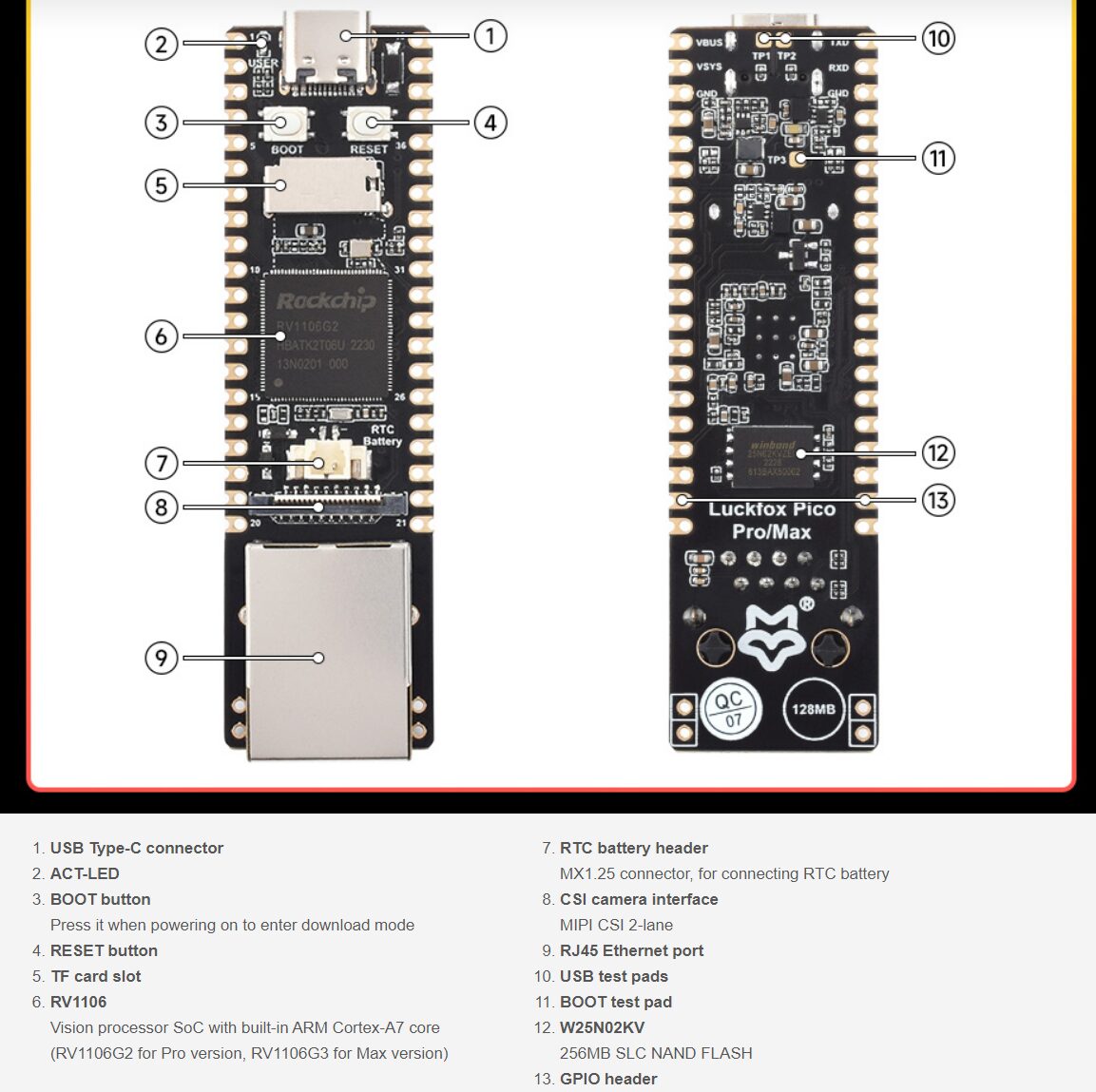

LuckFox Pico Pro and Pico Max Specifications:
  • Processor: ARM Cortex A7 @ 1.2GHz single-core.
  • NPU: 0.5 TOPS, supports int4, int8, and int16 quantization; up to 1.0 TOPS with int4 (Pico Max).
  • Memory: 128MB DDR2 (Pico Pro), 256MB DDR2 (Pico Max).
  • Storage: 256MB SPI NAND FLASH (Pico Pro), 256MB SLC NAND FLASH (Pico Max).
  • Camera Interface: MIPI CSI 2-lane.
  • Display: ISP support for 5M @ 30fps; advanced features like HDR, WDR, and noise reduction in Pico Max.
  • Network: 10/100M Ethernet controller with embedded PHY; integrated MAC PHY in Pico Max.
  • Connectivity: USB 2.0 Host/Device, USB Type-C connector, USB test pads.

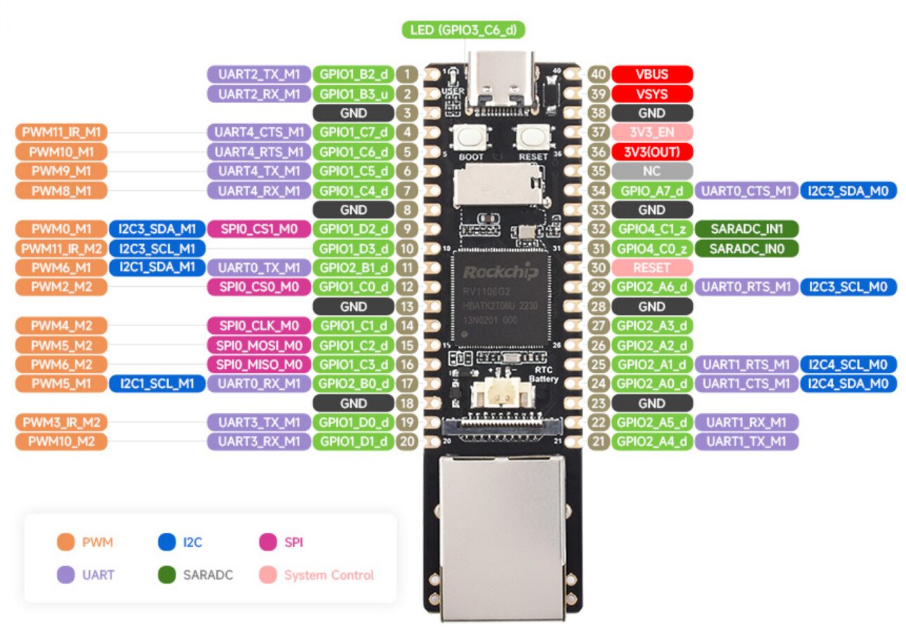

  • GPIO: 26 GPIO pins.
  • Additional Features: TF card slot, ACT-LED, BOOT and RESET buttons, RTC battery header (Pico Max).
  • SoC Variants: RV1106G2 for Pico Pro, RV1106G3 for Pico Max.
The board offers multiple connection options like a camera interface (MIPI CSI), up to 26 GPIOs, UART, SPI, I2C, and USB. It includes a 10/100M Ethernet controller with MAC PHY, a MicroSD card slot, a USB Type-C port, and a 2-lane MIPI CSI for cameras, making it versatile for various tech projects.

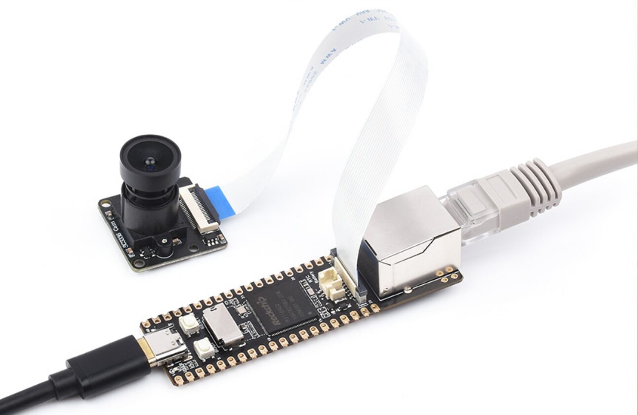

LuckFox announced their Pico Pro and Pico Max modules are compatible with the SC3336 3MP Camera, featuring a SmartSens SC3336 sensor. This camera excels in low-light conditions with its high sensitivity and excellent signal-to-noise ratio. The same camera is used in the Firefly CT36L AI Smart Camera.
