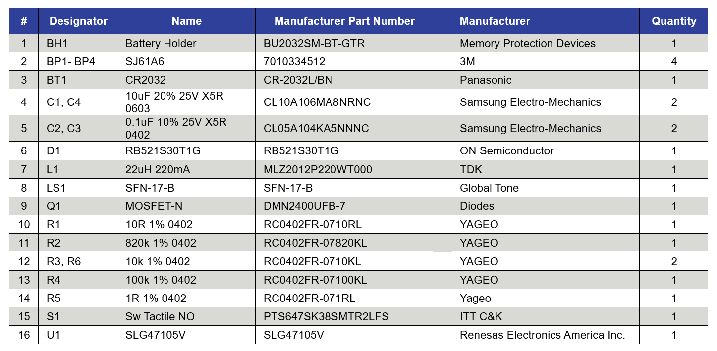

List of Materials Used to Manufacture a Boost & Buzzer Driver
