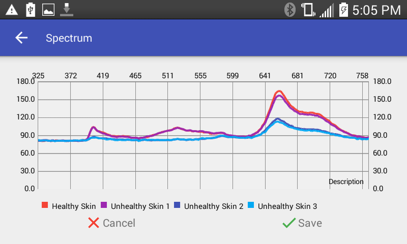

Akshat’s team tested WiSc for non-destructive testing of fruit ripeness. They collected Ultra-Violet (UV) fluorescence from Chlorophyll present in the skin of Red Delicious, McIntosh and Empire apples. Their observations were found consistent with what is measured by a penetrometer.
