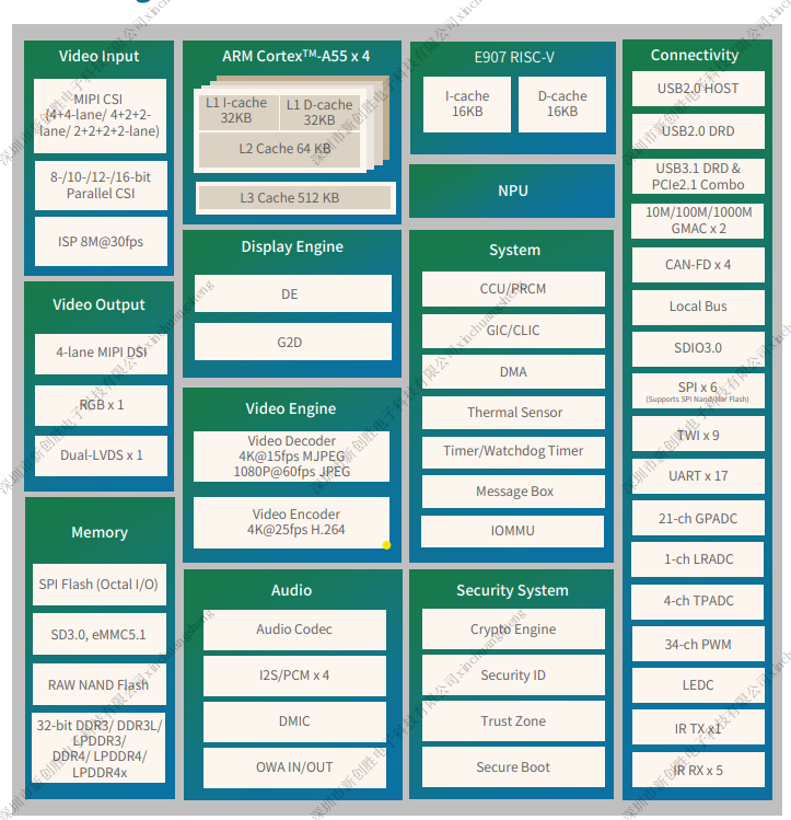

Allwinner Technology has recently released Allwinner T536 quad-core Arm Cortex-A55 & RISC-V industrial system-on-chip (SoC) designed for interactive terminals, smart manufacturing, and Edge AI devices that operate in harsh environments (-40°C to 85°C). It integrates four Cortex-A55 cores clocked up to 1.6GHz, a 600MHz E907 RISC-V core, and a low-power E902 RISC-V MCU for power management.
The main features of this SoC includes an optional NPU with up to 3 TOPS AI performance, ECC memory support (up to 6GB), dual Gigabit Ethernet, a PCIe 2.1/USB 3.1 DRD combo, MIPI DSI, RGB, and LVDS display interfaces, parallel and MIPI CSI camera interfaces, and various industrial I/Os like CAN FD, SPI, I2C, UART, ADCs, and PWM. It supports a range of storage options like SDIO 3.0, eMMC 5.1, SPI NOR/NAND, and raw NAND with ECC protection. The T536 also features a G2D hardware graphics accelerator, hardware ISP, and VPU supporting 4K video decoding and encoding. Security options include hardware encryption, hashing algorithms, RSA/ECC signatures, TRNG, and eFuse. Software support includes a Linux 5.10 SDK and RT-Thread 5.0 RTOS. It is available in four SKUs with different configurations of NPU and ECC memory support, making it suitable for industrial, AIoT, and embedded applications requiring high reliability, connectivity, and AI capabilities.
Allwinner T536 Specifications
  • CPU: Quad-core Arm Cortex-A55 up to 1.6 GHz; single-core RISC-V E907 at 600 MHz; low-power RISC-V E902 for system management
  • Graphics: G2D accelerator supporting rotation, mixing, and scaling
  • ISP: Supports resolutions up to 4800 x 4224 (offline) and 2688 x 4224 (online); frame rates of 8MP at 30fps (offline) and 5MP at 30fps (online)
  • VPU:
    • Decoding: MJPEG up to 4K@15fps, JPEG up to 1080p@60fps
    • Encoding: H.264 up to 4K@25fps, MJPEG up to 4K@15fps, JPEG up to 8K x 8K
  • NPU: Optional neural processing unit offering up to 3 TOPS
  • Memory:
    • Supports DDR3/DDR3L/LPDDR3/DDR4/LPDDR4/LPDDR4x (32-bit interface)
    • Up to 8GB RAM (non-ECC) or up to 6GB RAM (with ECC on specific models)
  • Storage Options:
    • Boot from SDIO 3.0, eMMC 5.1, SPI NOR/NAND Flash, or RAW NAND
    • ECC support for SD3.0 and eMMC5.1
    • 8-bit parallel NAND flash with up to 80-bit/1KB BCH
  • Display Interfaces:
    • MIPI-DSI (4 lanes) up to 1920×1200@60fps
    • Dual-channel LVDS up to 1920×1080@60fps
    • RGB interface up to 1920×1200@60fps
  • Camera Interfaces:
    • Parallel CSI (8/10/12/16-bit) supporting BT.656/601/1120 standards
    • MIPI CSI configurations (4+4, 4+2+2, or 2+2+2+2 lanes) up to 8MP@30fps
  • Audio Interfaces:
    • One DAC, Line-out, four I2S/PCM (up to 16 channels, 8–32-bit, 8kHz–384kHz)
    • Support for up to 8 DMICs (digital microphones)
    • One OWA input and one OWA output
  • Networking: Dual Gigabit Ethernet MACs supporting RGMII and RMII
  • USB and PCIe:
    • One USB 3.1 DRD (shared with PCIe 2.1)
    • One USB 2.0 DRD and one USB 2.0 host port
  • PCIe: PCIe 2.1 with Data Protection for ECC RAM (shared with USB 3.1)
  • Other I/Os:
    • Four CAN FD controllers
    • Seventeen UARTs, nine I2C (TWI), six SPI, thirty-four PWM channels
  • Analog Inputs: Four-channel TPADC (can double as GPADC), one LRADC, 21–31-channel GPADC
  • Infrared: Five IR receivers and one IR transmitter
  • LED Control: Integrated LED controller
  • Security Features:
    • Encryption: AES, DES, 3DES, SM4
    • Hashing: MD5, SHA, SM3
    • Signature: RSA, ECC, SM2
    • 160-bit PRNG, 256-bit TRNG, 2048-bit eFuse for security ID
  • Power Management: Managed via a dedicated Allwinner PMIC
  • Packaging: ED-FCCSP with 533 balls, dimensions 15mm x 15mm, ball pitch 0.5mm
  • Manufacturing Process: Fabricated using a 22nm ultra-low-power node
  • Operating Temperature Range: Industrial grade, -40°C to +85°C
The T536MX series is available in four SKUs with varying NPU and ECC configurations: T536MX-CEN3 features up to 3 TOPS NPU with ECC memory support, T536MX-CEN2 offers up to 2 TOPS NPU with ECC support, T536MX-CEX includes ECC support but no NPU, and T536MX-CXX comes without NPU and ECC support.
The Allwinner products page has limited information about the T536, especially regarding software. However, MYiR Tech and Forlinx have launched system-on-modules (MYC-LT536 and FET536-C) and development boards with a Linux 5.10 SDK, though it’s not publicly available. Linux 5.10 will be supported until December 2026. RT-Thread 5.0 RTOS also supports the T536, likely running on the 600 MHz E907 RISC-V core.
