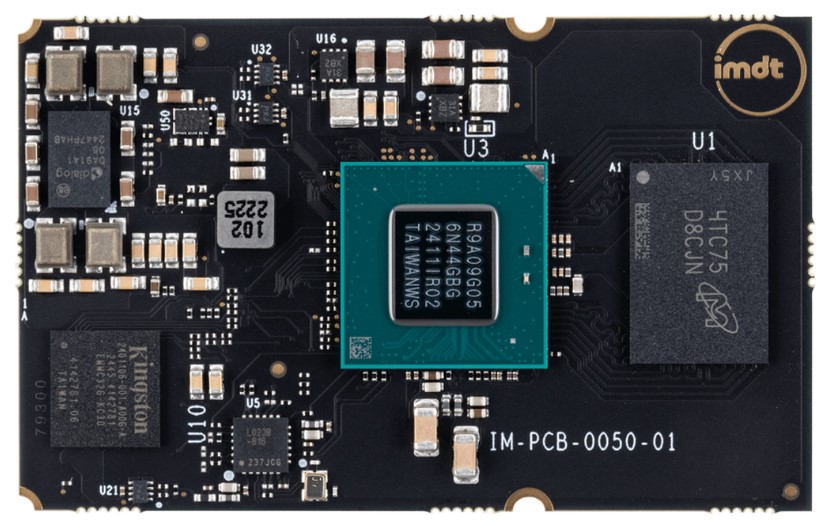

IMDT expands its Edge AI portfolio with the IMDT V2N SOM and IMDT V2N SBC, following the success of its V2H-based solutions. Powered by the Renesas RZ/V2N processor, these platforms deliver cost-effective, energy-efficient solutions for AI-driven vision applications in robotics, smart cities, industrial automation, IoT, and smart retail. The RZ/V2N features a quad-core Arm Cortex-A55 CPU running at 1.8 GHz and an integrated Renesas DRP-AI3 accelerator, ensuring optimized power consumption and affordability.
The IMDT V2N SOM comes with 8GB of RAM, 32GB of eMMC flash, and flexible storage options, including 64MB QSPI NOR flash, secure EEPROM, and a microSD card slot. It supports multiple interfaces via B2B connectors, such as two 4-lane MIPI CSI-2 interfaces and an MIPI DSI display interface, enabling seamless integration into AI vision applications.

IMDT V2N SoM

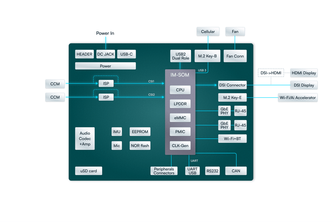

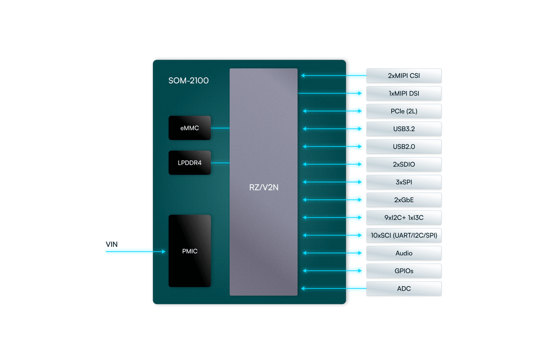

IMDT V2N SoM block diagram

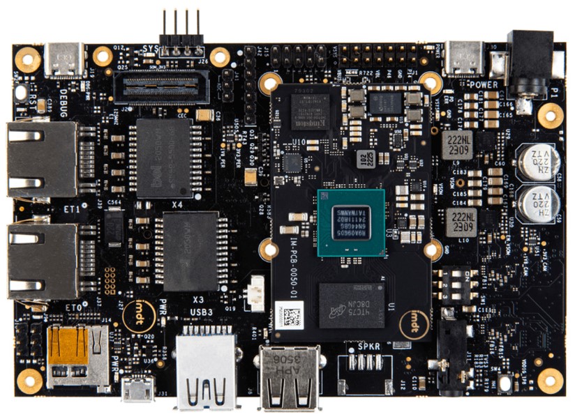

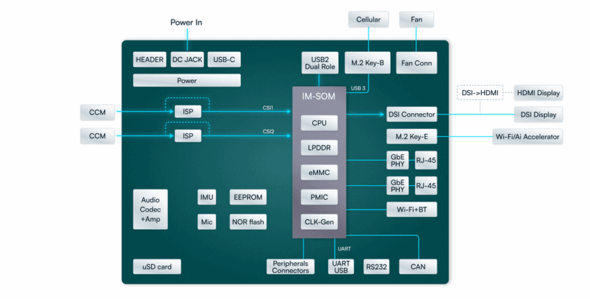

The IMDT V2N SBC transforms the V2N SOM into a highly integrated, compact mini-computer, ideal for rapid AI application development.
IMDT V2N SBC block diagram
IMDT has not provided details on software support for the V2N SoM and SBC. However, since both platforms are built on the Renesas RZ/V2N processor, they are likely to support the Verified Linux Package, DRP-AI Translator for AI model conversion, and GPU-accelerated rendering via RZ MPU Graphics and Video Codec libraries.
The IMDT V2N SBC is available as a kit, including two USB-C to USB-C cables for power and debugging, a full-HD USB camera, and two AR1335 MIPI cameras. The package also includes a 35W USB-C PD wall adapter with foldable US prongs and replaceable EU and UK plugs, along with an antenna for wireless connectivity. Optional accessories include a DSI-to-HDMI adapter and an HDMI cable for display output.
IMDT V2N SBC
IMDT V2N SBC
