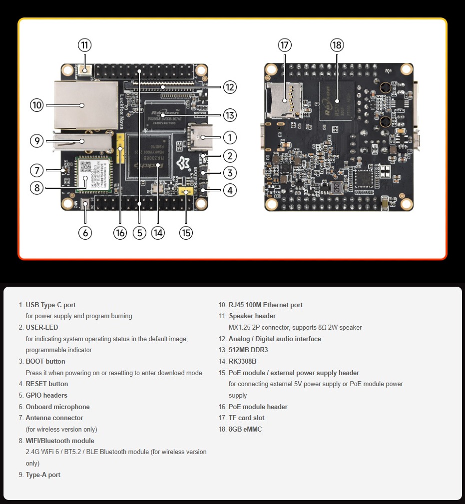

The Luckfox Nova is an embedded development board powered by the Rockchip RK3308B processor. This SoC features a 64-bit quad-core ARM Cortex-A35 CPU running at up to 1.3GHz, designed for smart voice interaction, audio signal processing, and multimedia applications. It integrates a high-performance Audio Codec and Voice Activity Detection (VAD) module for low-power voice wake-up and multi-channel audio input.

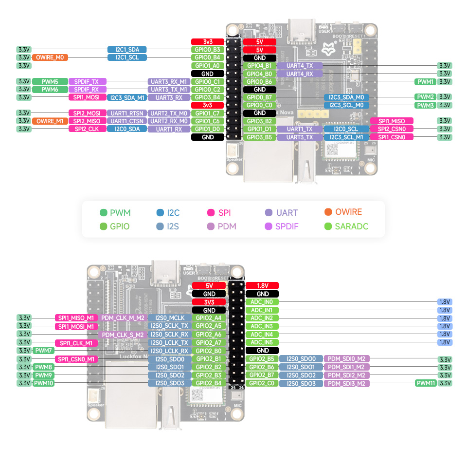

The board includes a built-in Audio Codec that supports up to 8-channel microphone input, making it suitable for far-field voice capture and microphone array development. It provides two 26-pin GPIO headers with support for UART, SPI, I2C, and other standard interfaces, allowing flexible peripheral control.
Storage options include 8GB of onboard eMMC and a microSD card slot supporting SDIO 3.0 for additional storage. The system is equipped with 512MB DDR3 memory, enabling efficient handling of lightweight multi-tasking applications. These features make the Luckfox Nova a practical solution for embedded systems involving voice control, audio pre-processing, and related use cases.
Luckfox Nova Micro Rockchip RK3308B Development Board
Luckfox Nova Micro development board specifications:
  • Processor: Rockchip RK3308B
    • CPU: Quad-core 64-bit ARM Cortex-A35, up to 1.3GHz
    • Integrated high-performance Audio Codec
    • Integrated Voice Activity Detection (VAD)
  • Memory and Storage:
    • 512MB DDR3 RAM
    • 8GB onboard eMMC
    • MicroSD card slot (supports SDIO 3.0) for storage expansion
  • Audio:
    • Built-in Audio Codec with up to 8-channel mic input
    • Onboard microphone
    • Analog/digital audio interfaces
    • MX1.25 2P speaker header (supports 8Ω 2W speaker)
  • Wireless (optional):
    • 2.4GHz Wi-Fi 6
    • Bluetooth 5.2 / BLE
    • Antenna connector (for wireless version only)
  • Networking:
    • RJ45 100M Ethernet port
    • Reserved PoE module header (optional PoE module supports power + data via a single cable)
  • USB:
    • 1x USB Device (Type-C)
    • 1x USB 2.0 Host
  • Expansion: 2 x 26-pin GPIO headers with UART, SPI, I2C, and other signals
  • Misc:
    • BOOT button for entering download mode
    • RESET button
    • USER-LED (programmable system status indicator)
  • Power:
    • USB Type-C input
    • External 5V header
    • Optional PoE power input

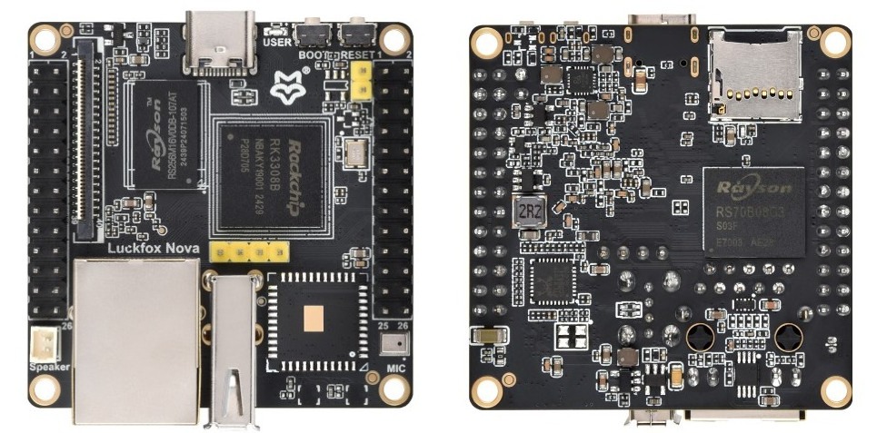

Luckfox Nova Micro Rockchip RK3308B Development Board specifications
Last month, we covered the Luckfox Lyra Ultra, a Linux-based micro development board powered by the Rockchip RK3506B processor. The Lyra series supports both the Buildroot build system and Ubuntu 22.04. In contrast, the company has not yet specified the supported operating system for the Luckfox Nova. While documentation is available on the Luckfox Wiki, it currently provides fewer details compared to previous products.
The Luckfox Nova is available in four versions: the standard base model, the Nova W with Wi-Fi support, the PoE Kit with Ethernet-based power delivery, and the Nova W PoE Kit, which combines both Wi-Fi and PoE functionality.
