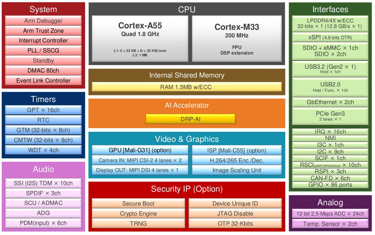

SOMDEVICES has introduced the µSMARC RZ/V2N, a compact System-on-Module (SoM) based on the Renesas RZ/V2N processor. It follows the micro SMARC (µSMARC) form factor, measuring 82x30mm—significantly smaller than the standard 82x50mm SMARC modules.
The µSMARC RZ/V2N integrates a quad-core ARM Cortex-A55 CPU, an ARM Cortex-M33 microcontroller, and an NPU delivering up to 15 TOPS. It supports up to 8GB LPDDR4 RAM and up to 128GB eMMC flash storage and includes two Gigabit Ethernet PHYs. Additionally, an optional Wi-Fi 5 and Bluetooth 5.1 wireless module is available.
RZV2N Block Diagram
RZV2N Block Diagram
SOMDEVICES μSMARC RZ/V2N specifications:
  • SoC: Renesas RZ/V2N
    • CPU:
      • Quad-core Arm Cortex-A55 @ 1.8 GHz
      • Arm Cortex-M33 @ 200 MHz
    • GPU: Arm Mali-G31 GE3D with OpenGL ES 3.2, OpenCL 2.0 FP
    • VPU: H.264/H.265 hardware encode & decode
      • H.264: Up to 1920×1080 @ 60 fps (SOMDEVICES mentions up to 4K @ 30 fps)
      • H.265: Up to 3840×2160 @ 30 fps
    • AI Accelerator: DRP-AI NPU Up to 4 dense TOPS / 15 sparse TOPS
  • Memory and Storage:
    • 512MB to 8GB LPDDR4 RAM
    • 4GB to 128GB eMMC flash
    • SDIO support via 314-pin MXM 3.0 connector
  • Networking:
    • 2x Gigabit Ethernet PHY
    • Optional Wi-Fi 5 (802.11a/b/g/n/ac) and Bluetooth 5.1 module
  • Display:
    • 4-lane MIPI DSI
    • Optional dual-channel LVDS via DSI-to-LVDS bridge
  • Camera:
    • 2x 4-lane MIPI CSI-2
    • Mali-C55 Image Signal Processor
  • Audio: 1x I2S
  • USB:
    • 1x USB 2.0 OTG
    • 1x USB 3.2 Host
  • Expansions:
    • PCIe: 2-lane PCIe interface
    • Low-Speed I/Os:
      • 2x CAN Bus
      • 3x I2C, 1x SPI
      • 3x UART (2x with flow control, 1x 2-wire)
      • 13x GPIOs, up to 3x PWM
  • Power: 5V DC input; onboard PMIC
  • Dimensions: 82 x 30 mm (µSMARC)
  • Temperature Range: -40ºC to 85ºC
  • Humidity: 93% relative Humidity at 40ºC, non-condensing (IEC 60068-2-78)
