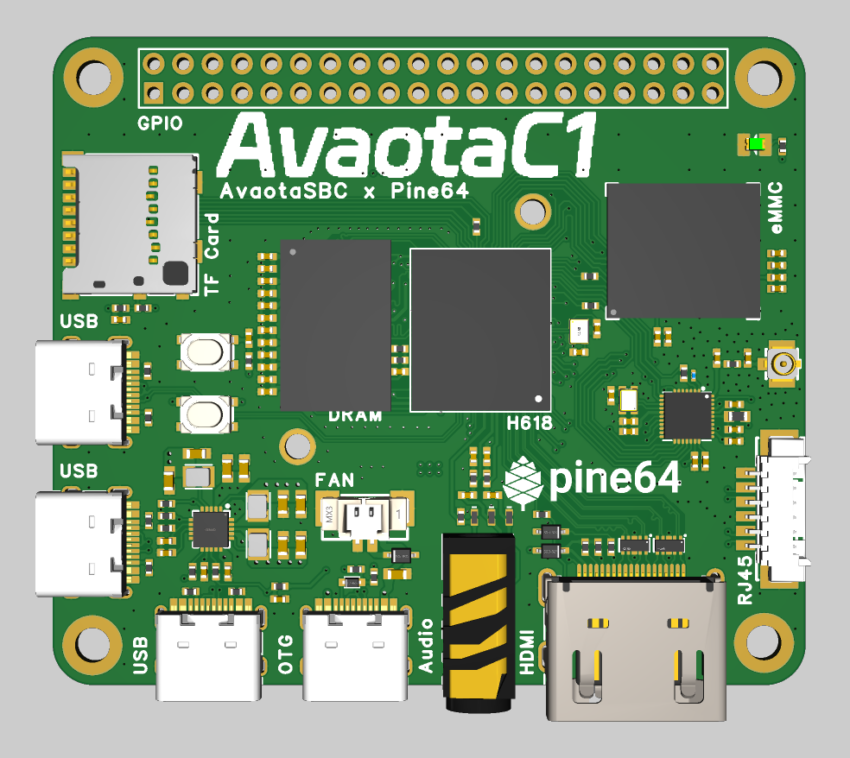

Avaota C1 Development Board is the upcoming single-board computer (SBC) in the AvaotaSBC family having Raspberry Pi A form factor designed for flexible and scalable DIY electronics and embedded system projects. Powered by an ARM-based Allwinner H618 SoC, C1 Development Board is a variant of the Yuzuki Chameleon. It provides extensive connectivity for various sensors and actuators whilst supporting high-resolution video output at fairly high refresh rate, making it ideal for embedded development, image and audio processing, smart devices, IoT applications, and prototyping.

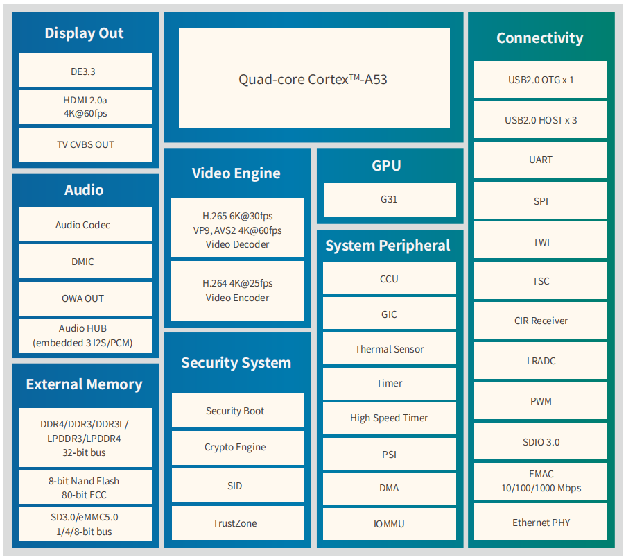

The Avaota C1 features a quad-core ARM Cortex-A53 CPU with 64-bit architecture and a multi-core Mali G31 GPU. The SBC can output 4K video at 60 fps via its HDMI interface and also supports SPI display connections. The board also supports low-latency 4K H.264 encoding at 25 frames per second and is compatible with HDR10 and HLG. Image quality is enhanced with Allwinner’s SmartColor 3.3 picture engine. Wireless connectivity is provided by the onboard AIC8800DC W-Fi cum Bluetooth chip. Based on the watermark on the SBC, C1 device appears to be a collaboration between Avaota and Pine64.
Avaota C1 SBC
