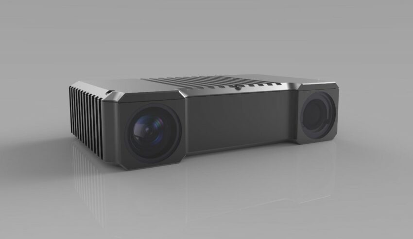

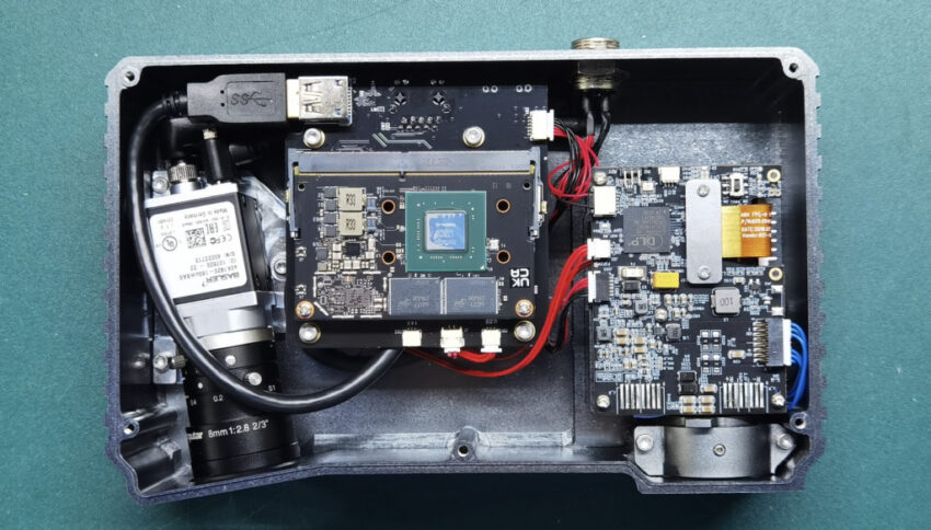

To address this, DexForce, a computer vision company based in China, has released its first open-source 3D industrial depth-sensing camera named Xema. Xema is powered by the NVIDIA Jetson Nano module and claims to offer an accuracy of 50 microns, with the ability to handle on-device deep-learning workloads. The company explained that they wanted to create something of low cost which can also function like the current generation industrial cameras. The low-cost, high-accuracy industrial-grade 3D depth-sensing camera is one that adopts an advanced active stripe structured light technology.

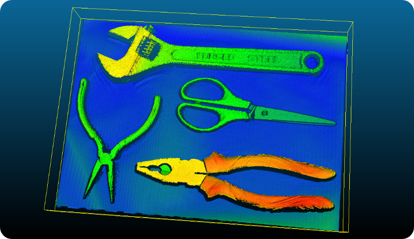

“This camera can be used in scenarios such as bin-picking, assembly, 3D inspection and many others. It is also a computer with GPU computing capability, which makes running 3D point cloud recognition algorithms and robotic arm control programs possible,” DexForce further explains.

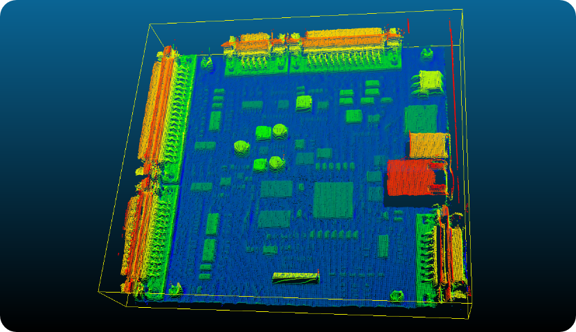

The camera outputs fast imaging speed, strong anti-ambient light capability, accurate depth capture information as well as high resolution and precision point clouds of various objects. Other features of the Xema Industrial Camera Include DLP projector and a CMOS camera sensor.
