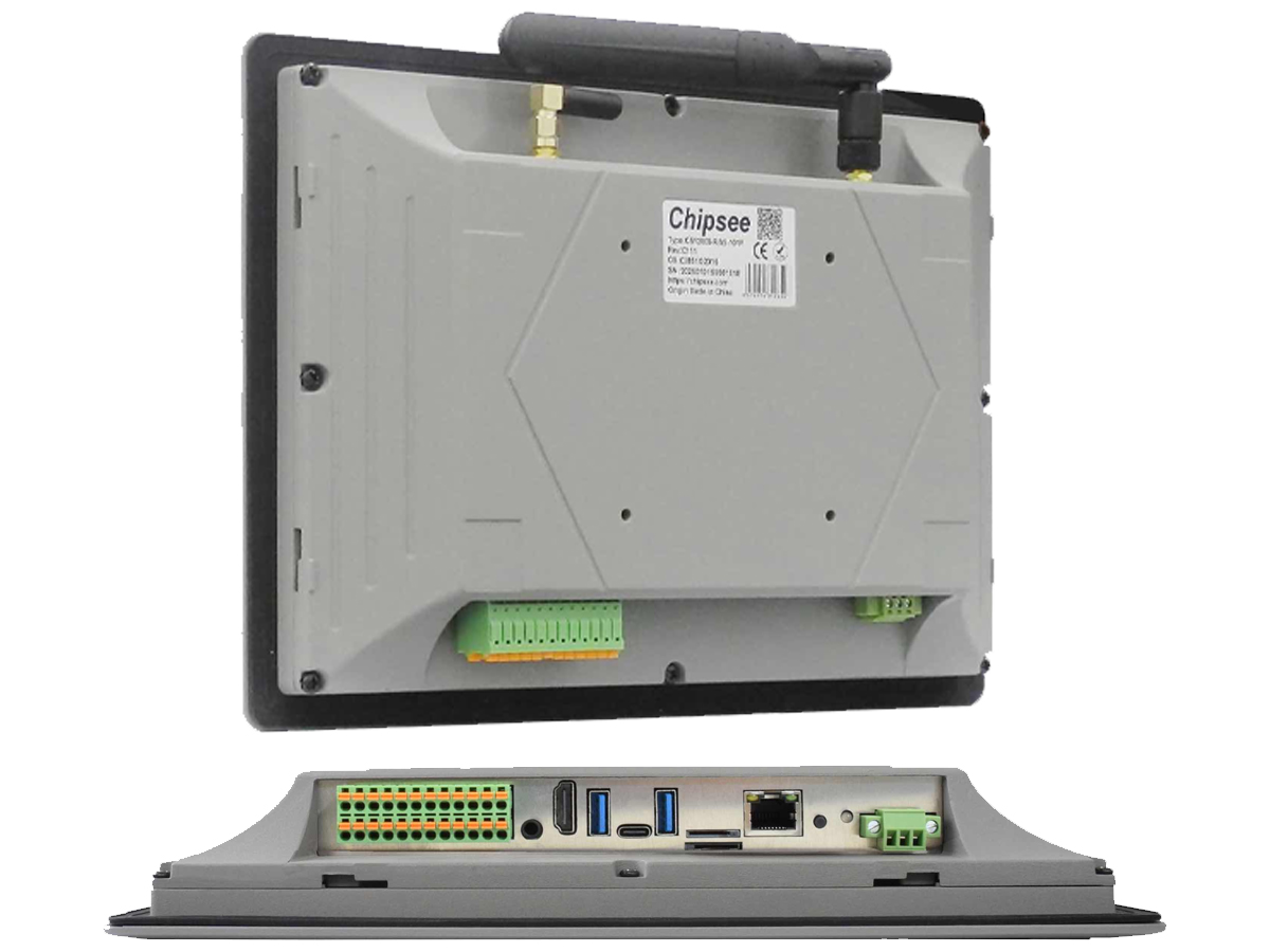

Both models offer connectivity options including Gigabit LAN, USB 3.0 ports, HDMI 2.0 (supports 4K 60FPS), RS232, RS485, CAN FD, and GPIO, with optional WiFi, Bluetooth, and 3G/4G/LTE modules. The devices support PCIe Gen 2 x1 via an M.2 M-Key socket for NVMe SSD expansion. Power input varies, with EPC/PPC-CM5-070 supporting 9V-30V DC and PPC-CM5-101 supporting 15V-30V DC.
They are designed for industrial environments, these rugged PCs come with embedded and VESA mounting options, making them ideal for integration into control cabinets, automotive systems, ATMs, and other industrial applications.

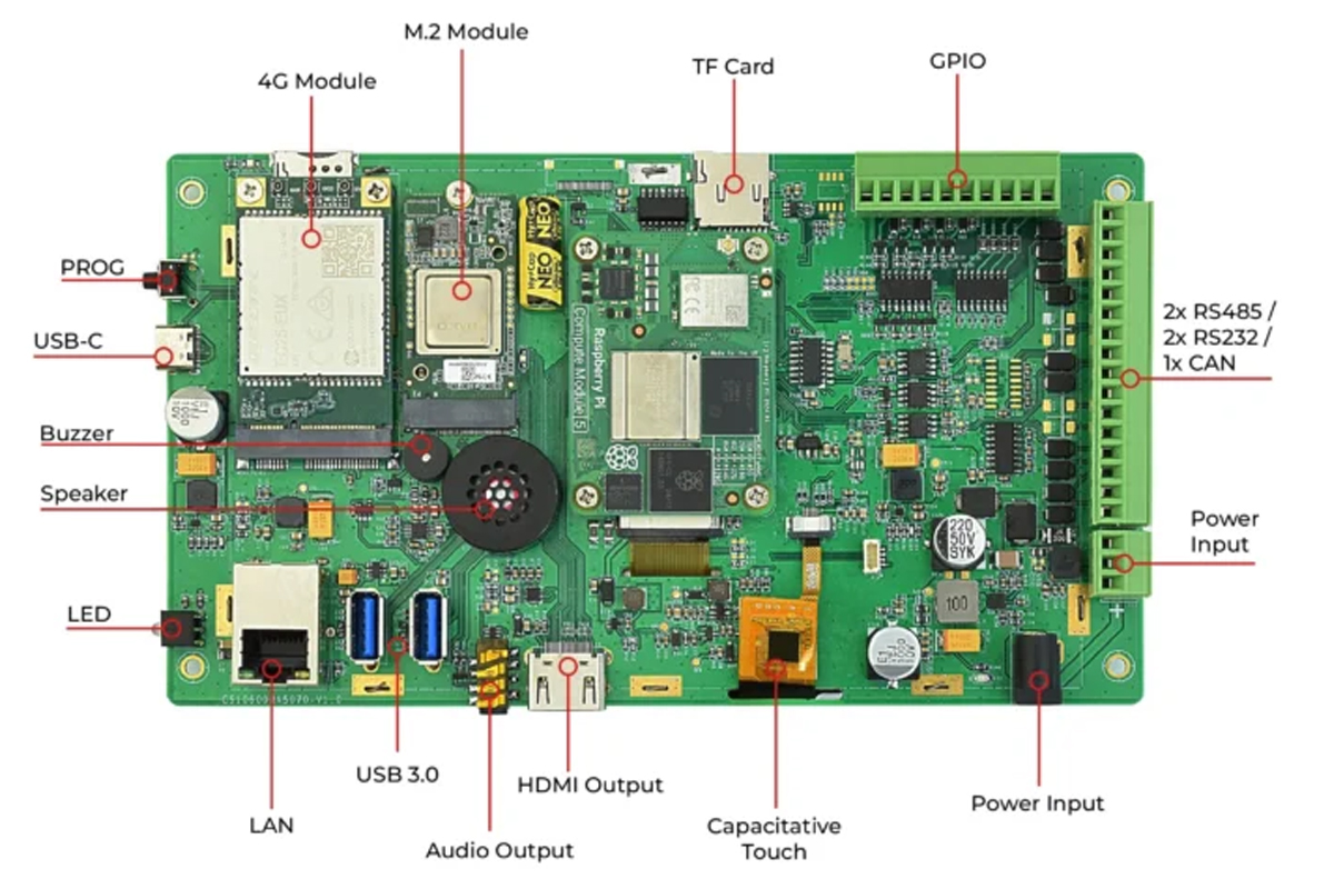

Chipsee EPC/PPC-CM5-070 Industrial PC with Raspberry Pi CM5 Specifications:
  • SoC: Broadcom BCM2712 quad-core Cortex-A76 @ 2.4GHz
  • Module: Raspberry Pi Compute Module 5 (CM5/CM5Lite)
  • Memory: 2GB, 4GB, or 8GB LPDDR4X SDRAM (depends on CM5 variant)
  • Storage:
    • eMMC: 0GB, 16GB, 32GB, or 64GB (depends on CM5 variant)
    • 1x microSD card slot (only for CM5 Lite, cannot be used as external storage)
    • PCIe M.2 M-Key 2230/2242 slot for NVMe SSD (not mounted by default)
  • Display:
    • 7-inch IPS LCD, 1024 × 600 resolution
    • 500 cd/m² brightness
    • 5-point capacitive touch with 1mm armored glass
  • Connectivity:
    • 1x Gigabit Ethernet (RJ45)
    • Optional WiFi 5 / Bluetooth 5.0 (depends on CM5 variant)
    • Optional 4G LTE mini PCIe module with SIM card slot
  • I/O Interfaces:
    • 2x RS232 (expandable to 4x RS232)
    • 2x RS485 (configurable as 2x RS232)
    • 1x CAN FD Bus (1Mbps arbitration, 8Mbps data rate)
  • Video: 1x HDMI 2.0 output (up to 4K 60Hz)
  • Audio:
    • 3.5mm audio out
    • 2W internal speaker
    • Onboard buzzer (GPIO controlled)
  • Expansion:
    • 1x PCIe Gen 2 (5Gbps)
    • M.2 M-Key 2230/2242 slot (PCIe 3.0 possible but experimental on CM5)
    • 8x GPIO (4 input, 4 output)
  • USB:
    • 2x USB 3.0 Type-A Host
    • 1x USB Type-C OTG
  • Misc:
    • High-accuracy RTC (runs up to 1 week after power off)
    • Optional 3G/4G/LTE module (not mounted by default)
    • Camera support (not mounted by default, available on embedded variant)
  • Power Supply:
    • 9V to 30V DC input
    • Max current: 950mA @ 12V, typical: 500mA @ 12V
    • Max power consumption: 11.4W, typical: 6W
  • Dimensions:
    • Embedded version (EPC-CM5-070): 190 × 107.8 × 27.7 mm
    • Panel mount version (PPC-CM5-070): 206 × 135 × 30 mm
  • Weight:
    • Embedded version (EPC-CM5-070): 400g
    • Panel mount version (PPC-CM5-070): 700g
  • Mounting Options:
    • Embedded (EPC-CM5-070)
    • Panel mount / VESA (PPC-CM5-070)
  • Operating Temperature: -10°C to +60°C
