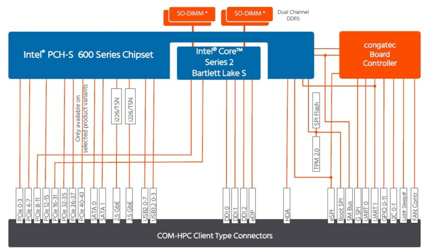

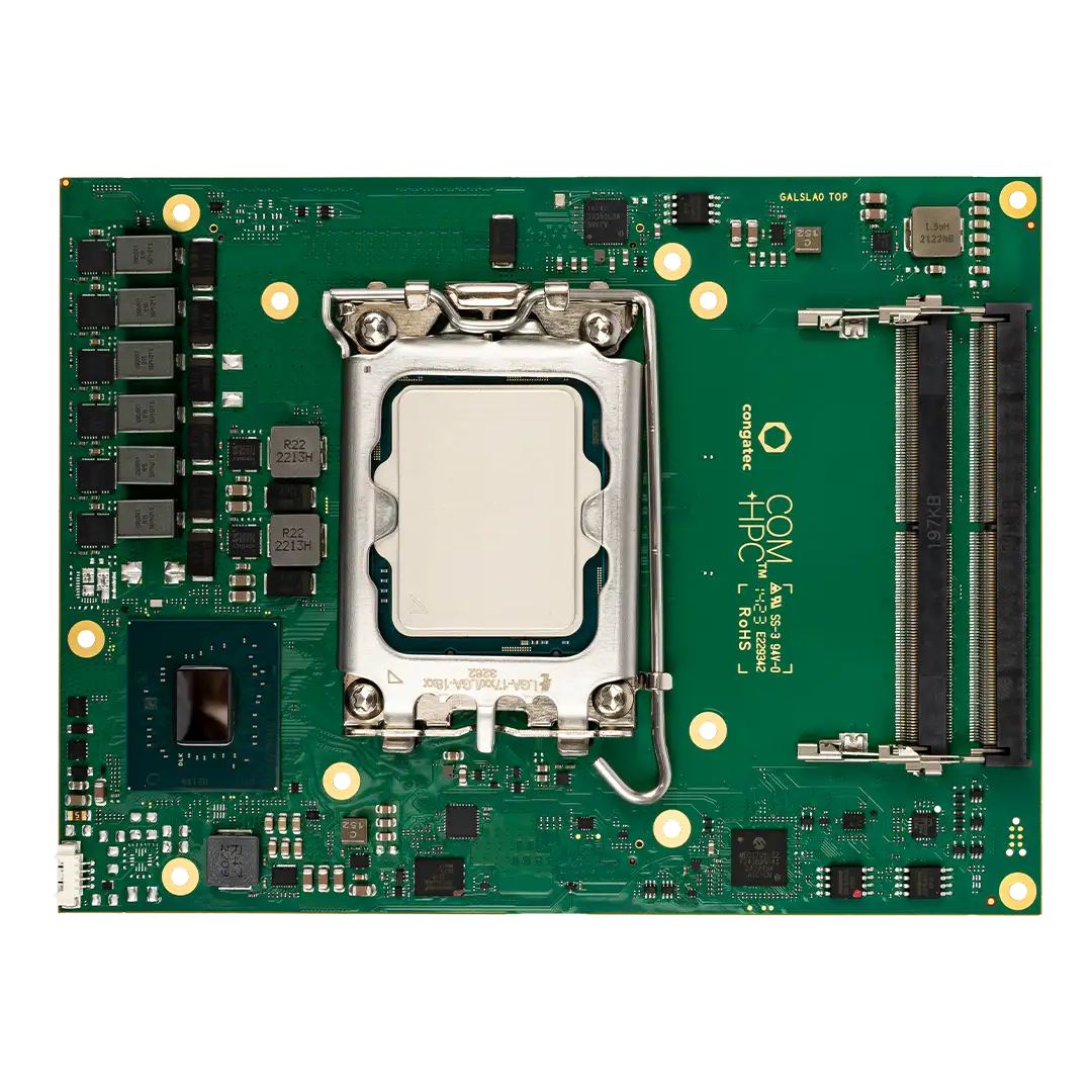

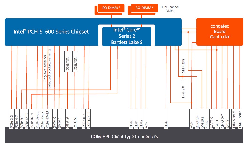

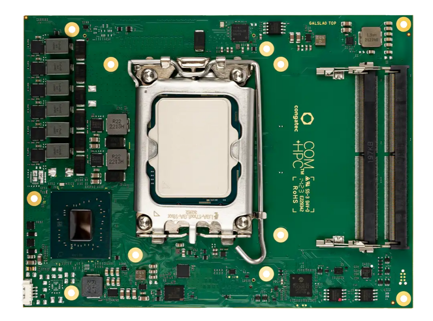

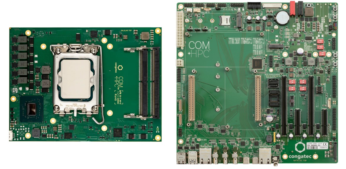

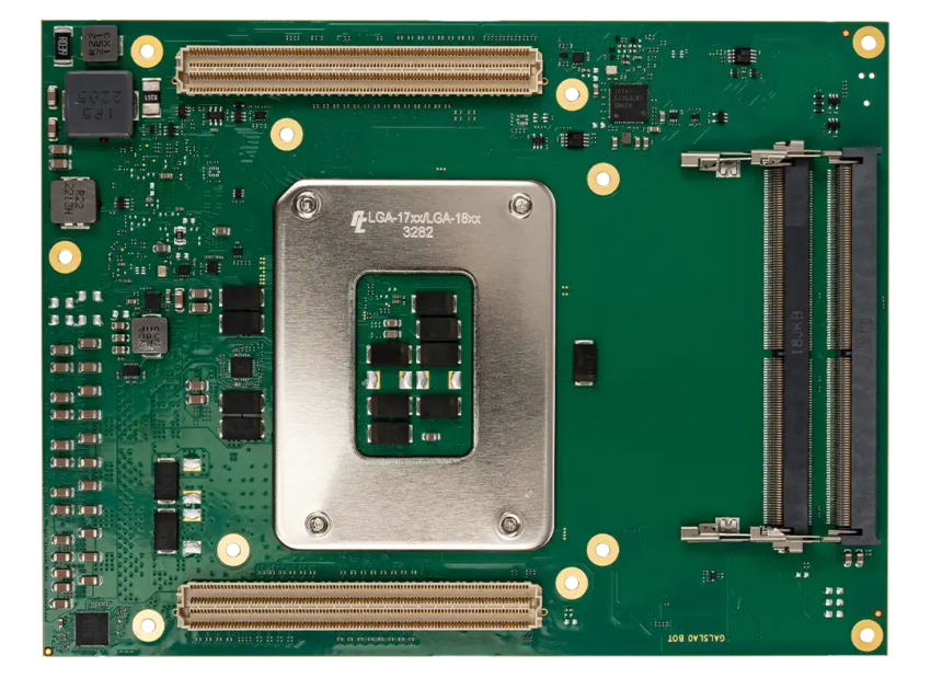

Germany’s Congatec has introduced the conga-HPC/cBLS, a high-performance COM-HPC Computer-on-Module (COM) powered by Intel Core S-Series processors (codenamed Bartlett Lake S). This new addition to Congatec’s COM-HPC COM portfolio targets edge and real-time applications with demanding computing needs, such as healthcare, and offers advanced features like AI inference support.
conga-HPC-cBLS COM-HPC COM frontThe COM-HPC Client Size C module, measuring 120 x 160 mm, leverages the hybrid performance architecture of Intel Core S processors (codenamed Bartlett Lake S). It features up to 16 Efficient (E) cores and 8 Performance (P) cores, supporting a total of 32 threads. The module offers up to 42 PCIe lanes, including 16 lanes with PCIe Gen 5 and up to 12 lanes with PCIe Gen 4. Integrated Intel Graphics, equipped with up to 32 execution units, support edge AI inference, while fast DDR5-4000 memory with ECC ensures reliability for data-critical applications.
Congatec conga-HPC/cBLS specifications:
  • Processor:
    • Intel Core 3 201E: Quad-core with 4x P-cores clocked at 3.6 GHz / 4.8 GHz (Turbo), 12MB cache, 24 EU Intel UHD Graphics 770, PBP: 60W
    • Intel Core 5 211E: 10-core with 6x P-cores @ 2.7 GHz / 4.9 GHz (Turbo), 4x E-cores @ 2.0 GHz / 3.7 GHz (Turbo), 20MB cache, 24 EU Intel UHD Graphics 770, PBP: 65W
    • Intel Core 7 251E: 24-core with 8x P-cores @ 2.1 GHz / 5.6 GHz (Turbo), 16x E-cores @ 1.6 GHz / 4.4 GHz (Turbo), 36MB cache, 32 EU Intel Xe Architecture UHD Graphics 770, PBP: 65W
  • Chipset: Bartlett Lake-S SoC with R680E or Q670E
  • Memory:
    • 4x SO-DIMM sockets supporting DDR5 modules up to 32 GB each
    • Maximum capacity of 128 GB RAM
  • Storage:
    • 32Mb SPI Flash for AMI BIOS
    • 2x SATA ports
  • Networking: Dual 2.5 GbE ports with TSN support via Intel i226 Ethernet controller series
  • Display Support: 3x DDI (DisplayPort/HDMI) and eDP (embedded DisplayPort)
  • USB:
    • 4x USB 3.2 Gen2x2 ports
    • 4x USB 2.0 ports
  • PCIe Expansion:
    • PCIe Gen 5 x16 PEG port
    • 3x PCIe Gen 4 (x4 lanes)
    • Up to 3x PCIe Gen 3 (x4 lanes)
    • 1x PCIe Gen 3 (x2 lanes)
  • I/O and Expansion:
    • 2x 400-pin connectors for low-speed I/Os
    • 2x UART, 12x GPIOs
  • Integrated Intel Graphics: Up to 32 execution units (UHD Graphics 770 or Xe Architecture)
  • Embedded Controller Features:
    • Congatec Board Controller
    • Multi-stage watchdog, non-volatile user data storage
    • Board statistics, manufacturing, and hardware health monitoring
    • I²C bus (fast mode, 400 kHz, multi-master)
  • BIOS Features:
    • LCD control, display auto-detection, backlight control
    • Flash update support
  • Security: Trusted Platform Module (TPM 2.0)
  • Power Management: ACPI 5.0a with battery support
  • Operating Conditions:
    • Temperature: 0°C to 60°C (operating), -20°C to 80°C (storage)
    • Humidity: 10% to 85% r.H. (operating), 5% to 85% r.H. (storage)
  • Dimensions: 160 x 120 mm (COM-HPC Client Size C)

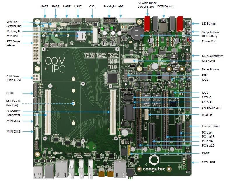

conga-HPC/uATX-Client specifications:
  • Board Type: Micro-ATX carrier board supporting COM-HPC Client Type Modules (Sizes A, B, C)
  • Display Options:
    • 1x eDP (optional for LVDS)
    • 3x DP++ with 8.1 Gbps re-driver
  • Audio:
    • 1x 4-pin audio jack with on-carrier HDA codec
    • 1x DMIC header
    • 1x I2S/SoundWire header
  • Networking: 2x 10GbE RJ45 LAN ports with IEEE1588 support
  • USB Interfaces:
    • 1x Dual USB 2.0 port
    • 2x Dual USB 3.2 Gen2 (up to 10Gbps)
    • 2x USB 4.0 with Thunderbolt Retimer (1x supports Power Delivery)
  • Expansion Slots:
    • 1x 24-pin ATX power connector
    • 2x PCIe Gen4 x16 slots
    • 2x PCIe Gen4 x4 slots
    • 2x SATA III connectors
    • 1x 2.5-inch disk drive power connector
    • 1x M.2 Key B (2242/3042/2260/2280; USB2, PCIe x2, SIM)
    • 1x M.2 Key E (2230/3030; USB2, PCIe x2)
    • 1x M.2 Key M (2242/2260/2280/22110; PCIe x4, bottom side)
  • Camera and I/O:
    • 2x MIPI CSI2/3 4-lane camera FFC connectors
    • 2x UART (native by module)
    • 2x UART (via Super I/O)
    • 1x General Purpose SPI
    • 2x I2C headers
    • 1x SMB header
    • 12x GPIO pins via header
    • 1x Feature header with system control signals
    • 1x Intel ISP header
  • Miscellaneous:
    • 1x System fan connector
    • 1x CPU fan connector
    • 1x RTC CMOS battery holder
    • Buttons: Power, Reset, LID, and Sleep
    • 1x SPI boot flash socket
  • Power Supply:
    • 1x AT banana power jack (8-20V)
    • Supports ACPI 6.0 Power Management
  • Temperature Range:
    • Operating: 0°C to +60°C
    • Storage: -20°C to +80°C
  • Humidity:
    • Operating: 10–85% RH (non-condensing)
    • Storage: 5–85% RH (non-condensing)
  • Dimensions: 244 mm x 244 mm
