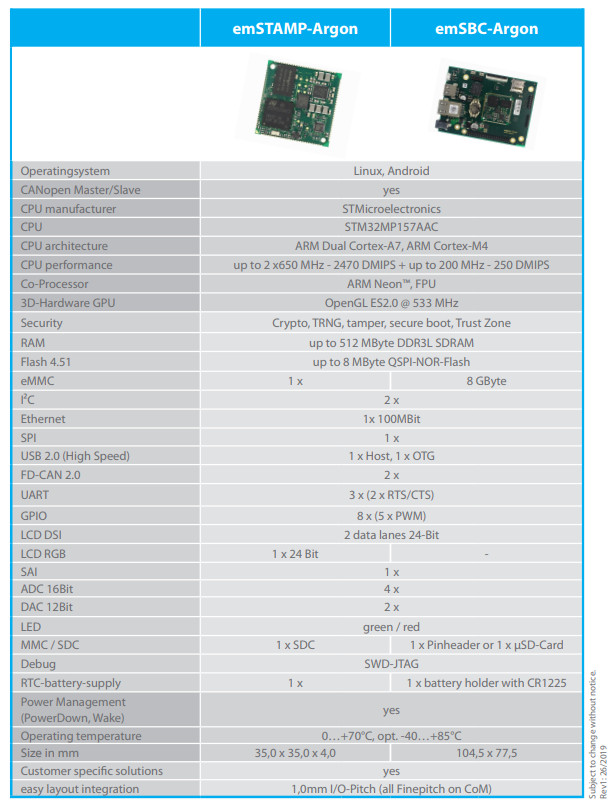

Fast-forward to today, Emtrion has recently launched the Emtrion emSBC-Argon, a single board computer that is based on the STM32MP1 microprocessor that is packed in the Emtrion’s emSTAMP-Argon module. The emSTAMP-Argon module combines a pair of 650MHz Cortex-A7 cores with a 209MHz Cortex-M4 measuring only 35 x 35 x 4mm. The Emtrion emSBC-Argon SBC integrates the emSTAMP-Argon module using an edge-castellated “stamp hole” interface.
emSBC argon with ST STM32MP1
The emSTAMP-Argon module is available in two variant; STM32MP157A and STM32MP157C models. Both models include a Vivante 3D GPU that supports OpenGL ES 2.0, adds dual FD-CAN support, a WXGA resolution (1280 x 800) at 60fps video. The STM32MP157C goes a step ahead by adding a hardware crypto chip with TRNG, tamper, secure boot, and TrustZone support.
Key features
  • STM32MP157AAC processor from STMicroelectronics
  • ARM Dual Cortex-A7 @ 650MHz – 2470 DMIPS
  • ARM Cortex-M4 @ 200MHz – 250 DMIPS
  • Co-processor: ARM Neon ™, FPU, and 3D GPU
  • Operating system: Linux or Android
  • Virtualization capable (Jailhouse)
  • up to 512 MB DDR3L SDRAM
  • 8GByte (up to 64 GB) eMMC Flash
  • Up to 8 MB of QSPI-NOR-Flash
  • 2 x FD-CAN 2.0
  • Size: 104.5 x 77.5 mm
