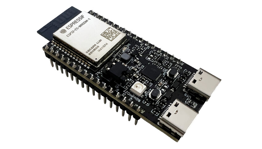

Previously, we wrote about the Espressif ESP32-C5 Test Board. On April 30, the company officially announced the start of mass production. In this article, we’ll take a closer look at the ESP32-C5-DevKitC-1 board, which comes with some changes compared to the earlier version.

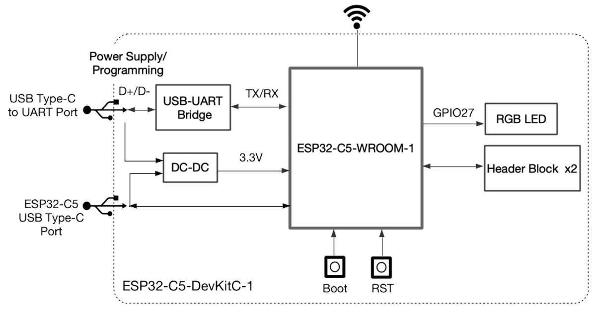

Block diagram

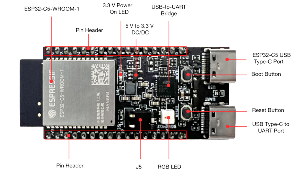

ESP32-C5-DevKitC-1 specifications:
  • Module: ESP32-C5-WROOM-1
    • SOC:  ESP32-C5
      • CPU:
        • Single-core 32-bit RISC-V processor @ 240 MHz
        • Low-power RISC-V core @ 40 MHz
      • Memory: 384 KB On-chip SRAM
      • Storage: 320 KB ROM
    • Connectivity:
      • Dual-band Wi-Fi 6 (802.11ax) – 2.4 GHz and 5 GHz
      • Bluetooth 5 (LE)
      • Zigbee and Thread (802.15.4)
      • Onboard PCB antenna
    • Memory: 8MB PSRAM
    • Storage: 4MB SPI flash
  • USB:
    • USB Type-C port (ESP32-C5) for power, flashing, communication, and JTAG (USB 2.0 Full Speed – up to 12 Mbps)
    • USB Type-C to UART port via on-board USB-to-UART bridge (up to 3 Mbps)
  • I/Os:
    • 2x 16-pin GPIOs (except SPI for flash) are broken out to 2x pin headers for breadboard compatibility
  • Misc:
    •  LED:
      • Power LED (3.3V)
      • RGB LED connected to GPIO27
    • Buttons:
      • Boot button (for entering download mode)
      • Reset button
    • J5 header for current measurement
  • Power Supply Options:
    • USB Type-C ports (recommended)
    • 5V and GND pin headers
    • 3.3V and GND pin headers
    • Onboard 5V to 3.3V DC/DC regulator
  • Dimensions: 51.8 x 25.5 mm

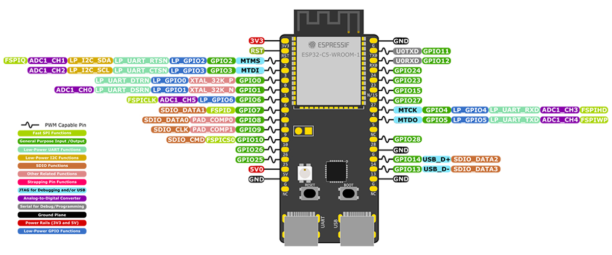

ESP32-C5-DevKitC-1 pinout
The ESP32-C5-DevKitC-1 is quite similar to the ESP32-C6-DevKitC-1, but it uses the ESP32-C5-WROOM-1 module featuring dual-band Wi-Fi 6. Official support for the ESP32-C5 SoC, WROOM modules, and the devkit is expected in the upcoming ESP-IDF v5.5 release. Arduino support may follow later. Setup instructions are available on the documentation page.
