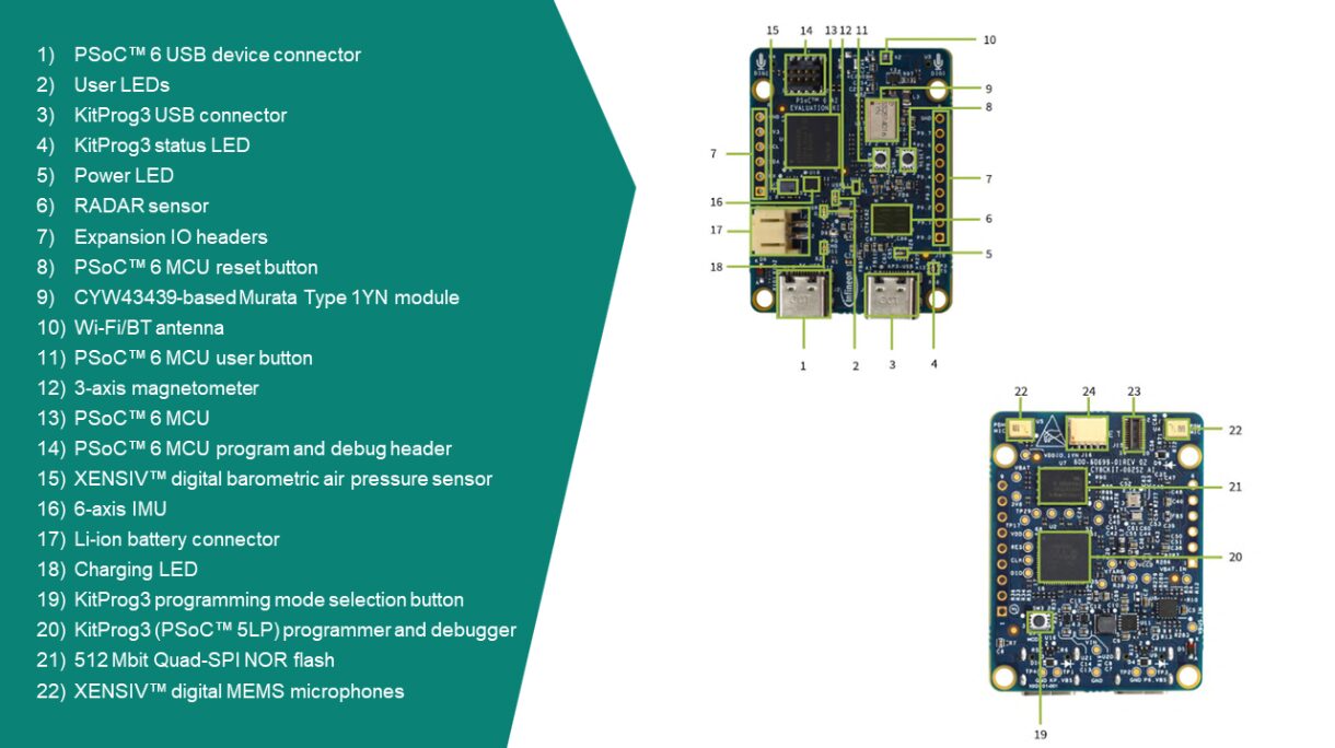

Infineon CY8CKIT-062S2-AI Dev Kit is a PSoC 62S2 MCU-powered development board built to create and test edge AI applications. The unique aspect of this board is that it features a plethora of sensors including a microphone, radar, IMU, magnetometer, and an air pressure sensor which can be configured to get environmental data, and with the help of a prebuilt AI model that data can be processed very easily.
In terms of connectivity the board has Wi-Fi and Bluetooth connectivity and complementing that is an additional expansion header that can be used to connect extra sensors and modules. This feature with an AI-compatible processor makes this device useful for applications like industrial monitoring, wearables, healthcare devices, robotics, and more.

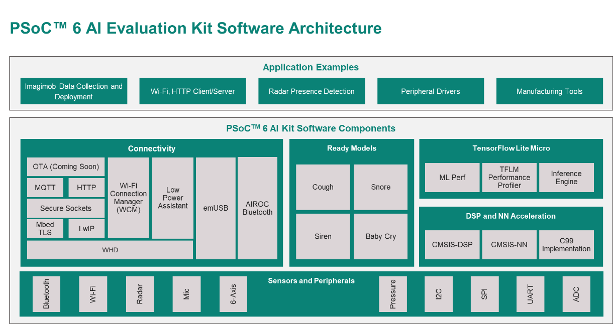

The most unique aspect of this board is its software support as it comes with ready-to-use machine learning models which makes it easy to develop Edge AI applications around it, also it has support for ModusToolbox, Infineon’s software tool for embedded development and we have seen it used in the PSoC 64 IoT Security Workshop Development Kit. The board also supports the Imagimob Studio platform with which you can create machine-learning models and use them on small devices.

  • MCU: PSoC 62S2 (Arm Cortex-M4F and Cortex-M0+, up to 1MB Flash, 288KB SRAM)
  • Wireless: Murata LBEE5KL1YN-814 (Wi-Fi 4, Bluetooth 5.2)
  • Sensors:
    • XENSIV 60GHz radar (presence, counting, tracking, gesture, motion)
    • XENSIV MEMS microphone (sound detection)
    • DSP368 barometric pressure
    • BMI270 IMU (inertial measurement unit)
    • PDM-PCM interface (additional microphones)
  • Interfaces:
    • USB Type-C (power & data)
    • 2x Pmod connectors
    • 5x CapSense buttons, 2x CapSense sliders
    • Arduino Uno R3 shield headers
  • Security:
    • Hardware-based Root of Trust (RoT)
    • Cryptographic accelerators
    • Secured onboarding, boot, key storage, firmware updates
    • Trusted FW-M security services
  • Debugging: KitProg3 onboard debugger/programmer
The Infineon CY8CKIT-062S2-AI Dev Kit also supports TensorFlow Lite Micro and neural network acceleration via CMSIS-DSP and CMSIS-NN libraries. This, combined with MQTT, HTTP, and AIROC Bluetooth connectivity, facilitates rapid prototyping and AI application development. The kit is available for purchase at $37.50 on Mouser Electronics and $50 on DigiKey.
