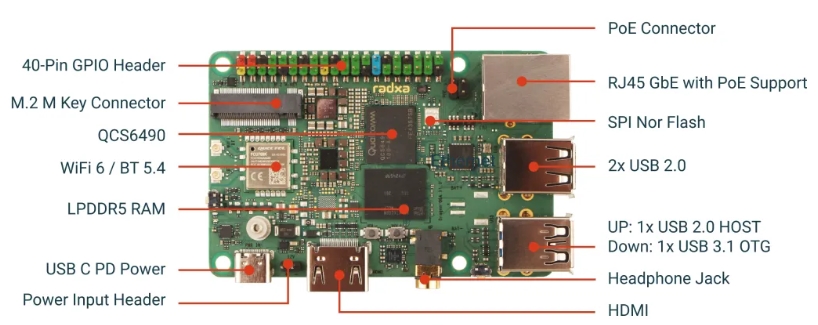

Radxa has unveiled the upcoming Raspberry Pi-style single-board computer (SBC) to meet the demands of on-device Machine Learning and Artificial Intelligence (ML and AI) workloads. Powered by a Qualcomm QCS6490 octa-core Kyro 670 SoC, the Radxa Dragon Q6A is a credit card-sized development board designed for industrial IoT, Edge Intelligence, and smart terminal scenarios. With four Cortex-A78 cores and four Cortex-A55 cores, the SoC also offers an Adreno 634L graphics processor, an Adreno 633 vision processor, a Spectra image signal processor, a Hexagon digital signal processor, and a “Qualcomm AI Engine” developing 12 TOPS AI NPU.
The board also features up to 16GB LPDDR5 memory, an M.2 Key-M socket for SSD storage, a Wi-Fi 6 and Bluetooth 5.4 wireless module, a MicroSDXC card reader, a connector for an eMMC or UFS flash module, and a 40-pin Raspberry Pi-compatible general-purpose input/output (GPIO) header.

Radxa Dragon Q6A Edge AI SBC specification 1
The Radxa Dragon Q6A SBC is intended to be a small Swiss army knife for industrial and AI use. Potential applications include in Robotics, Industrial Automation, AI boxes, Smart City Manufacturing process, etc. The development board will come with support for Android and various Linux variants.
