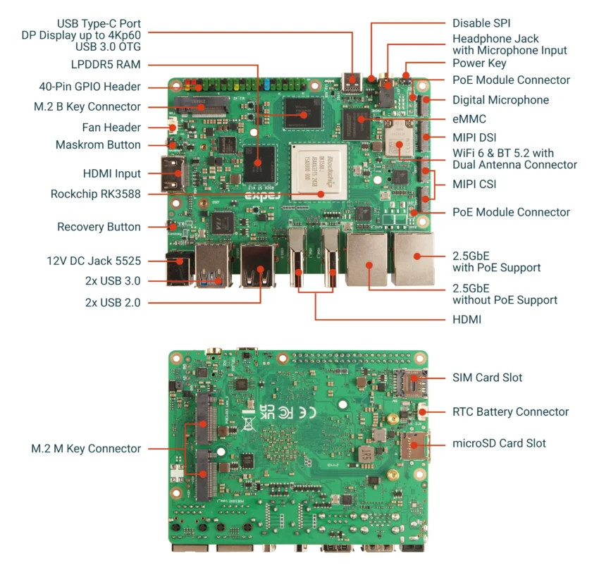

With the goal of reducing the form factor but bringing all the features and interfaces of a mini-ITX board, Radxa has launched the ROCK 5T single-board computer. This compact industrial-grade single-board computer is designed for 8K multimedia applications and high-performance computing in a smaller footprint than its predecessor.
Built around the Rockchip RK3588(J) system-on-chip, the ROCK 5T delivers robust processing power and secure connectivity options for edge computing, AI workloads, and embedded systems. Inside, the Rockchip RK3588(J) is an octa-core processor, featuring four Arm Cortex-A76 and four Cortex-A55 cores. This configuration ensures efficient multitasking and seamless handling of demanding workloads such as handling 8K video decoding and encoding.

On the hardware front, Radxa has made certain that developers have the flexibility to expand and interface with various peripherals. The ROCK 5T has multiple interfaces, including USB 3.0 ports, Gigabit Ethernet, and optional Wi-Fi and Bluetooth modules for connectivity. Its dual-display support, supported by HDMI and USB Type-C display output, makes it easy to integrate into multi-screen or industrial setups.
The board has impressive connectivity options, including dual HDMI ports, multiple USB ports (including USB 3.0), and a Gigabit Ethernet port. This comprehensive connectivity allows for integration with various peripherals and network environments. Moreover, the inclusion of PCIe slots opens up possibilities for expansion, enabling users to add specialized hardware tailored to their specific needs.
