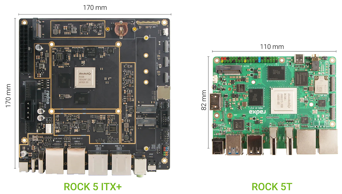

The ROCK 5T is much like the ROCK 5B+, but it has an extra 2.5GbE port, uses a separate PoE module instead of a HAT, and runs on a 12V DC power jack instead of USB-C. However, it won’t fit ROCK 5B/5B+ cases since it’s a bit larger.
The ROCK 5T comes in both commercial and industrial temperature grades, unlike the ROCK 5 ITX, which is only for commercial use. Some features from the mini-ITX board are removed, like the 24-pin ATX connector, front panel header, four SATA ports, two USB 3.1 ports, and the M.2 Key-E slot. Instead, it has built-in WiFi 6/6E, Bluetooth 5.x, a 2-pin RTC battery connector, a 24GB RAM option, a 40-pin GPIO header for Raspberry Pi HATs, and an M.2 Key-B slot with a Nano SIM for cellular use.
