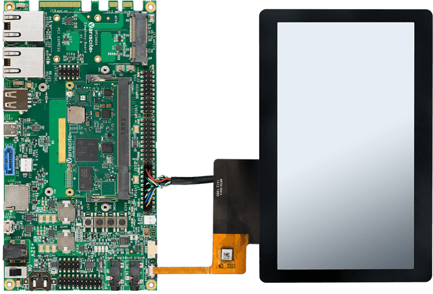

Variscite VAR-SOM-AM62P SoM Evaluation Kit
The module has several key features, including support for dual-display and 3D graphics acceleration, as well as a comprehensive array of peripherals. This makes it an ideal building block for integration into a diverse range of products in markets that demand high performance, low power consumption, and a compact form factor.
Variscite provides the Symphony board as the designated evaluation board, which serves as the carrier board for the SoM. To facilitate development, the company offers a complete kit that includes the Symphony board, VAR-SOM-AM62P SoM, display, and touch components, along with necessary accessories and cables. Regarding operating systems, the module is compatible with both Linux BSP and Android.
