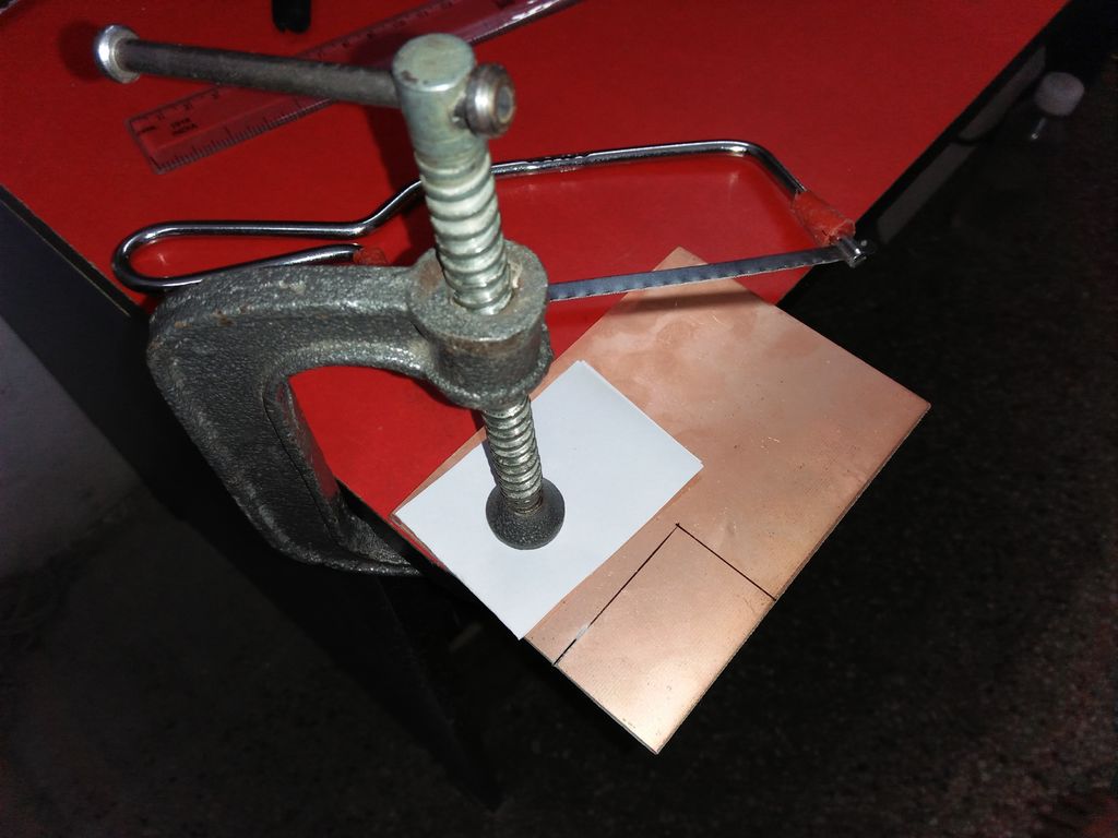

Cut The Copper Clad Board:
Now, cut the copper clad board according to the dimensions of the PCB. You can use a hacksaw to cut it off. Be precise about the dimensions. If it’s smaller than the actual PCB then you have to do it again. Also, cut the printed glossy paper as per the size of PCB.

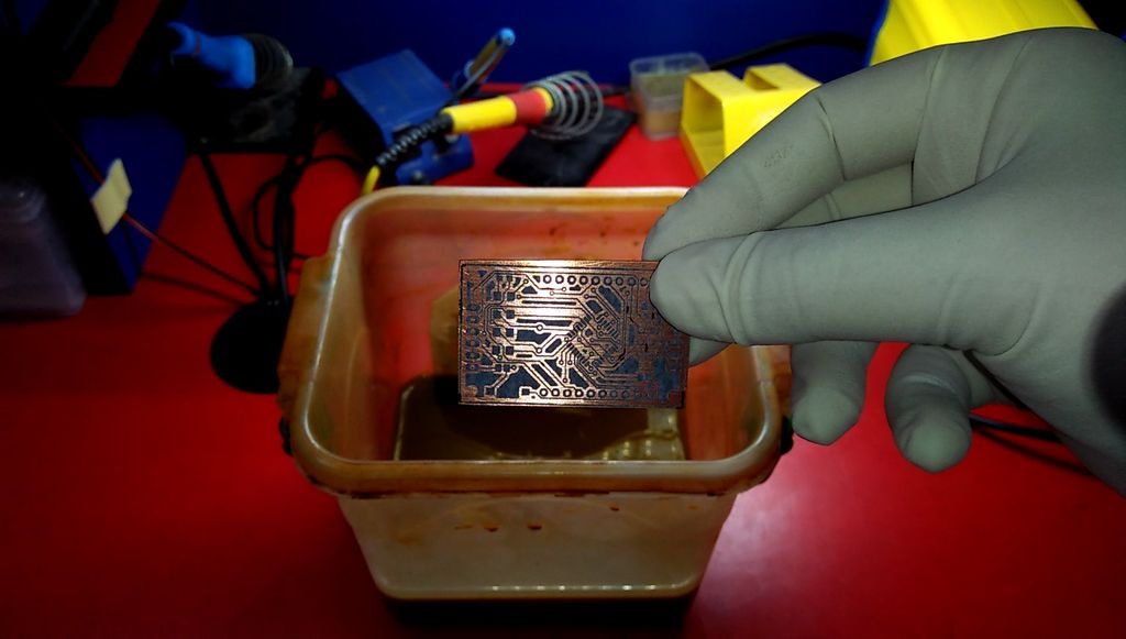

Toner Transfer and Etching Process:
In this step, the PCB design from glossy paper will be transferred to the copper board. All you need to do is place the printed side of the glossy paper on the copper board and apply both pressure and heat. You can use a modified laminator machine or an iron for this purpose. Why “modified”? Because toner transfer method requires a temperature of 210°C, where a laminator can provide 150°C maximum.
Put the board in FeCl3 solution for a while
Make your copper clad board as clean as possible beforehand. You can use sandpaper and alcohol to do this. When the toner is transferred successfully, prepare the ferric chloride (FeCl3) solution. Before putting the board into the solution check carefully for any broken path. If found, draw it with a marker. After the etching process, use the acetone to clean the board.
After washing the PCB with Acetone

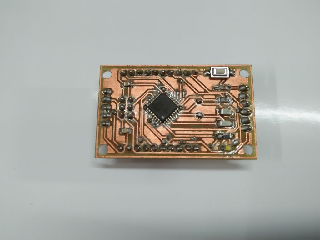

Drilling & Soldering:
Drill the PCB using PCB drill machine. Choose the drill bit wisely else components may not fit. Now, place the components on the PCB and solder them. You can use a helping hand device to get it done nicely.
Upper layer of PCB
Upper layer of PCB
Lower layer of PCB
Lower layer of PCB

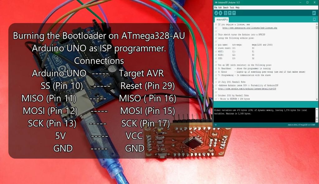

Burning The Arduino Bootloader:
In this step, you’ll need another Arduino board (e.g. Arduino UNO) to burn the bootloader to your newly made Arduino Nano for the first time. Open Arduino IDE and upload the ArduinoISP sketch to the Arduino UNO from examples option. Now, connect your Arduino Nano with Arduino UNO over SPI bus following the given instructions:
  • Arduino UNO     >>    Arduino Nano
  • SS (Pin 10)         >>     RESET (Pin 29)
  • MISO (Pin 11)    >>     MISO (Pin 16)
  • MOSI (Pin 12)    >>    MOSI (Pin 15)
  • SCK (Pin 13)       >>    SCK (Pin 17)
  • 5V                         >>    VCC
  • GND                    >>    GND
Follow this instruction to burn bootloader
After making the connections, go to Arduino IDE and follow the given instructions:
  1. Select Tool  >>  Board  >>  Arduino Nano
  2. Select Tool  >>  Port  >>  Select your Arduino UNO COM Port
  3. Select Tool  >>  Programmer  >>  Arduino as ISP
  4. Select Tool  >>  Burn Bootloader
Wait for the “Done burning bootloader” message to appear.
