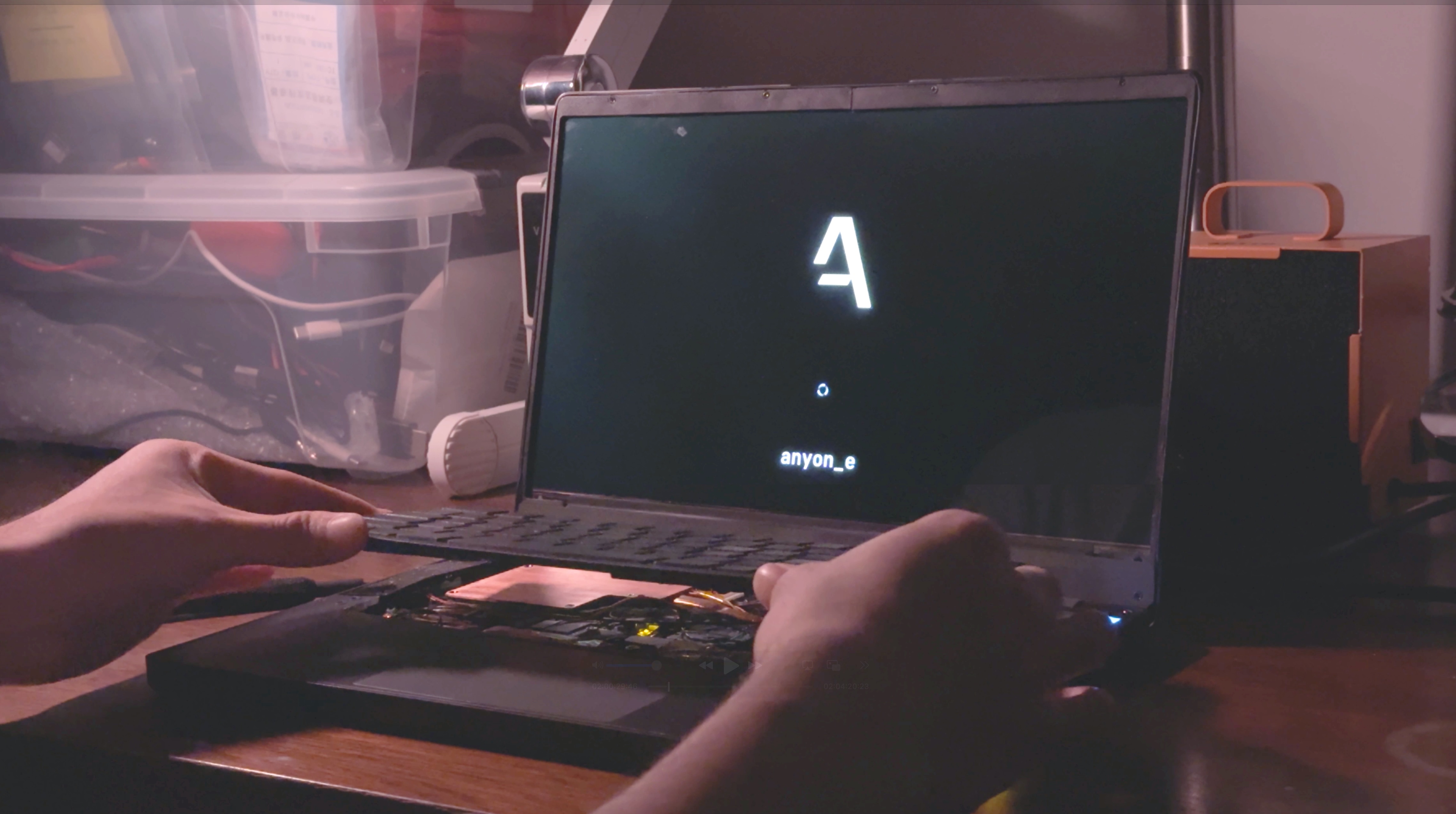

The anyon_e DIY is a custom Linux-capable laptop designed by Bryan Huang and built around the FriendlyELEC CM3588 core board. This core board features the Rockchip RK3588, a high-performance ARM-based processor commonly used in edge computing, NAS systems, and multimedia applications. The laptop integrates this processor module with a custom-designed mainboard to support external components and I/O.

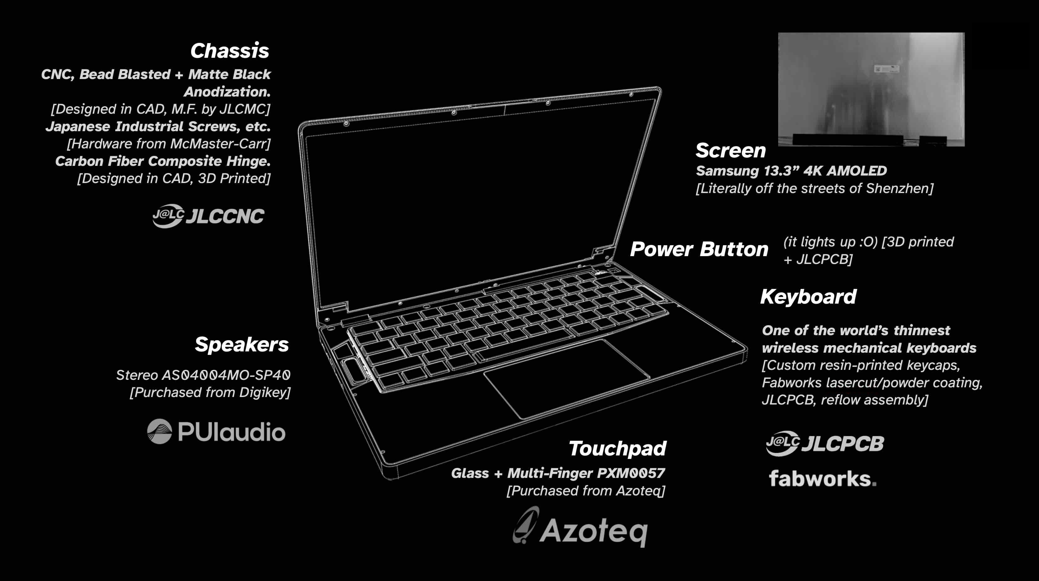

It features a 13.3-inch 4K AMOLED display, a wireless QWERTY mechanical keyboard, and a CNC-machined aluminum chassis with a thickness of just 18mm. The internal layout is optimized for compactness while maintaining support for a wide range of interfaces provided by the CM3588 module.
Power is supplied by a battery capable of delivering around 7 hours of runtime, making it suitable for general computing tasks, media playback, and light gaming. The laptop combines off-the-shelf parts like the processor module and display with fully custom mechanical and electrical design, offering a compact ARM-based platform for development and portable use.

  • Display: 13.3-inch Samsung 4K AMOLED display (330 PPI)
  • Audio: Realtek ALC5616 audio codec with stereo speakers
  • Networking: Realtek RTL8125BG 2.5GbE controller
  • USB:
    • 1x USB-C (USB 3.1 Gen 1 with DisplayPort + PD)
    • 1x USB-C (dedicated PD input)
  • Keyboard: Wireless mechanical keyboard with Cherry ULP switches based on Nordic Semi nRF52840 Bluetooth SoC
  • Touchpad: Azoteq Windows 11-certified trackpad
  • Embedded controller: Raspberry Pi RP2040 MCU (optional, for system control or monitoring)
