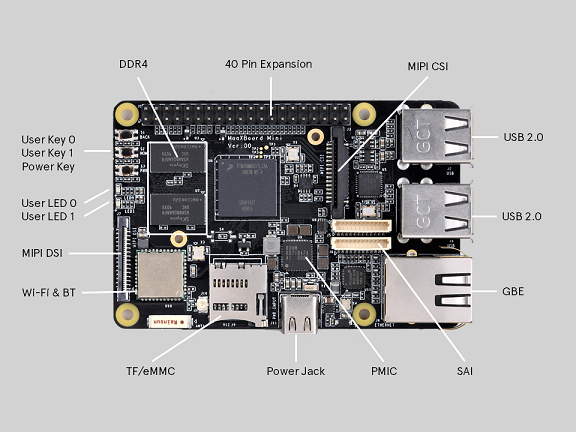

MaaXBoard Mini is a single board computer based on the NXP IMX8M Mini SOC series, designed by Avnet Manufacturing services. From the outside, it comes at a compact size with some interesting peripheral interface options, such as Gigabit Ethernet, USB 2.0 host, MiPi-DSI, MIPI-CSI, Micro SD card, Wi-Fi, Bluteooth and GPIO. Regarding the hardware, it’s based on the NXP’s first embedded multicore applications processor, which is built using the advanced 14LPC FinFET process technology, a 14 nanometer fabrication process, providing more speed and improved power efficiency over its predecessor, the i.MX 8M. However, it comes with a more limited feature set than the earlier-released MaaXBoard, where the MIPI-DSI is preffered over HDMI, leaving you with a smaller resolution of 1080p at 60fps instead of the 4K 60fps, paired with a different GPU, the 4GB DDR4 is downgraded for a mere 2GB, are some of the most noticeable changes.
The full list of specs are:
  • CPU Multicore Processing:
    • 4x Cortex-A53 core up to 1.8GHz per core (32KB L1-I Cache / 32 kB L1-D Cache / 512 kB L2 Cache)
    • 1x Cortex-M4 core up to 400MHz (16 kB L1-I Cache / 16 kB L2-D Cache)
  • 3D GPU (1x shader, OpenGL® ES 2.0) / 2D GPU
  • 40 Pin IO Interface (Expands I2C, SPI, UART, I2S Interfaces)
  • MIPI-CSI Camera Interface
  • MIPI-DSI Display Interface
  • Gigabit Ethernet interface (RJ45)
  • 4 USB2.0 Host ports
  • Micro SD Card (TF Card) Interface
  • 1 × 8bits and 1x 7bits GPIO Interface (Support Audio peripheral expand)
  • USB Type C power connector (5V / 3A)
  • 1 × Power Button, 2 × User Button, 2 × User LED
  • Wi-Fi + Bluetooth 4.2
