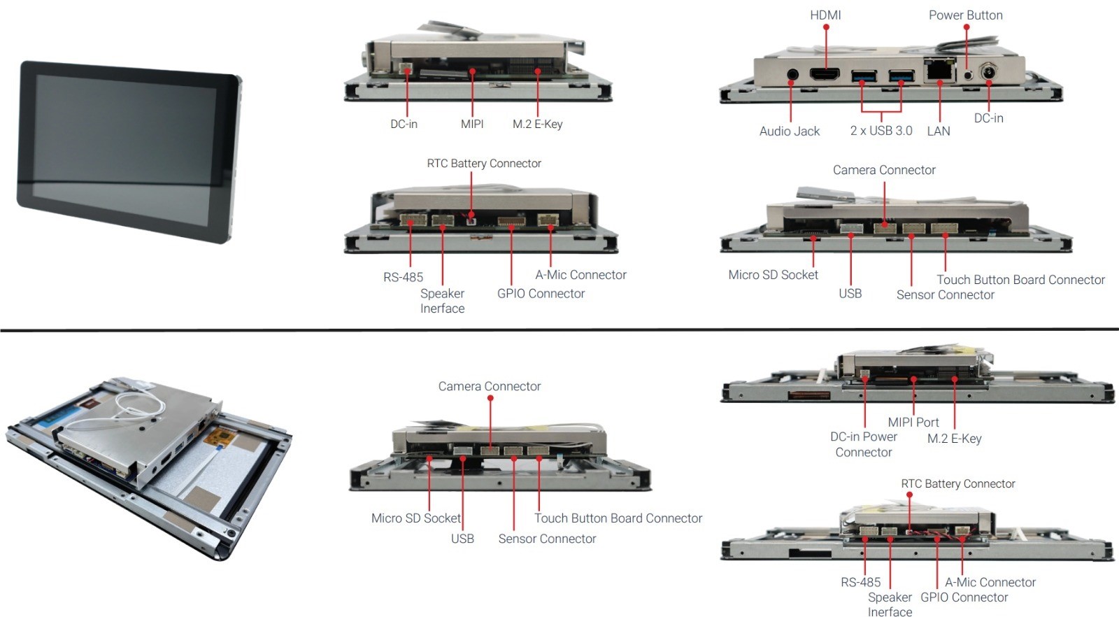

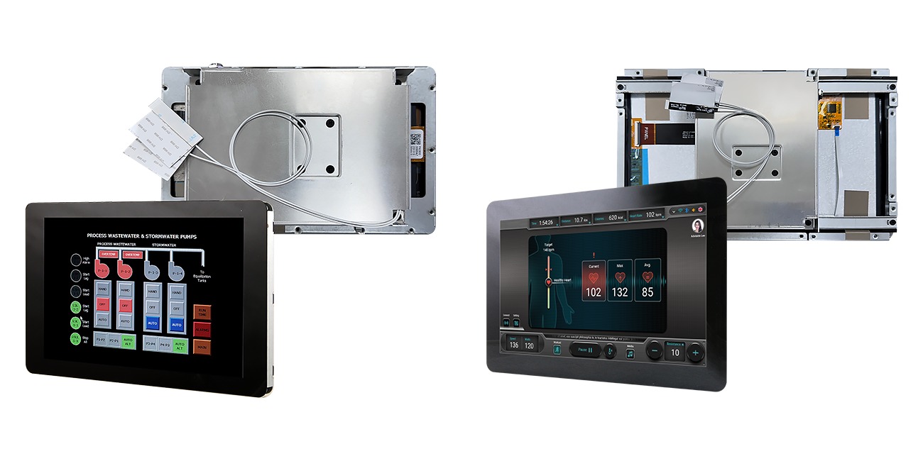

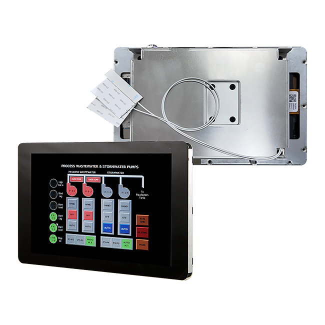

BCM’s OFT07W-ADLN and OFT10W-ADLN are open-frame touch panel PCs designed for embedded HMI applications. These fanless systems integrate the Intel Processor N50 (dual-core, up to 3.40 GHz, 6M cache) and include 8GB LPDDR5 memory and 64GB eMMC storage. They are equipped with a 7-inch (800×1280) LCD or 10.1-inch (1200×1920) LCD with PCAP touch and are built into a mountable steel frame with CAD drawings for easy integration.
The systems support flexible connectivity with USB 3.0 ports, Gigabit LAN, RS-485/RS-232, and an M.2 E-key slot for Wi-Fi/Bluetooth expansion. An HDMI 2.0A output enables dual-display functionality. The devices operate on a 12-24V DC input and feature a fanless design for reliable deployment in controlled environments. These panel PCs are suited for HMI interfaces, kiosks, self-service terminals, and industrial applications.
OFT07W-ADLN (left) and OFT10W-ADLN (right)

OFT07W-ADLN and OFT10W-ADLN specifications
OFT07W-ADLN (top) and OFT10W-ADLN (bottom)
