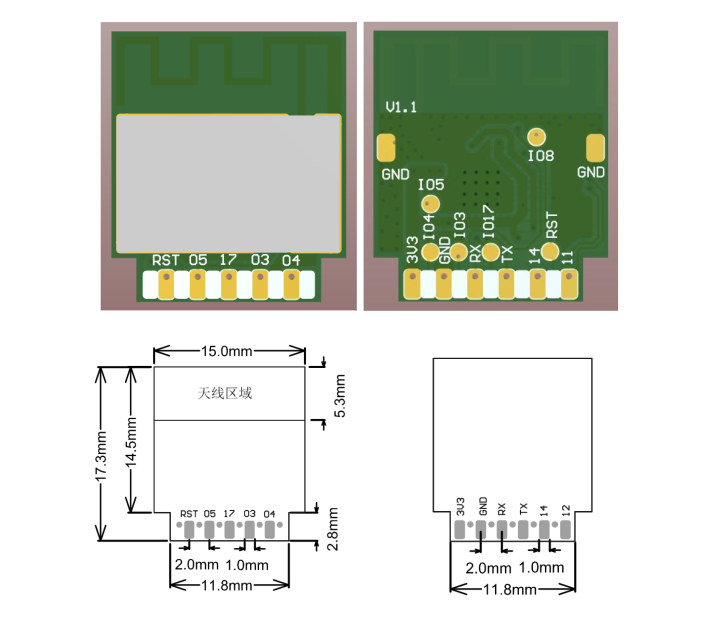

BL-63B IoT Module
Several boards have been built around this BL602 microcontroller like the DT-BL10 development board, the PineCone BL602 board, and the new BL-63B – a more compact module that offers many possibilities at a more favorable price.
The BL-63B is a highly integrated single-chip low-power 802.11n wireless local area network (WLAN) network controller. It has a low power consumption rate with high performance and support for various safety functions. The 17.3 mm x 15 mm x 3mm module also features a number of configurable general purpose IOs, which are configured as digital peripherals for different applications and control purposes.

  • Microcontroller: Bouffalo Labs BL602 32-bit RISC-V processor running at up to 192 Mhz, with:
    • 276KB RAM
    • 128KB ROM
    • 1 Kbit eFuse,
    • Embedded flash (optional)
    • 4x DMA channels, and,
    • Wireless subsystem that contains 2.4G radio, Wi-Fi 802.11b/g/n and Bluetooth Low Energy 5.0 baseband / MAC designs
  • 2MB flash
  • 2.4GHz 802.11b/g/n WiFI 4 1×1 SISO up to 65 Mbps (802.11n) or 26 Mbps (802.11g)
  • Bluetooth Low Energy (BLE) 5.0
  • PCB antenna
  • Up to 5x General Purpose IO (GPIO), UART, ADC, DAC, PWM, I2C, SPI, IR, Reset, 3.3V and GND
  • 2x additional test pads for GND, IO8 and IO5
  • Power supply:  3.0 to 3.6V
  • Dimensions: 17.3 mm x 15 mm x 3mm
  • Operating Temperature Range: -30°C to +85°C
  • FCC ID: 2AVTT-BL63B
