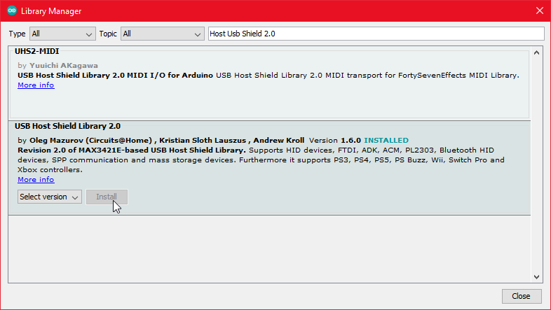

4.2 Downloading the USB Host Shield Library 2.0
Either download the Library from Here (https://felis.github.io/USB_Host_Shield_2.0/) and place the folder into your libraries folder inside your Arduino folder. (For information on installing libraries, see: http://www.arduino.cc/en/Guide/Libraries)
Or download it through the Arduino IDE:
In Arduino IDE choose Sketch>Include Library>Manage Library
Search for USB Host Shield Library 2.0 and click ‘Install’

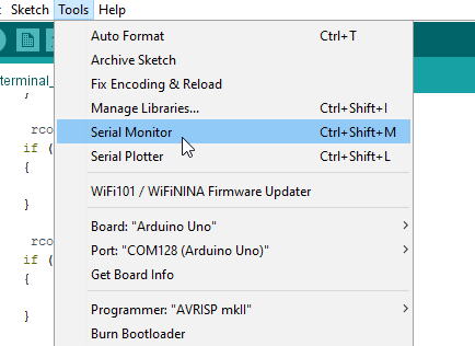

Flow Control: None
Or inside the Arduino IDE open up Arduino Monitor and in the bottom right corner select ‘Carriage Return’ and ‘115200 baud’

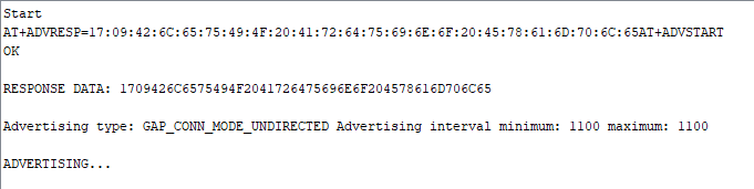

You should see the word ‘Start’ and then see the dongle running two commands: setting response data and starting the advertising. You can now type commands to the dongle.
