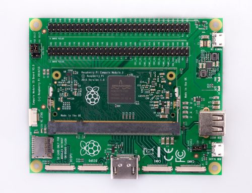

Raspberry Pi also released an updated version of the Compute Module IO Board V3 (CMIO3). This board provides the necessary power to the module and gives you the ability to program the module’s flash memory or use an SD card for the lite version, to access the processor interfaces through pin headers and flexi connectors. In addition, it provides the necessary HDMI and USB connectors.
This board provides both a starting template for those who want to design with the Compute Module and a quick way to start experimenting with the hardware, and building and testing a system, before going to the expense of fabricating a custom board. The CMIO3 can accept an original Compute Module, CM3, or CM3L.
