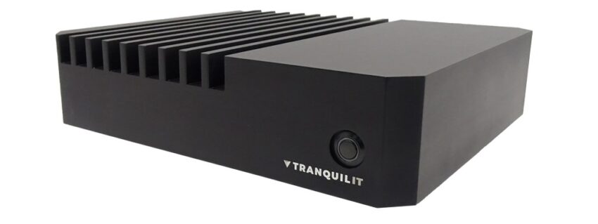

The AMD Ryzen V2000 Embedded PC delivers enhanced performance and power efficiency for edge computing and automotive applications. Built on the “Zen 2” x86 core architecture, it features 6 cores and 12 threads with a 7nm process technology. The integration of optimized Radeon graphics in a System-on-Chip (SoC) design makes it well-suited for high-performance, graphics-intensive tasks.
The Fanless Mini AMD Ryzen V2000 embedded system combines a quad-core processor with a fanless design for silent operation. It supports 4x4K display outputs, powered by AMD Radeon graphics, enabling multi-display support and delivering immersive visuals. With an IP51 rating, it is durable enough for challenging environments, making it ideal for applications that require multitasking and robust graphical capabilities.
The AMD Ryzen Embedded V2516 processor uses the Zen 2 architecture and features 6 cores and 12 threads. Operating at a base frequency of 2.1 GHz, with a boost of up to 3.95 GHz, it includes 3 MB of L3 cache and leverages the Socket FP6 platform. This processor is designed to provide efficient performance and powerful graphics for compact systems.
AMD Ryzen V2000 Fanless Mini embedded PC

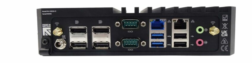

AMD Ryzen V2000 Fanless Mini embedded PC specifications:
  • Processor: AMD Ryzen Embedded V2516
    • 6 cores / 12 threads
    • Base frequency: 2.10 GHz
    • 3 MB L3 cache
  • Graphics: AMD Radeon Graphics
    • GPU frequency: 1500 MHz
    • Display Interfaces:
      • 3x DisplayPort 1.2a (3840 x 2160 @ 60Hz)
      • 1x DisplayPort 1.4 (5120 x 2880 @ 120Hz)
  • Networking:
    • Wi-Fi 6 (Intel AX201) + Bluetooth 5.2 (IEEE 802.11 b/g/n/ac/ax, 2.4GHz/5GHz)
    • 1x Realtek 2.5GbE LAN (RTL8125BG)
    • 1x Realtek 1GbE LAN (R8111EPV)
    • DASH network feature support
  • Memory:
    • 2x SO-DIMM slots (up to 64GB)
    • Dual-channel DDR4 at 3200 MHz
  • Storage:
    • 1x M.2 (Key M, 2242/2260/2280)
    • Supports SATA3 and PCIe x4 SSDs (up to 4TB)
  • USB Interfaces:
    • 2x USB 2.0
    • 2x USB 3.0
  • Audio:
    • 1x Line out
    • 1x MIC in
  • Expansion:
    • 2x COM Ports
      • 1x RS-232
      • 1x RS-232/422/485
  • Miscellaneous:
    • Dual antenna support (optional)
    • Hardware watchdog
    • Power and reset switches
    • Status LEDs (power, network uplink/activity)
    • TPM 2.0 for hardware security
  • Power Supply:
    • Input voltage: 12–28V
    • Power consumption: 12–48W
    • 2.5 x 5.5mm DC jack (screw-type)
  • Thermal Design: Passive cooling
  • Operating Conditions:
    • Operating temperature: -10°C to 50°C
    • Storage temperature: -20°C to 60°C
    • Relative humidity: 5% to 95%
  • Dimensions: 208 x 180 x 49 mm
  • Weight: 2.4 kg
  • Certifications: CE, UKCA, RoHS, FCC, WEEE
The AMD Ryzen Embedded V2516 features a 10 W TDP, supporting DDR4 dual-channel memory and PCI-Express Gen 3 for efficient performance and connectivity. It includes Radeon Graphics 384SP, making it suitable for applications needing low power and integrated graphics.
We have previously covered several fanless PCs, including the QBiX-ADNAN97-A1, MSI MS-C918S, uIBX-250-BW, MeLE QuieterDL, and MINIX NEO Z300-0dB. Feel free to explore these products if you’re interested.
The AMD Ryzen V2000 Fanless Mini embedded PC utilizes the V2516 processor, offering silent operation with passive cooling and energy efficiency. Pricing details are unavailable on Tranquilit’s website, but inquiries can be made via a form on the product page.
