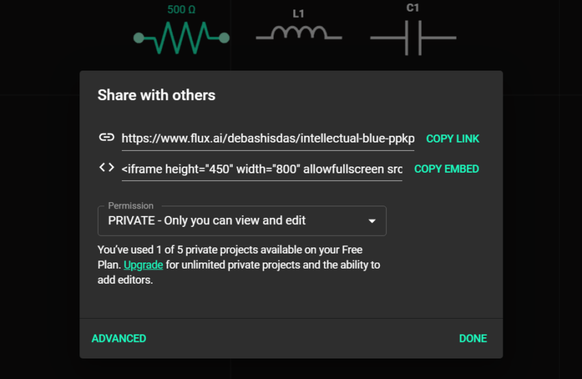

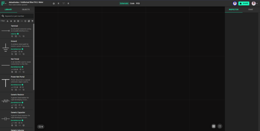

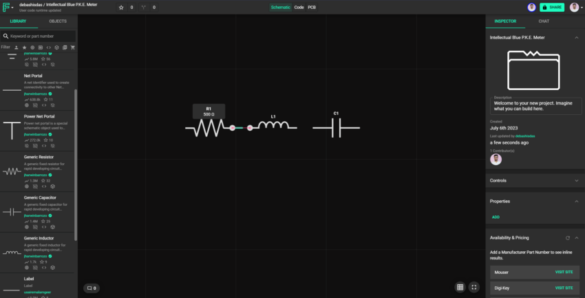

Once the sign-in process was complete, we created a new project. You will get Five Private Projects and Unlimited Public Projects on a free account. We started by creating a basic RLC series circuit in the editor. While working, the performance was fast, and dragging elements from the sidebar to the editor was a joy.
The wiring process was also very easy; to wire up one component to another, you need to click on the terminals of a component, and the wire will appear.

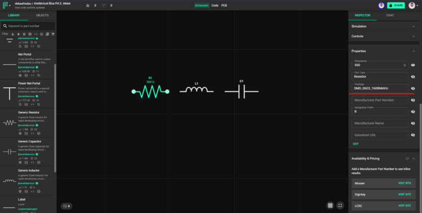

Changing a component’s properties is also very easy. If you want to use a through-hole component instead of an SMD one, select the component, and scroll down to the properties tab. You can find the package information there, click on that, and change the device’s package.
Real-time collaboration is supported, which is a big game changer for the electronics industry. No more file juggling with Dropbox or Git commits! However, we need the snap-on-grid feature, which is a big letdown for us as we use it in almost every design. That is why components can appear to have slight misalignment, and it causes confusion in wire connections.
We have also encountered additional bugs while working; dragging and connecting wires can be unintuitive, and you will need some practice before you get the hang of it. Additionally, when trying to drag an element on top of a wire, it doesn’t work as expected. Instead of replacing the wire with the component, it causes a short circuit.

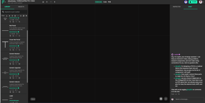

We tried the AI Copilot: An AI Assistant with Expertise in Electrical Engineering
Flux Copilot is a specially trained large language model (LLM) that you can find on the right-hand side of your screen referred to as chat. With its deep electronic and electrical knowledge, it can do various tasks.

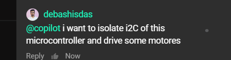

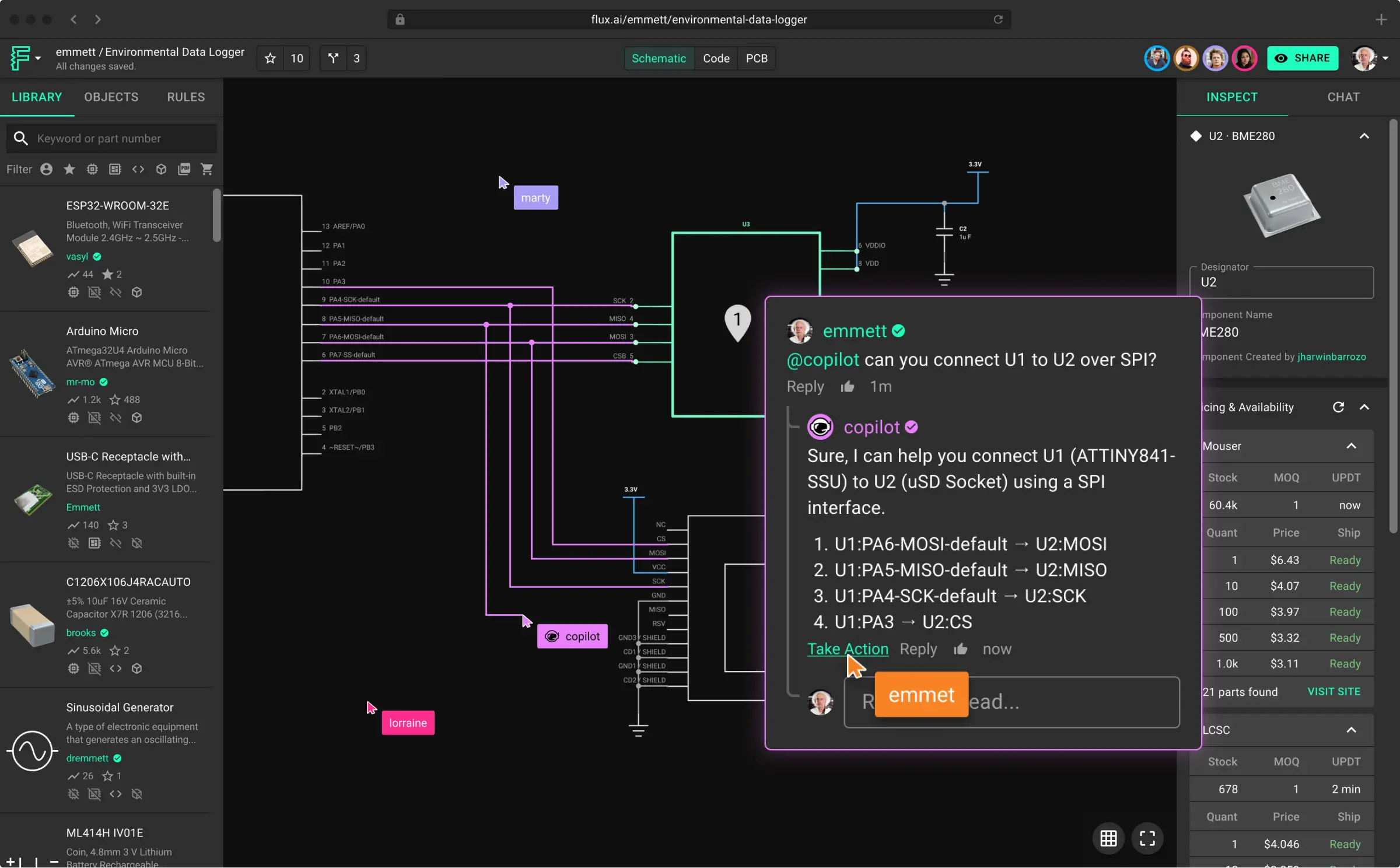

It is chatGPT for electronic projects but with a full understanding of electronic and electrical design. So we started with an actual practical problem and asked @copilot if I wanted to isolate the i2C of this microcontroller and drive some motors.
We didn’t say anything about the rest of our circuit, and we were very surprised at how good the response was,
Not only did it give us the part numbers, but it also taught us how to connect the i2c isolator to the microcontroller. What’s even more impressive is that it automatically detected the microcontroller from the editor window without us having to specify it. This level of automation was truly remarkable, to say the least.

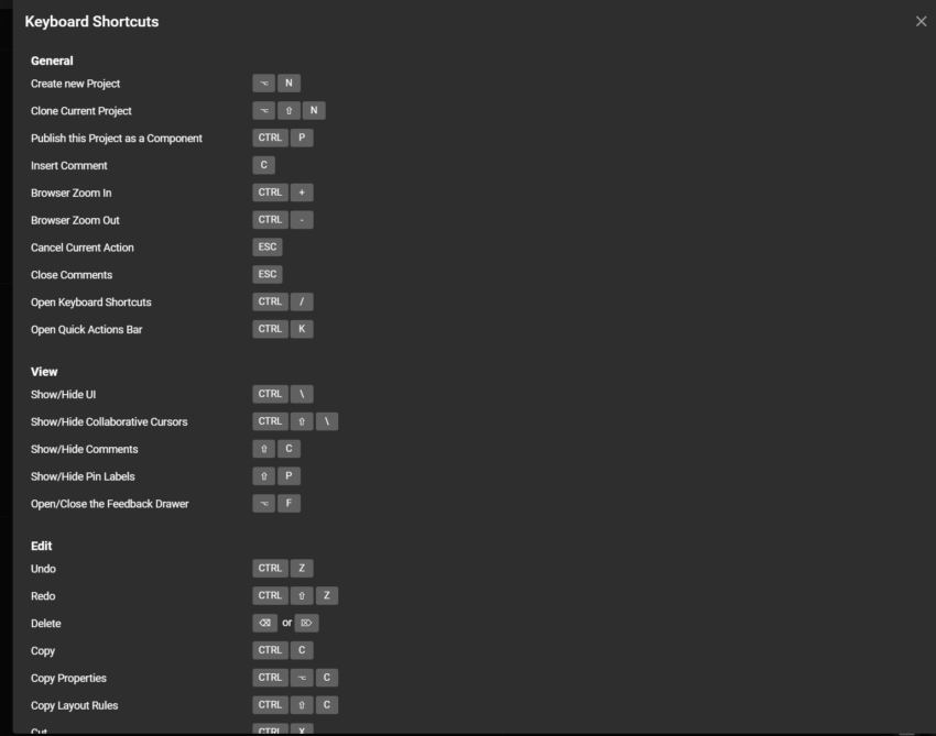

Like other EDA tools, Flux also comes packed with handy keyboard shortcuts. The most interesting part is that there is a custom assignment function in Flux with that you can assign your favorite components to the number keys 1-5 for quick access. But here’s the catch: we quickly ran into a problem because we started running out of component slots in no time.
You can access the keyboard shortcut list in Flux by pressing the Ctrl+/ key, just like you did for Google Workspace. So we spent some time experimenting to see how fast we could make our workflow.

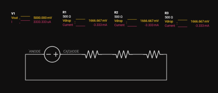

Flux has an integrated simulator, but you will not find any dedicated “Simulation” tab in the tool because it runs automatically by default.
The only requirement you need to care about is the part should have a simulation model assigned to it. That means you cannot simulate more complex parts like microcontrollers, and you are limited to simple parts like transistors, resistors, capacitor inductors, and basic ICs. If you are savvy enough, you can write your simulation model using the Fulx system’s code editor.

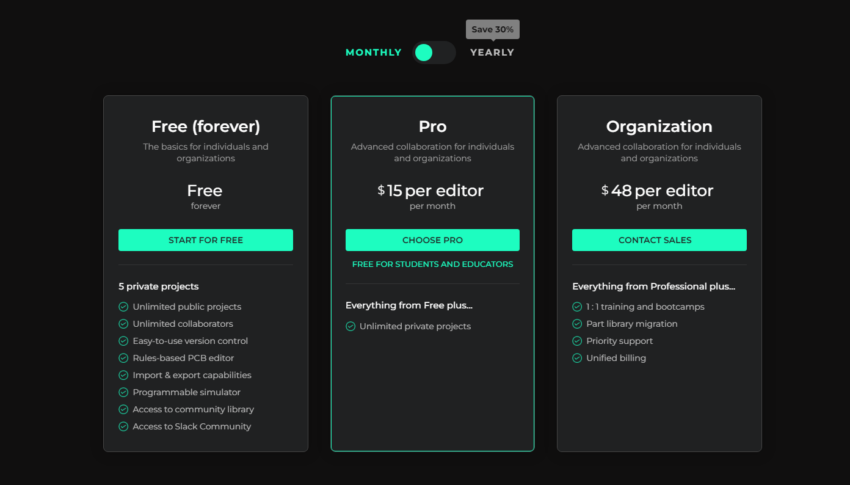

Flux.AI has a community-first approach with its pricing model. The free version of this tool provides almost all functionality for all users indefinitely.
For companies, both small and large, the ‘Pro‘ or ‘Organization‘ options are available at $15/month and $45/month respectively. These offer private projects and additional business-oriented features.
